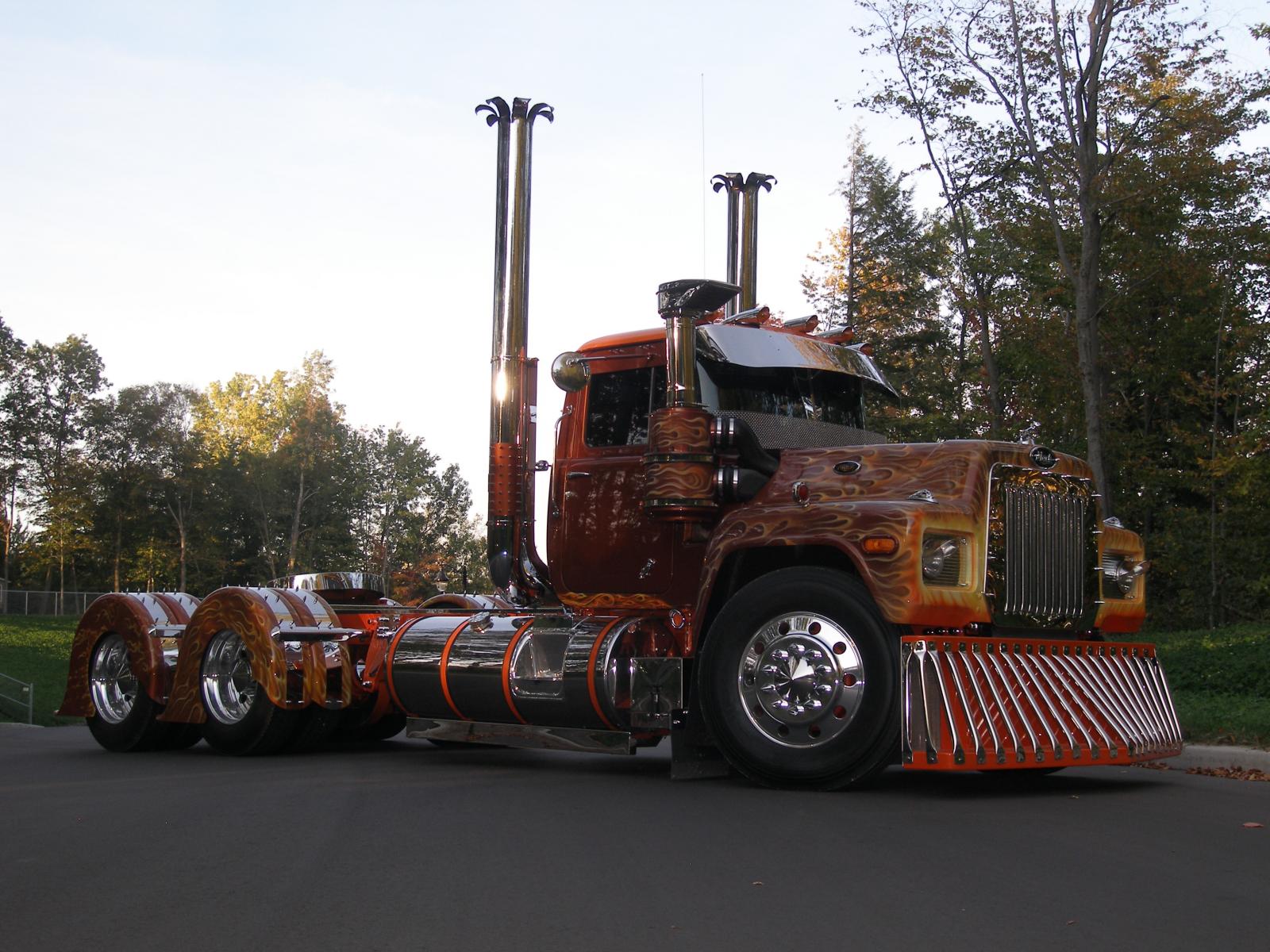

Here is one i found to get it started,
post-11750-0-23300800-1360178539_thumb.j

I marvel at the skill and craftsmanship to create this brown R locomotive but I don't like it.
Thankfully, it is not my truck or my money....
I'm with you on this one. I'll keep the exact words I said to my self and just say I dont like it.

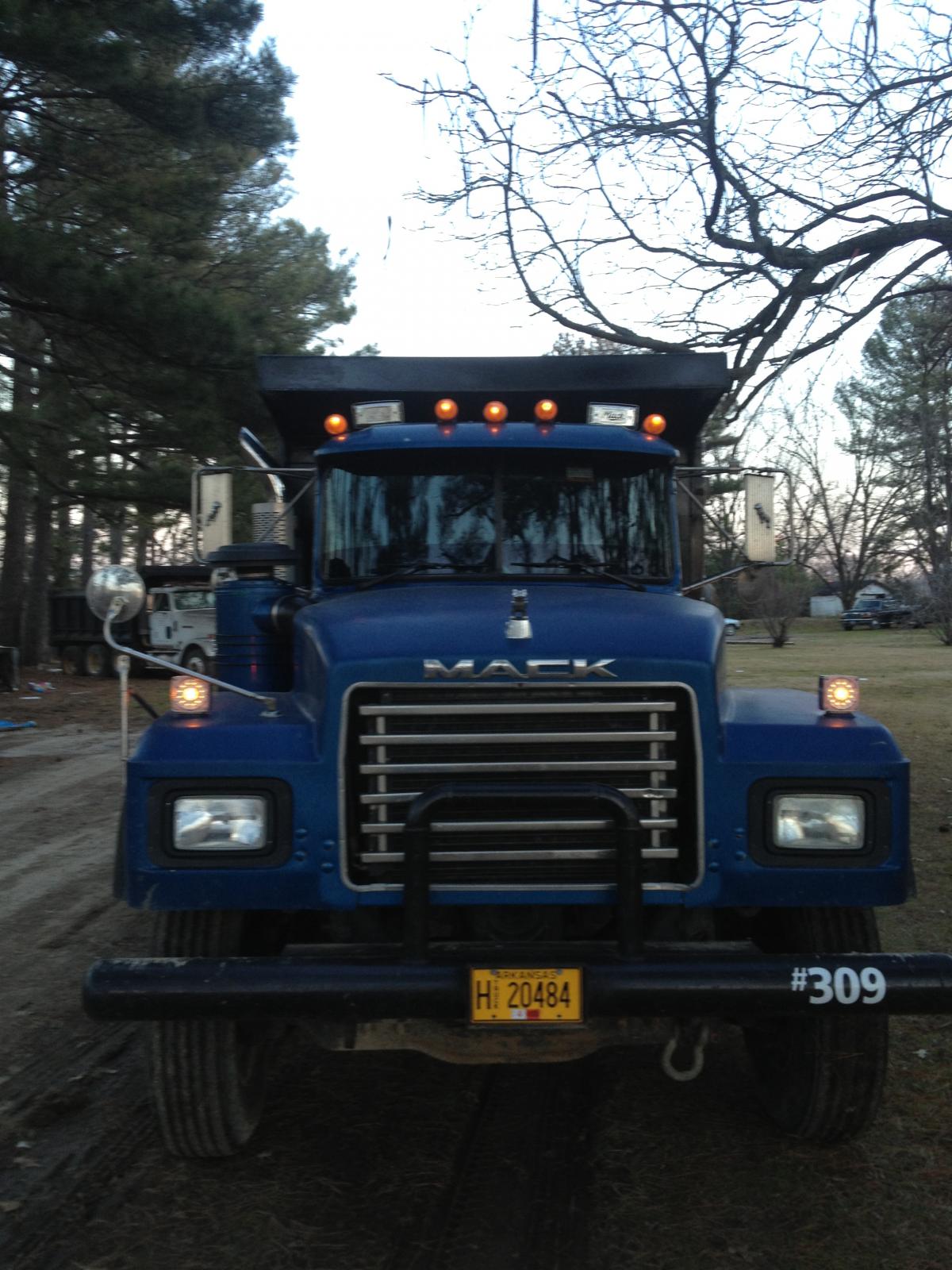

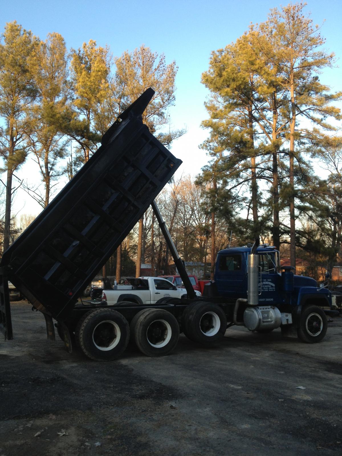

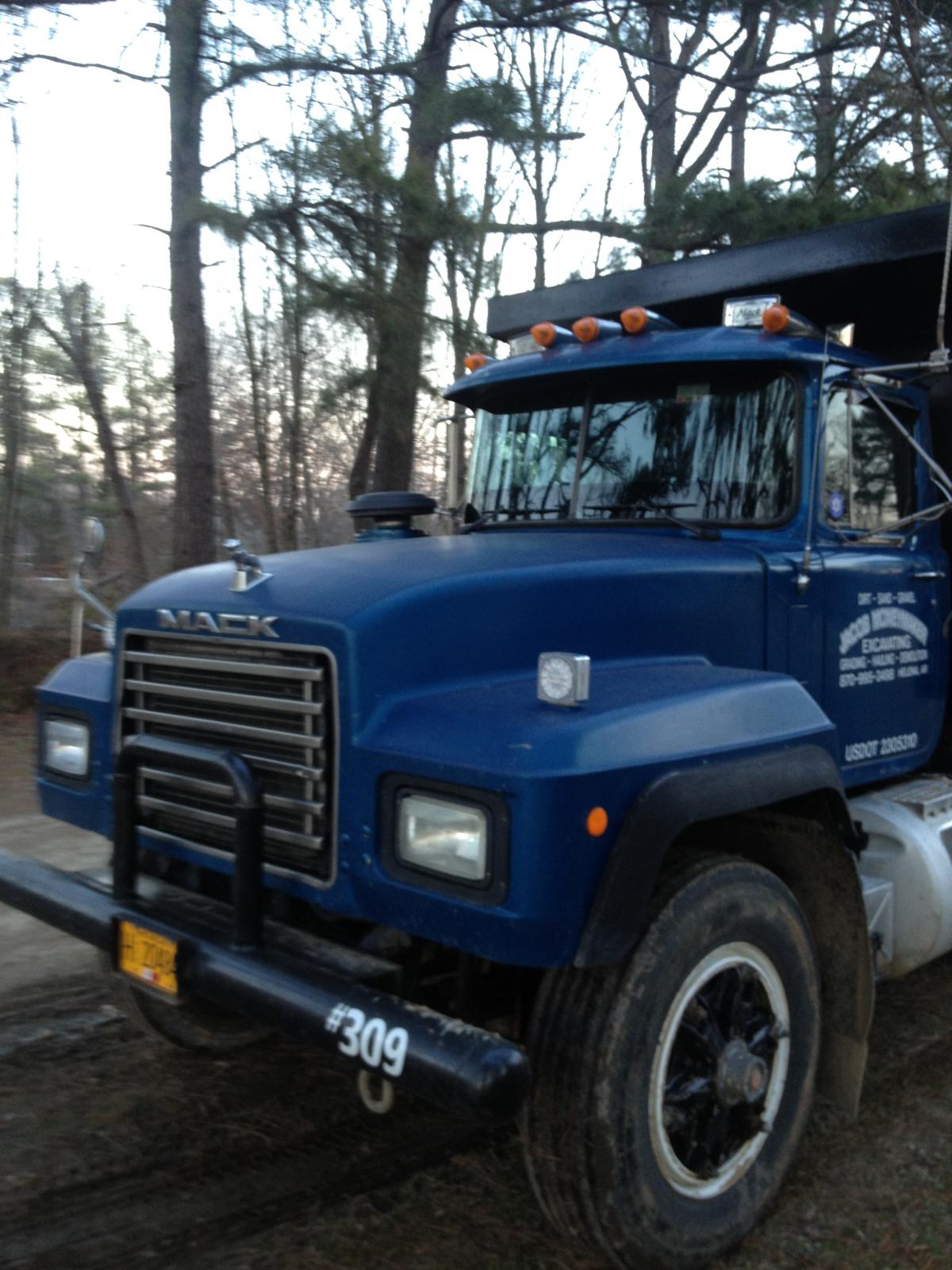

The most outrageous thing I've done is swapped out the factory bumper for a 6" oilfieild-style pipe bumper that a buddy of mine gave me off his old R model. I had to cut out the back of the bumper and weld in a new plate with holes drilled to match up to the RD mounting holes. It was all warped up on the back from pulling on it, because on an R model it covered up the factory towing pins, but my RD has towing loops made into the front spring hangers, so it works out pretty good. I keep a shackle it one loop to keep a chain from cutting into the cast iron too bad. And of course, the "Phantom 309" decal!post-560-0-33815700-1360378646_thumb.jpgpost-560-0-08381600-1360378718_thumb.jpg At one time I did away with the factory muffler and went with a 5'' straight pipe, and it sounded pretty good. Not too long after that during the first summer that I ran the truck, my A/C went out, and funding was a little low so I ran almost all summer with both windows down, and I couldn't stand it any longer. As soon as I got my bank account padded up a little bit I went back with a new compressor, lines, expansion valve, condenser, coil, dryer, control panel, and A/C control cover. I also went back with everything factory from pretty much the turbo back, but put a 5'' ''bull hauler" turnout on it.post-560-0-39924800-1360379184_thumb.jpg
