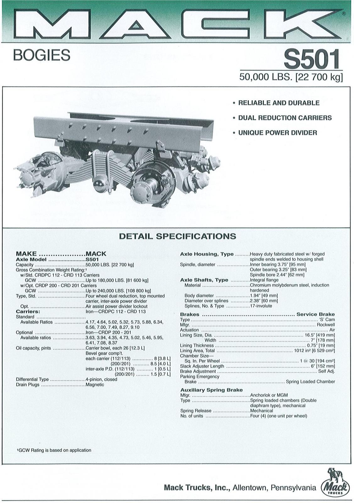

Look at them there should be a bead of weld around the whole thing right in the middle where they welded the two halfs together
