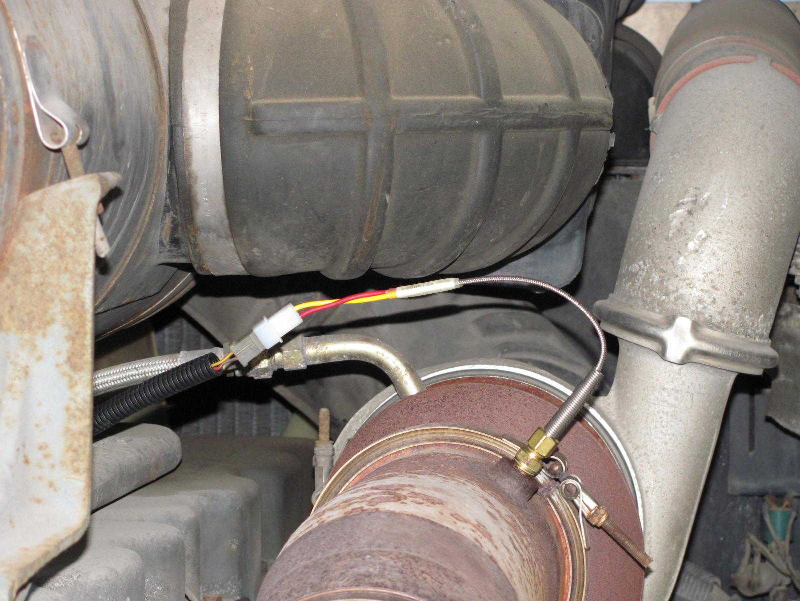

I bought a new thermocouple for the turbo, it has a short pigtail with two eye terminals...
I have about thirty pictures of E6 Engines and all of them have been "spliced" and taped directly into the wire that ruins to the gauge...
Does anyone have a photo of a factory setup with what it is supposed to tie too? It looks like it would run to a terminal block or something?!?

My MH has a similar thermocouple connector. The wire from the dash to the engine has the mating connector. If your wire is okay, buy a mating connector and put it on the end of the gauge wire at the engine.
post-3289-0-09040100-1360928967_thumb.jp
Ken

the harness looks just like the probe you screw them together
