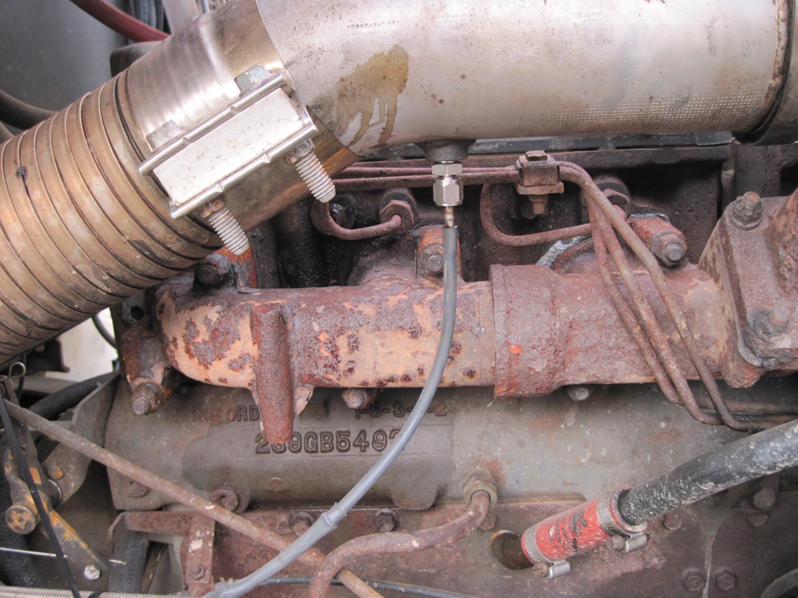

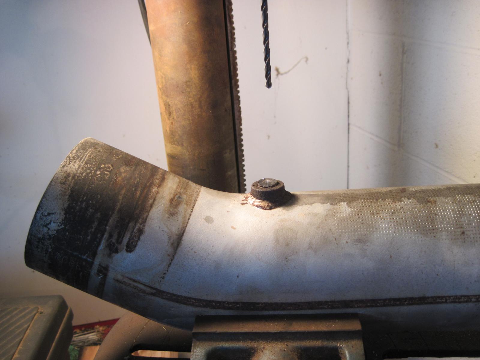

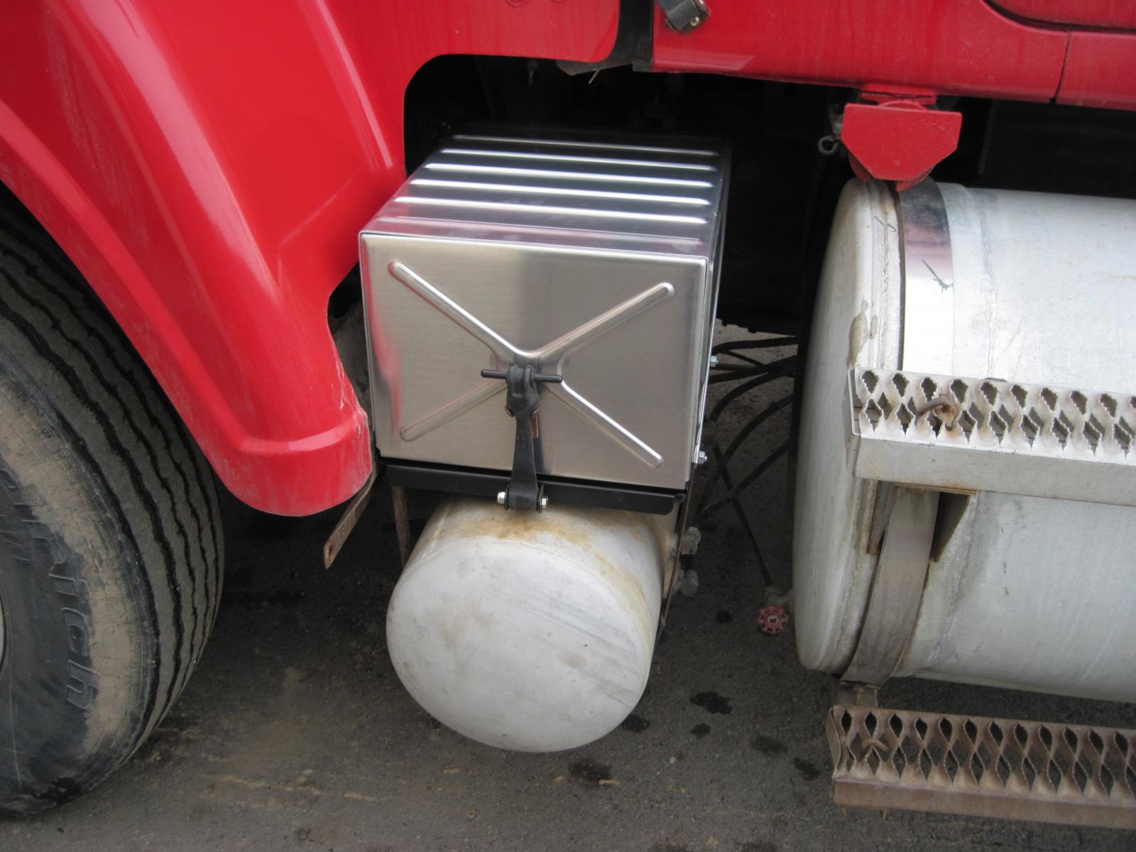

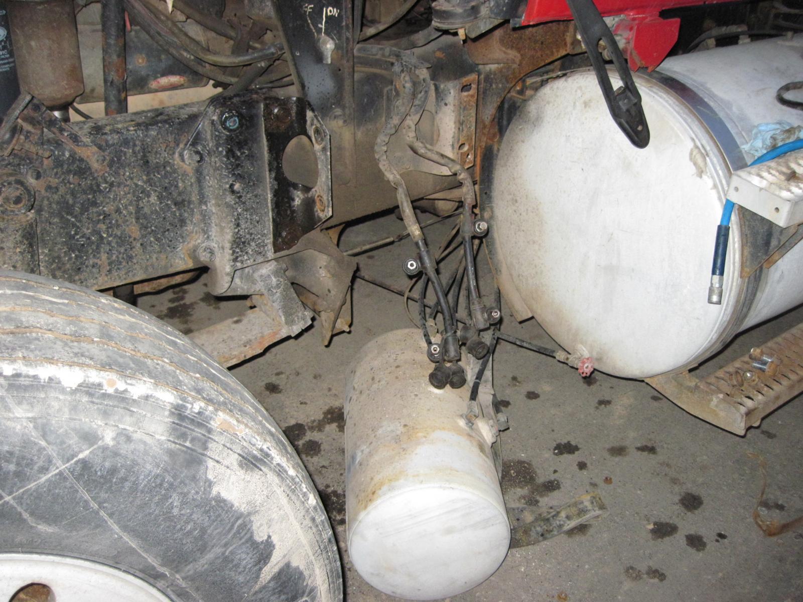

Though a little cold, the skies were clear so I changed out the drivers side battery box and replaced the pyrometer...
At some point someone put on a western style all aluminum battery box...it is two inches wider than the one that came on the truck, hard to get the lid off without scraping the fender...

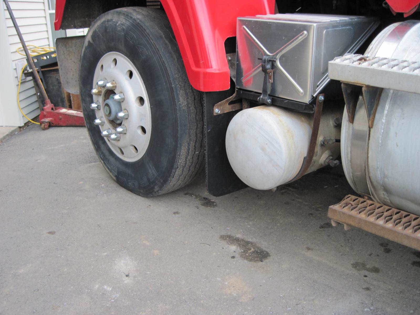

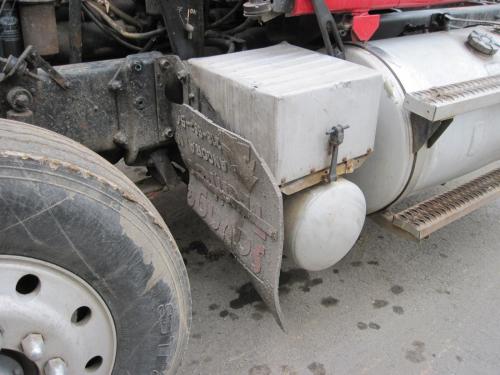

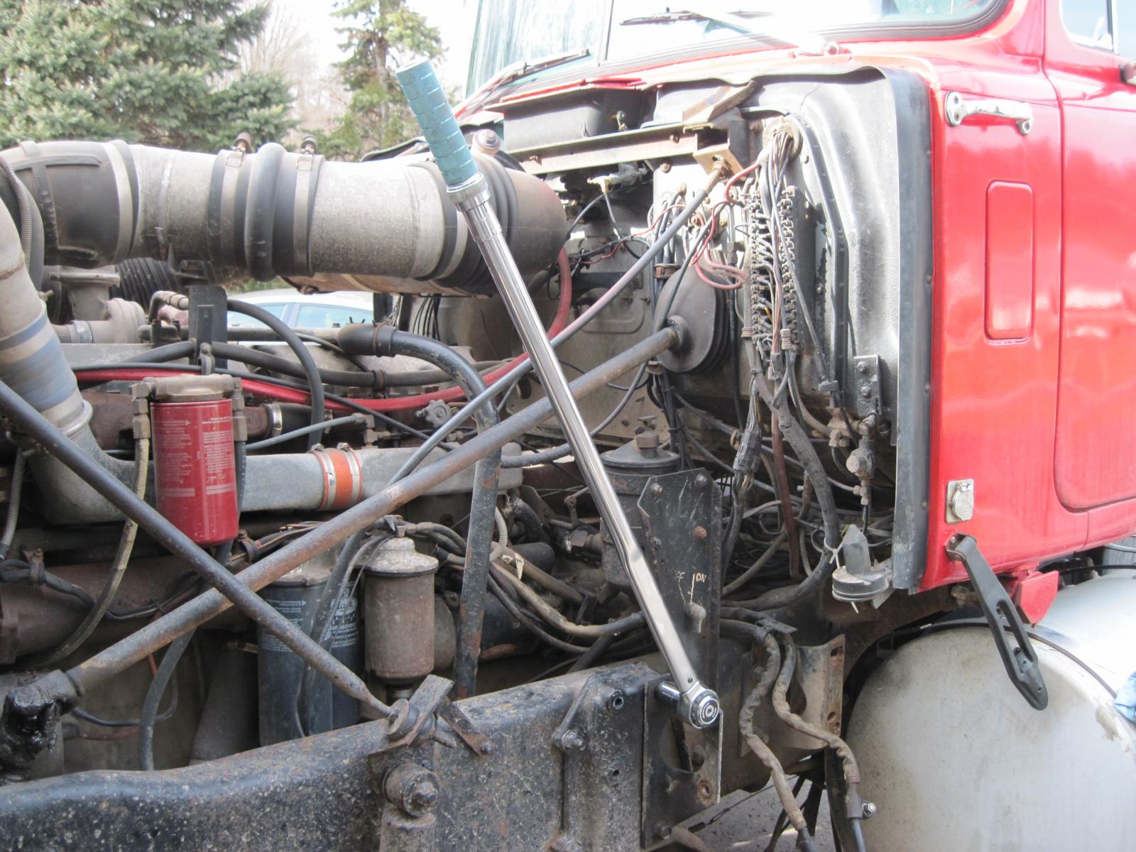

Had to move the front main mount...nothing I had would budge it...bent all my pipe breaker bars...went out to work and borrow a 48" 3/4 drive torque wrench! The bolts loosened right up!!
post-6773-0-63051200-1361072177_thumb.jp

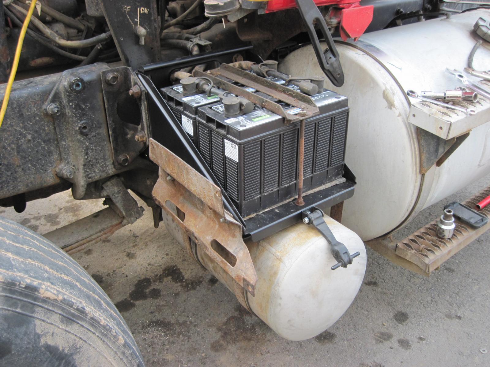

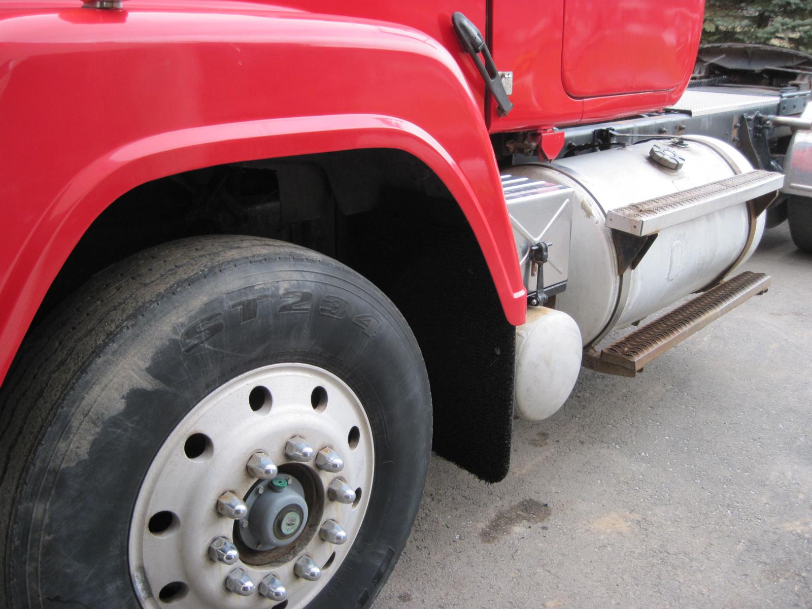

Almost finished!
post-6773-0-85639900-1361072330_thumb.jp
Looking good! Will cut out out and mount the mudflaps tomorrow...will paint the straps and mudflap mount when it warms ups...
