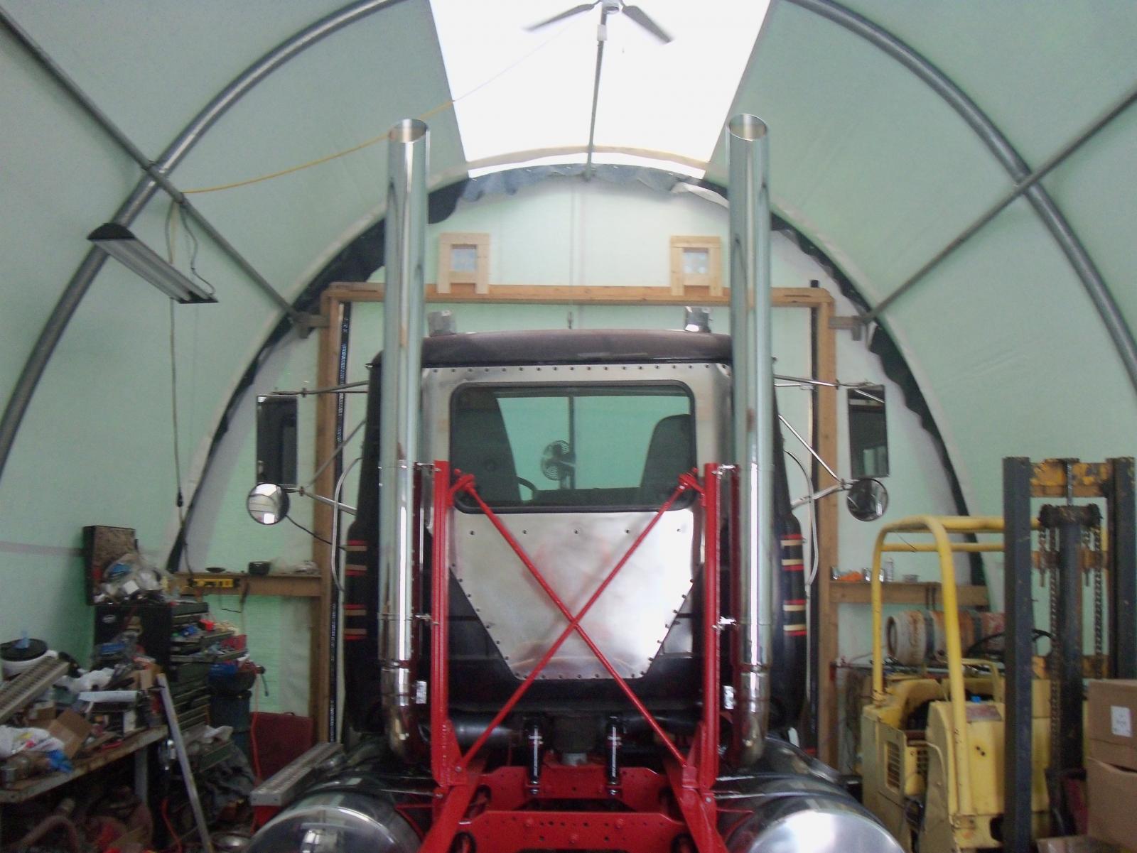

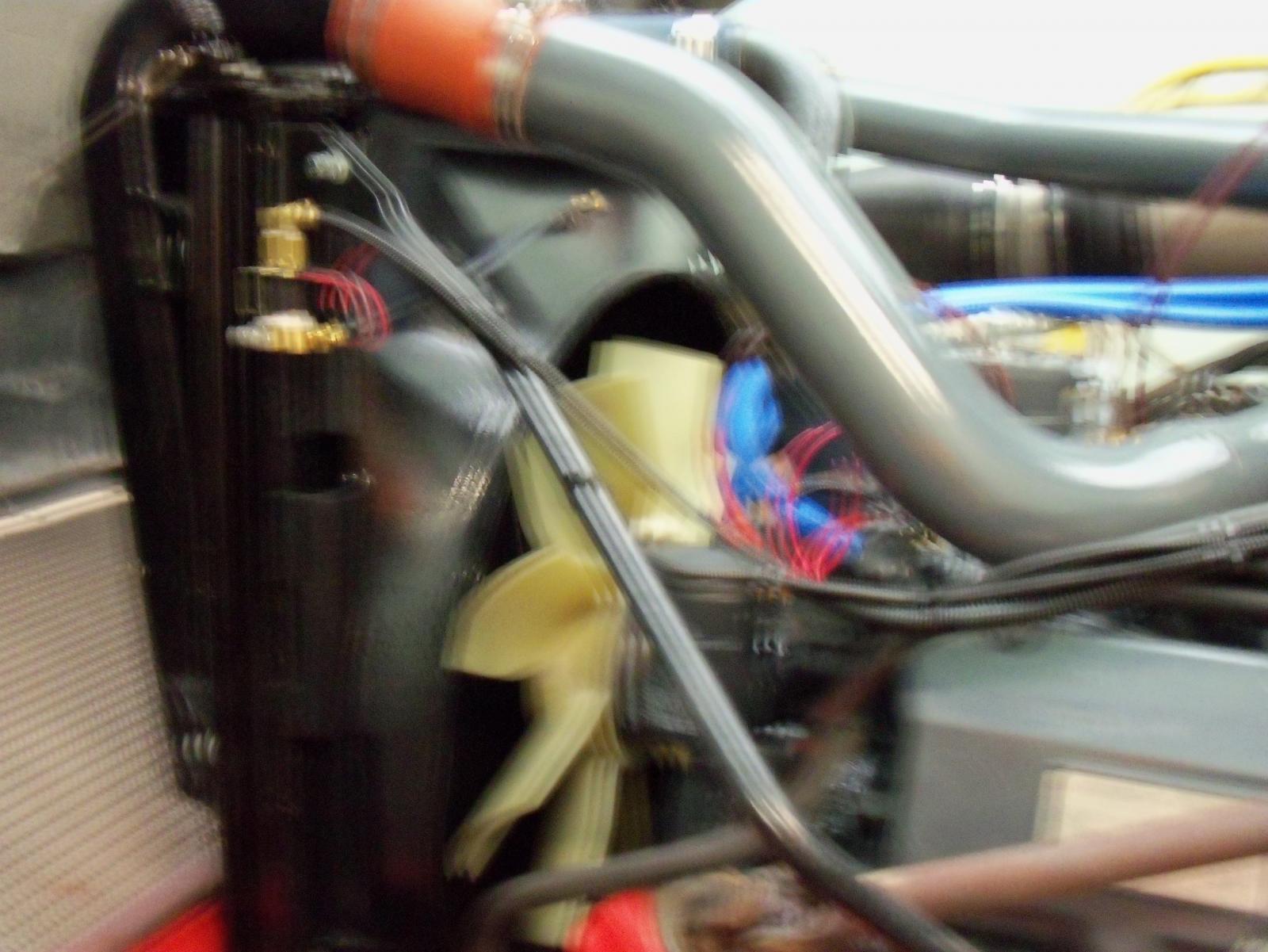

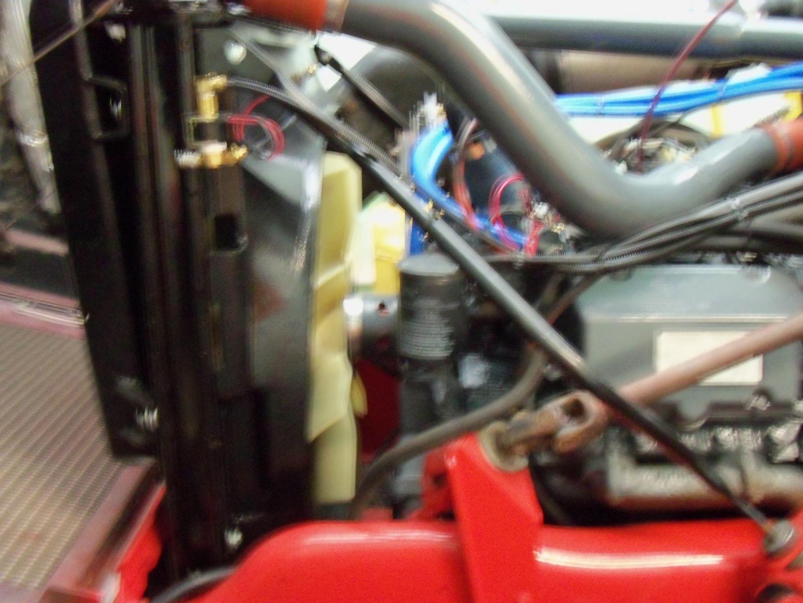

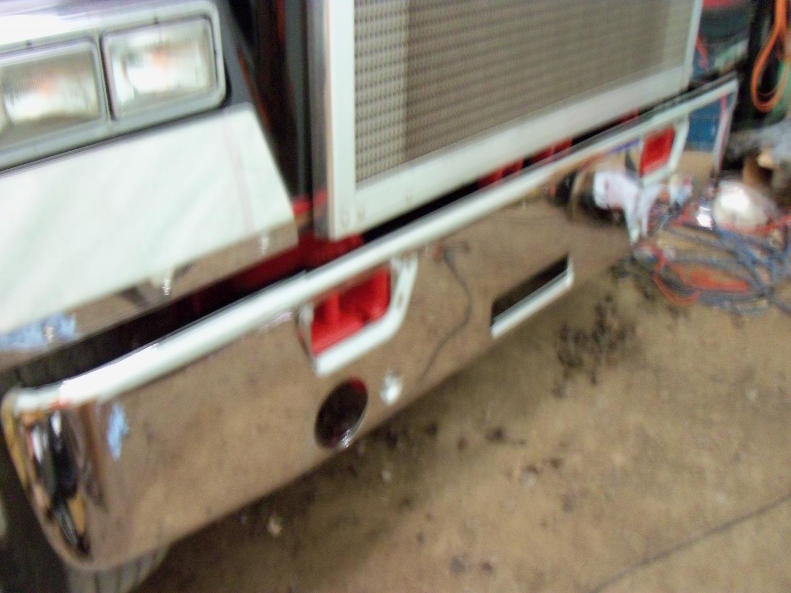

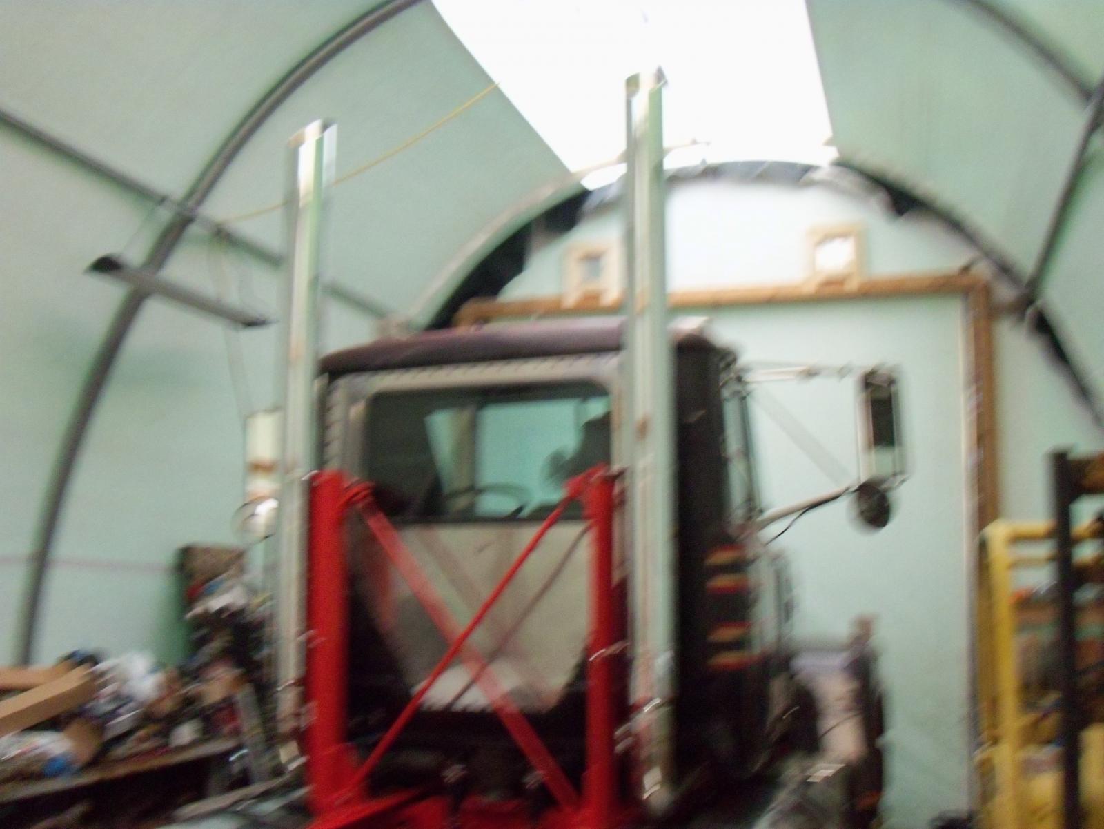

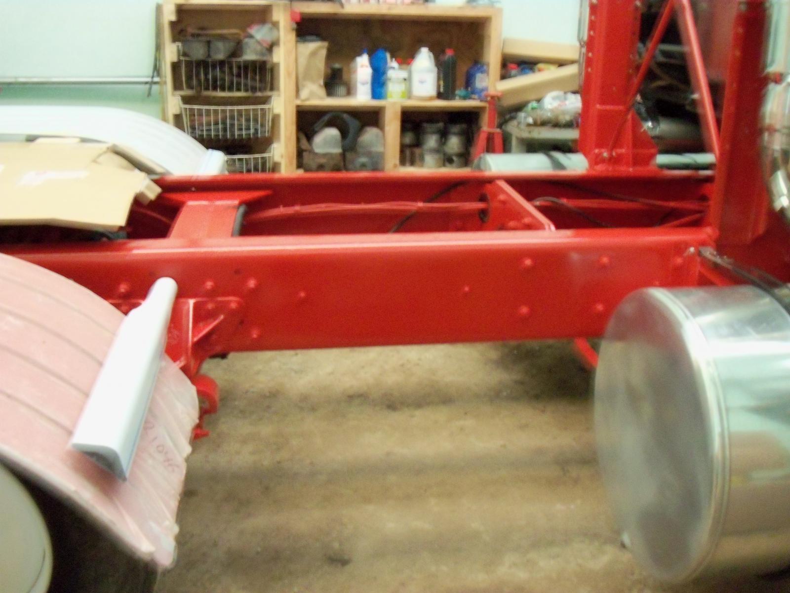

:SMOKIE-LFT: For as long as i've been posting on the forum you'd think I'd be able to figure out how to post pics. Well excuse me for my computer illiterance. Hereare some ofthe pics I shot of my Superliner project I took over the weekend. More pics to follow as soon as I find the card they're on.
HA,HA,HA, did anyone else notice the cutouts in the area above the "shop" door for the stacks? that is awesome, I have wondered about one of those things for me till I have money to build a real shop, now I know how to do it! I think that is great, some american ingeneuity comes to the rescue.

That is cool. He's from Canada it says though, so its Canadian ingeneuity. Haha, I'll have to get Papa to do that for the U when she has her big straight pipe. You gotta line it up perfectly though or your going to the parts store and getting a new pipe... Hahaha.

Now just learn how to hold the camera without shaking :banana:
:SMOKIE-LFT: Ok maybe I was shaking a bit, I thought it was jut a problem with the lighting that made them look like that. My first time with a new camera, that's my story. LOL.

:SMOKIE-LFT: They look like cut outs for the stacks, but they're just a couple of trailer door vents to let air in to stop it from sweating in there. The building has a 12' high door so she just fits under the door. It's a Cancover building 20'by30' 16' high with 12' by 12' door. I put that up about 2 years ago to house and work on the old girl. Best $2500 I ever spent, wish I had done it years ago.

Truck looks nice, question for you the stainless pieces under headlights where did you get those, looking for them for my truck to reduce the road chips.
:SMOKIE-LFT: To be honest with you I put those on the truck at least 10 years ago and I can't remember who made them. I got them from a truck parts shop I deal with in Windsor and they were hard to find then. There is'nt a lot of aftermarket add ons you can get for an R model or a Superliner. We made a set for my Dad's truck. Just used 16 gauge mirror fnish stainless cut them out to shape and put a slight bend at the bottom. That's probably what you might have to do get some from a sheetmetal shop and have them cut and bend it, should'nt cost too much or take too long to punch out a pair. You might try Raney's truck parts in Florida. They're about the only ones I've seen that can get much stainless for Rmodels. You could also try Dieter's they might have something too.You're right about them reducing stone chips. they do work, plus they help make the look of the truck.
Thanks for the info,,,,They do look nice on your truck, going to probably do as you suggested have them made to fit,,,,Do that when I get frame painted in April.

Good info on the building and the possible stack cutouts, Belmore made those rock chip guards for under the headlights of a Superliner. They said they fit 78-93 but most of us know that's not true just 85 up unless you trim em down bout 3/4".
