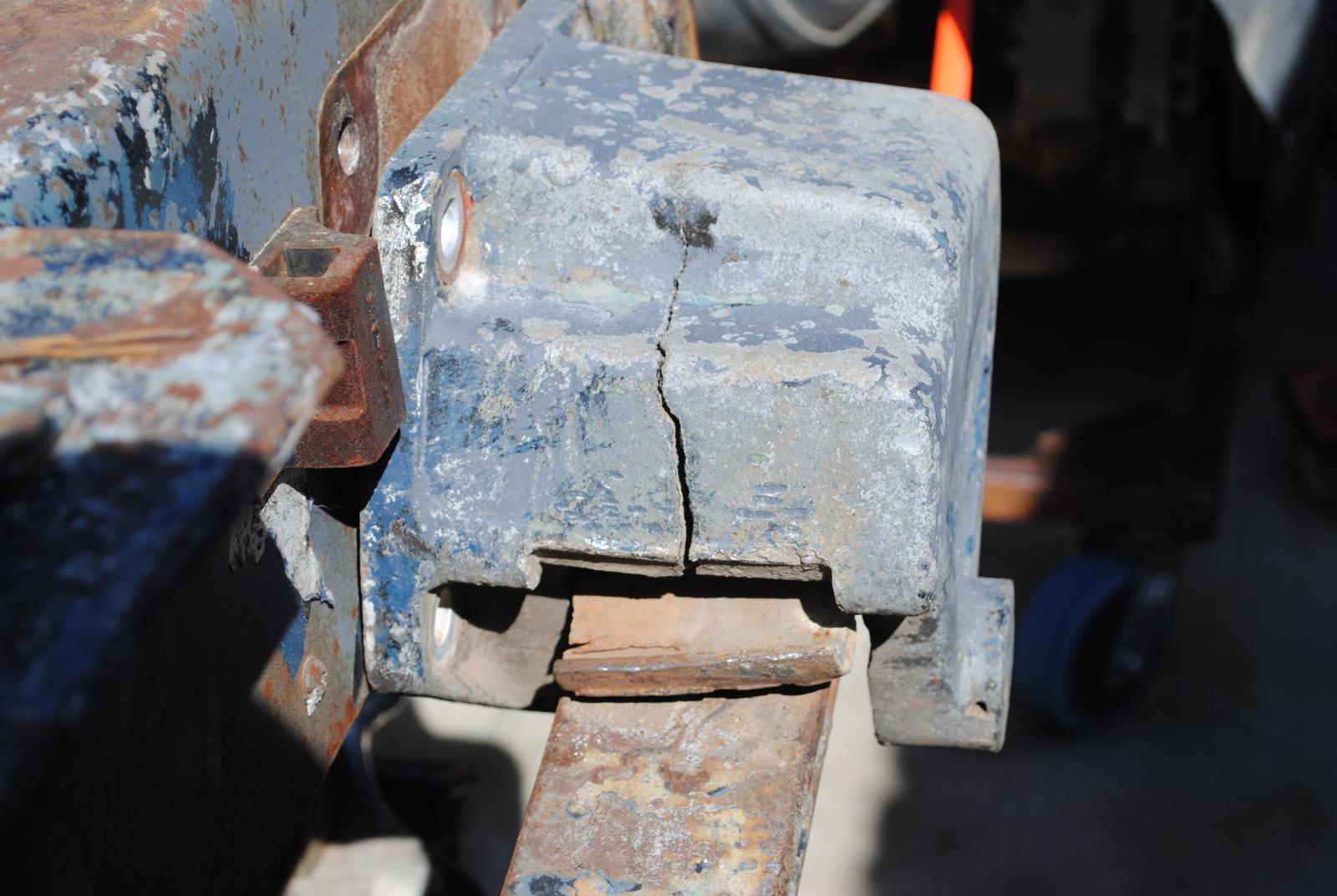

Anyone know if a rear spring hanger on an H61 would be the same as a more common B model? I've got a cast aluminum left rear spring hanger that has a stress crack darn near through the whole thing. Was hoping to find a steel one to replace it with and hoped they were the same as a more commonly produced series.

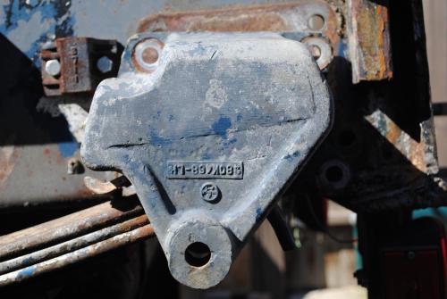

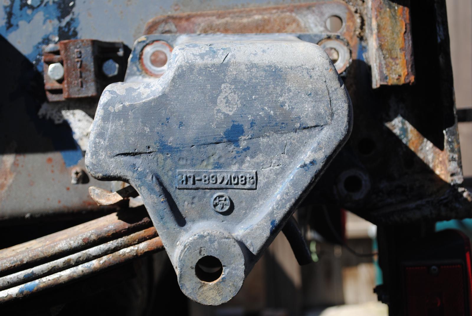

I noticed the casting # is the same as a pic of one on a B model except after the casting # on the B model it had a "B" assuming for B model and my H model had an LH at the end. The hanger is visibly different as far as its shape compared to mine but the bolt pattern looks similar. I was surprised that on a suspension hanger they'd use aluminum. If a B model hanger would work I'd like to grab a couple and replace atleast my fractured one. Can't drive it the way it is. Everything on this H61 is original and one day when I tear it down to restore it I'd like it to be all original but there's no repairing this one hanger. I'll try and post a few pics of it tomorrow if I can.
Here's a few pics of the busted hanger. I also have an H63 that I've put an air ride under and the bolt pattern is the sameon both. Problem is the old hangers are long gone. If a B model hanger will work does anybody have some I can buy?post-2896-0-13613400-1361732479_thumb.jppost-2896-0-30703000-1361732525_thumb.jppost-2896-0-32653600-1361732562_thumb.jp

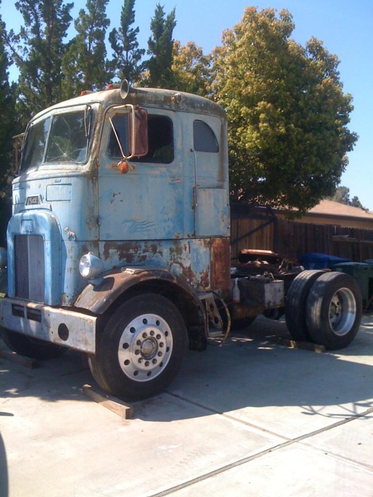

It's got the hydraulic hand pump jack that extends two hydraulic rams. The rams extend and tilt the cab mount arms forward and up. Same style that my 57' H63 has. Gotta replace the water pump and get the spring hanger replaced so my boy and I can start bombing around in her again. My H63 is tore apart and in the process of restoration. It's taking a lot longer than I'd like but at least I've got one truck to drive around and enjoy.
Nice H-61! I might have an extra B model hanger (in iron),in my expensive extensive inventory! If I do,I'll PM you,OK?
yea, a cast iron B model will replace that one. Mack used the same bolt pattern on the hangers and crossmembers, just some holes werent drilled. id like to find a set of those hangers in aluminum but they are like hens teeth. ive seen the cast hangers worn right out myself let alone the aluminum one. my grandfather B42T i think is on its second or third set of cast hangers on the ditch side and only has 195,000 miles on the clock. lets say they loaded the poor thing for all it was worth back in the day, even has a D8 on a lowboy behind it a few times when she wasnt haulin coal with a Galion trailer..
