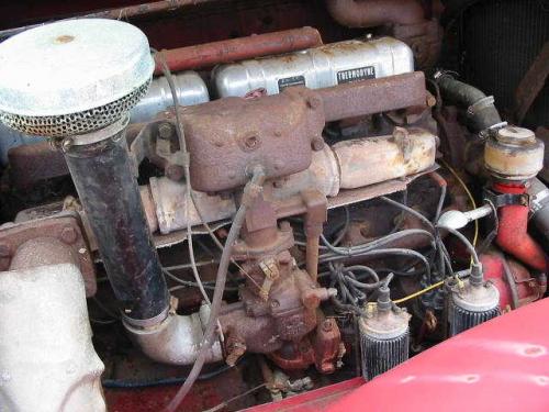

The 707 is similar to the 510, if you have an updraft carburetor the intake manifold will be a three piece system, a right or front half, a left or rear half and a center piece that joins the two halves.
I have a picture somewhere and I will see if I can get it for you ASAP.
I hope this helps!
David

Ok I found the picture I was looking for, this is a ENF510A which is very close to the 707 (I think) anyway you can see what I am telling you about the three peice intake setup.post-86-1193442170_thumb.jpg
1948 Mack Pumper

Hi,
Thanks for the picture, I appreciate it...
So it looks like the intake manifold has bolt on flanges? The manifold I am trying to identify has large flat washers that go over the outside of it and clamp down between itself and the exhaust manifold.
Thanks, Tom
