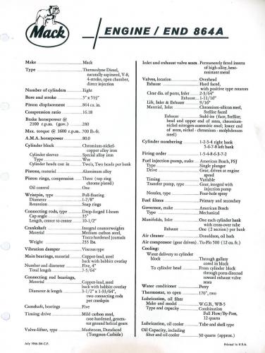

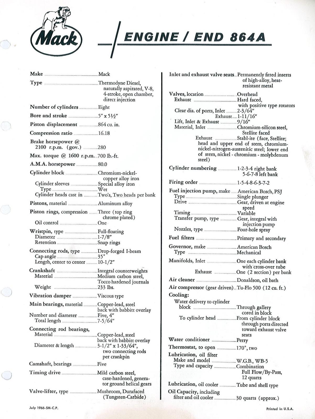

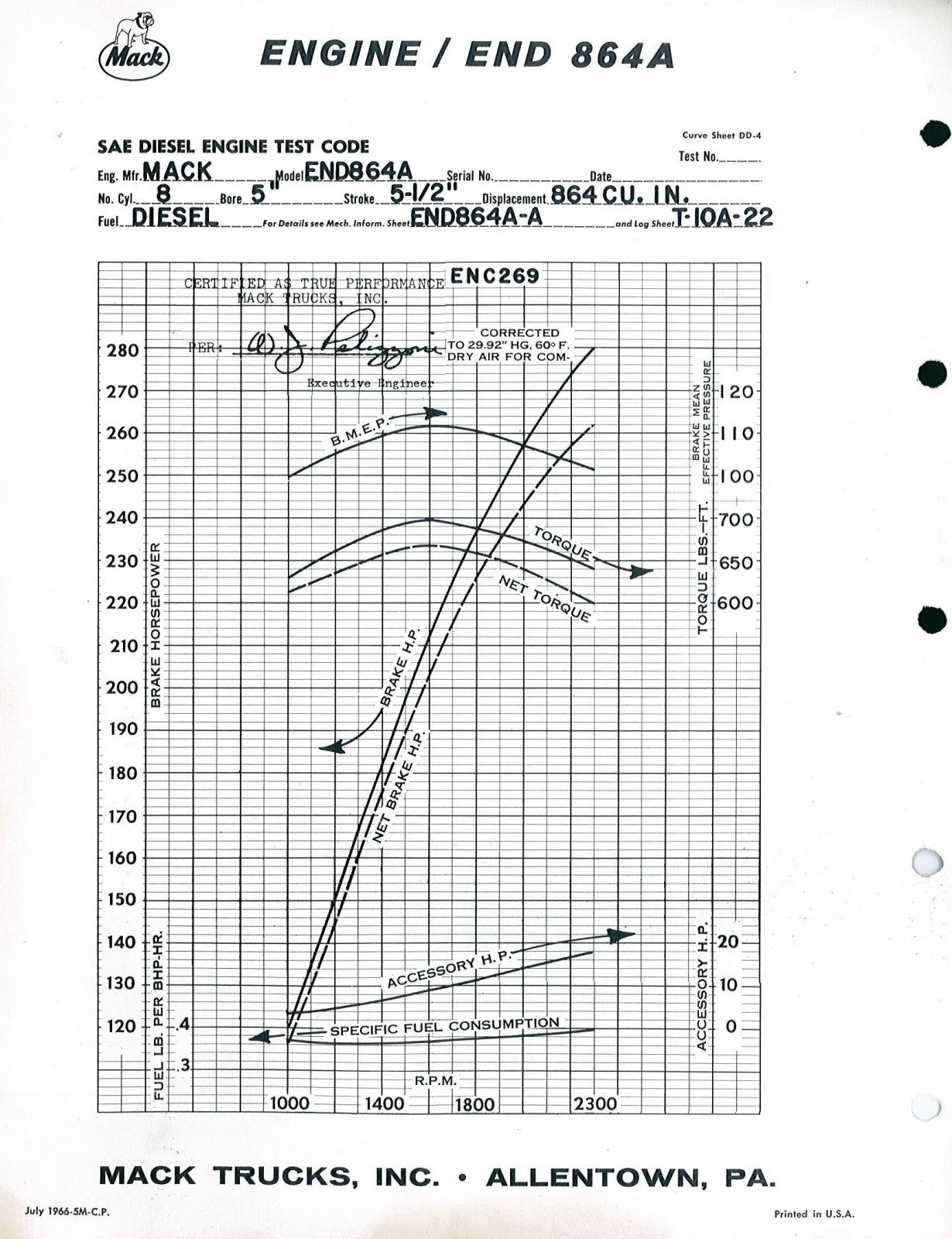

Note the performance is certified by none other that Mr. Win Pelizzoni, co-inventor (along with Mr. Walter May) of the high-torque rise Maxidyne engine technology.
post-5381-0-81377000-1362703845_thumb.jp
post-5381-0-76966200-1362703885_thumb.jp

https://www.bigmacktrucks.com/topic/30286-mack-v8-s/#findComment-170598
The above photo shows 280hp@2100rpm ? !
It shows 700tq@1600rpm ? !
So it looked like the torque is up in the revs but the HP was shown as to be at 2100rpms . . . So I had to ask ;o)
