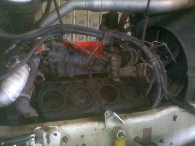

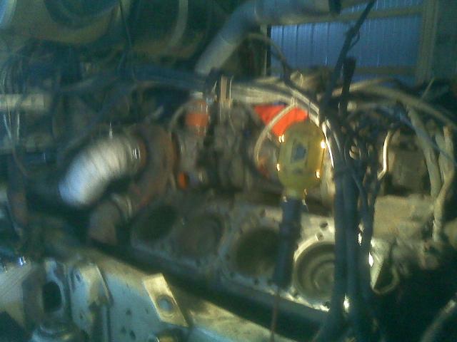

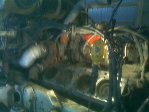

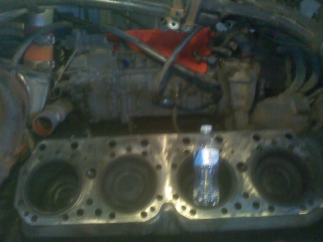

was board so what else to do, the head gaskets aways leaked oil so time to fix it, i put a water bottle for up there for those of you who dont get in side one of these that often to get an idea what an 998ci, or 16.4lt 8cyl engine looks like in side.
