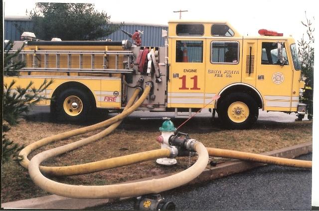

I don't have any complaints about our 3 1/2 most lays in town will be 150-300 feet and we have a decent water system, so we really don't need ldh. When I tell people we still run that hose they give me a dumb founded look, and then I say humat and they really get puzzled lol.
Rudy
I also liked the Humat valves providing you have enough pressure in your water system to overcome the friction loss inherent in the design. It allows one engine to operate alone with a reliable water supply providing you have the staffing to leave a member at the hydrant. (or the driver is a hustler and makes the run back to the hydrant after getting things going)
Even if you don't use them in your day to day operations they are a valuable asset whe you are forced to operate alone for an extended time period during events like thunderstorms and tornadoes when you run out of engines.
We run Humats converted over for use with 5" LDH. This pic about 15 years old. Big water drill with the Montgomery County LDH Task Force- which will guarantee a minimum of 1000gpm for one mile. I was driving when this was taken, I can't remember the exact numbers but I was moving lotzza water.
