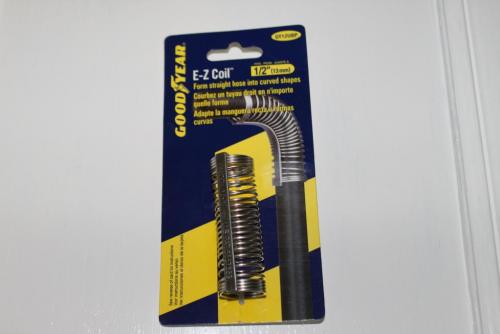

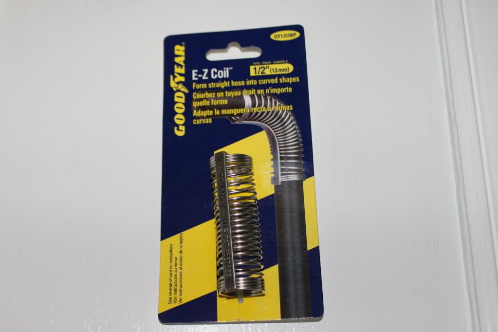

f all else fails Good Year make an item called E-Z Coil . Goes over the outside of your hose and allows 90 degree bends in straight hoses with no collapse. Comes is all sizes up to 1 1/2 inch dia
