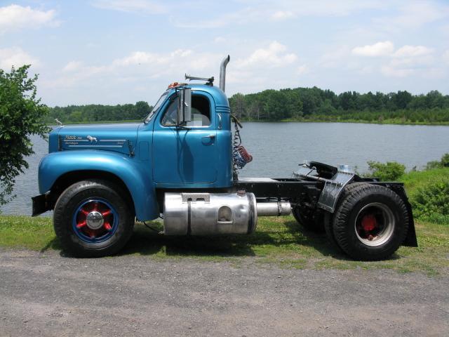

I got my antique plate for my B-model yesterday so I could at least drive my truck once in a while when I get a spare minute or two (LOL). Only cost $133.00.
Anyway, now the problem I have is the one I'm driving is a 422 that was converted over to a diesel with a two stick 9 spd. The rears were never changed, so the ratio is 7.00. Need
less too say, the truck tops out at 45 mph. I have a quad box to put in or should I look into changing the rears? What ratio would work best if I leave the 9 spd. in? Truck has 10.00 X20's.
