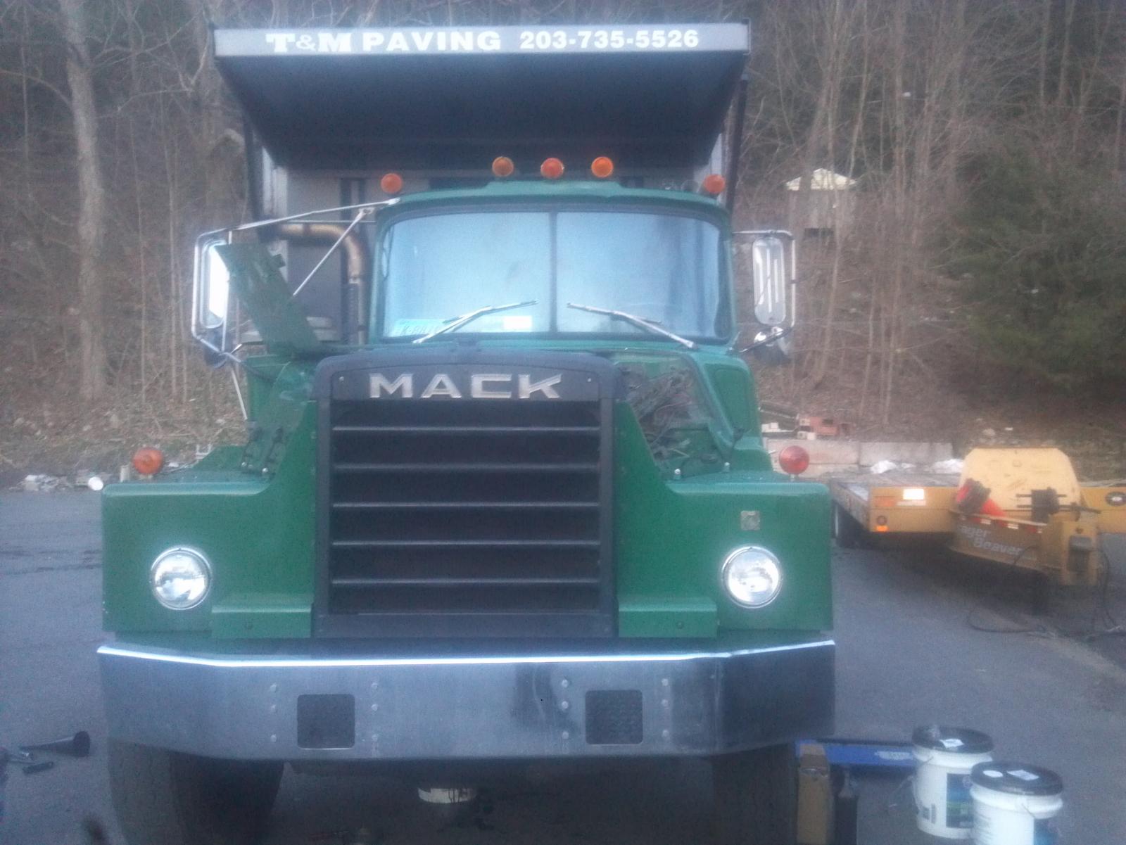

Take a half day to look over the whole truck. look for grease fittings and such
And yes, pictures are required nice to have

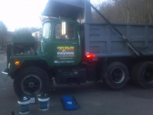

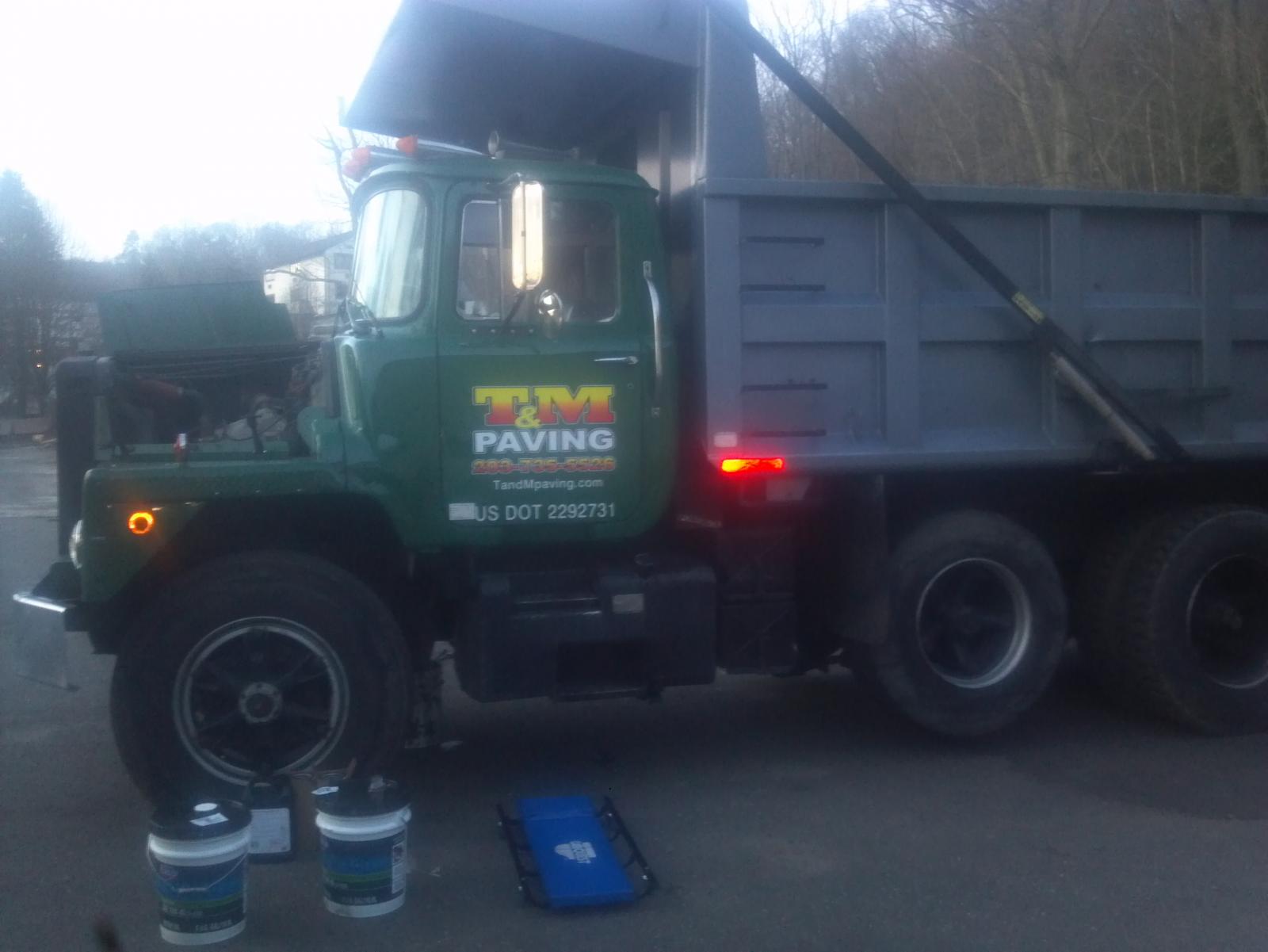

Welcome to the site. You couldn't have found a better site for information. Please post some pictures when you can of the truck. We love pics.
