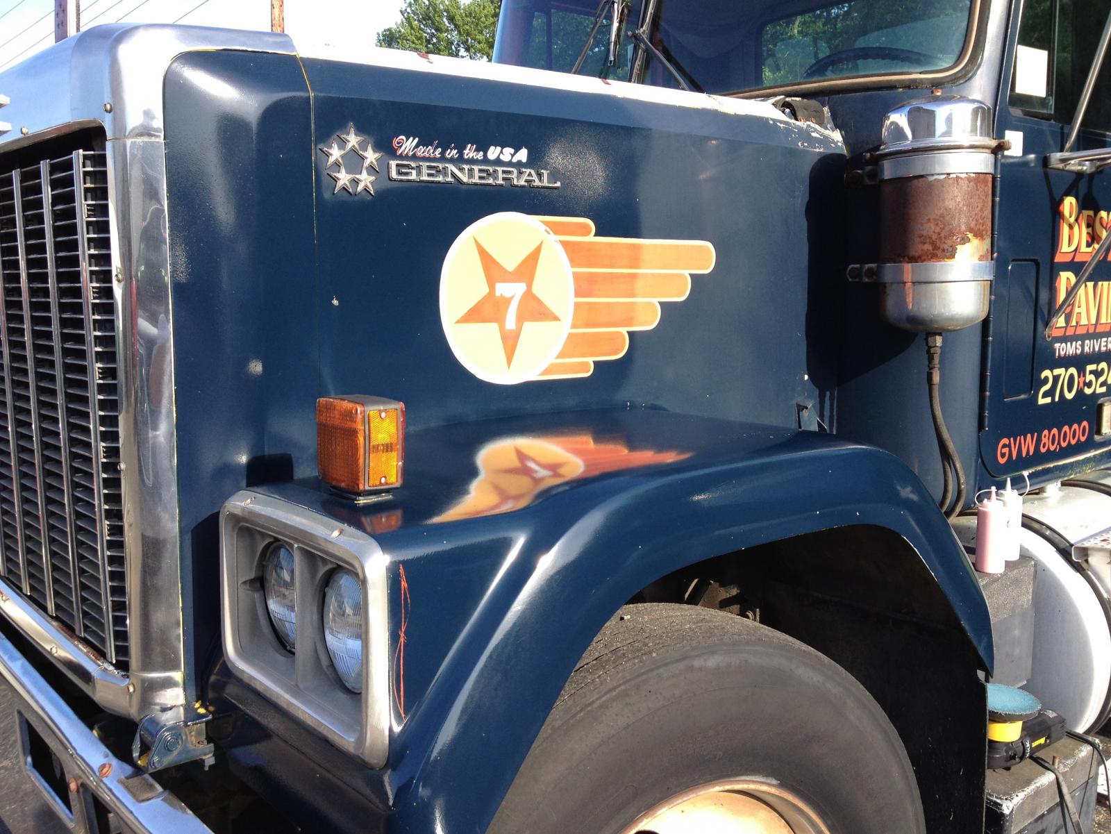

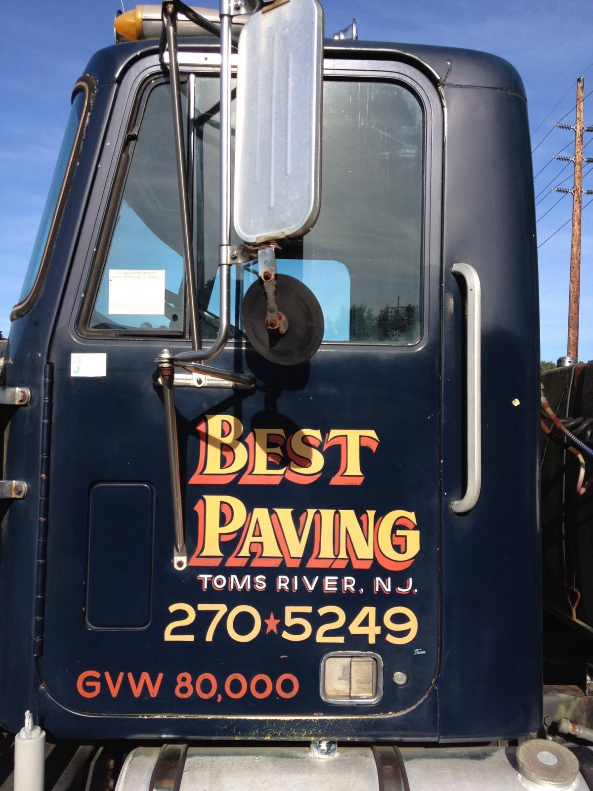

Started to buff out the beast. Looks like I will be able to get some shine back in her. I got the new Kysor valve. Just need to get a new 90 degree air fitting and install it. One thing I forgot is I need to replace the belts. They are all dry rotted and I don't trust them for the 2+ hour drive up then back again. Hope I can get those done within the week.
But I did install my new light bulbs! I know not technical but heck one more thing done.
You can see the line where I buffed the hood to show the comparison.
post-11944-0-17009700-1370484756_thumb.j
post-11944-0-07614000-1370484737_thumb.j
Look at the upper door area compared to the door that was buffed out.
post-11944-0-63882800-1370485066_thumb.j

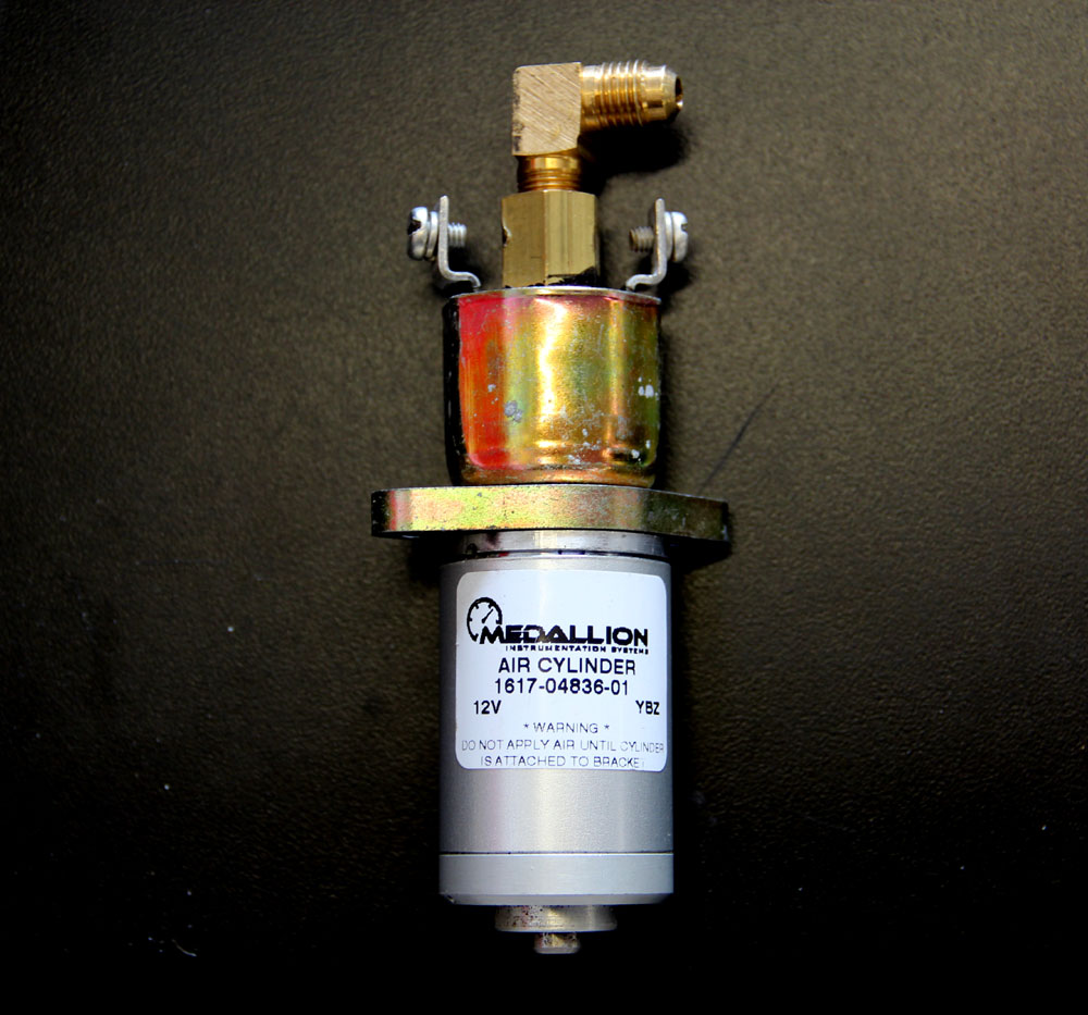

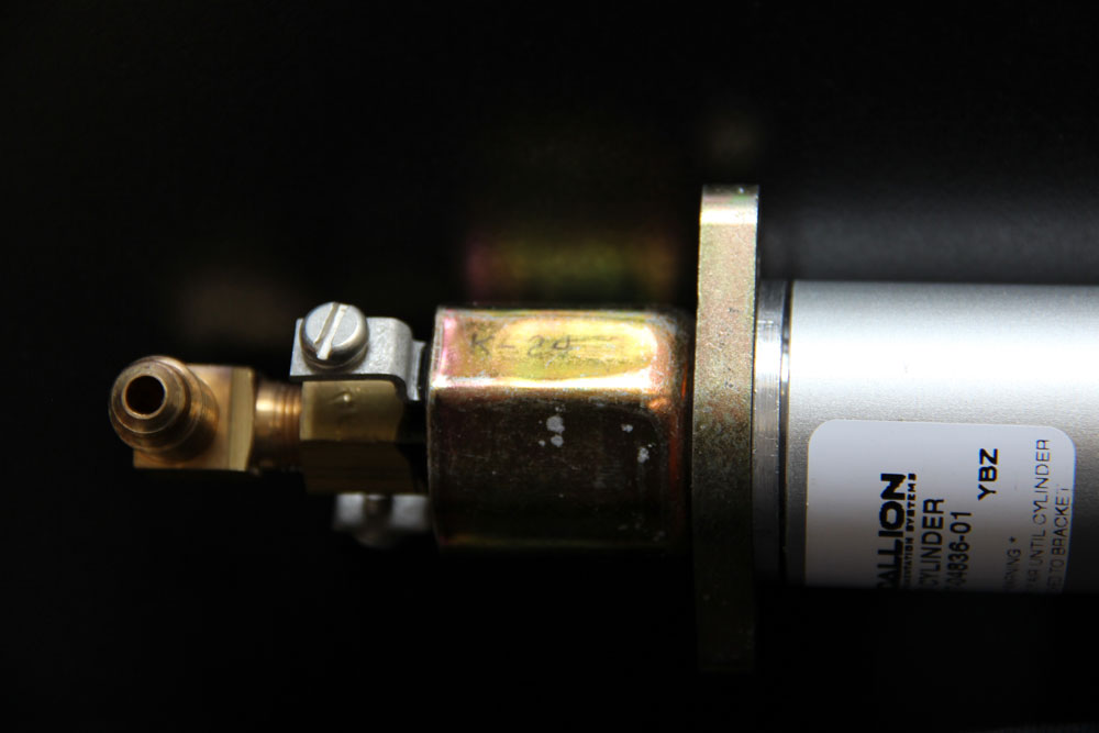

Got a snag today and need some assistance. I installed the new Kysor shut down today and fired truck rig up. She ran for about 3 seconds and stalled. Tried to fire it up and nothing. I looked and the plunger is fully out and holding the shut off lever preventing it to start. WTF? The old one would at least wait a minute before it would shut down. This one is instant on. The new Kysor had two terminals on it so I hooked the wire to either one to see if it made a difference and nothing. Then I tried it without the wire connected and nothing.
Can anyone give me an idea what to look for? I called my diesel guy and he can't get here until Tuesday or Weds. That's cutting it short for Macungie and I still haven't really road tested the truck yet. One step closer and one step back - ARGH! Any ideas would be greatly appreciated.

The new one is probably insulated. Check for polarity markings on the terminals. One should be positive and the other negative. If it is not marked, then it doesnt matter which is + and -. Make a jumper wire up to ground one terminal, and the other to key switch. Did you check for voltage at the terminal?
Mike Pacitto
Chelmsford Mass
I didn't do anything yet. Didn't know what to check. I didn't think it had markings but I'll double check. Got the key switch wire already there.

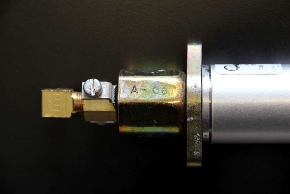

Back from Macungie and now even more motivated. Its a little slow today (or not really focused on work) so I pulled the new Kysor valve and checked it for a positive and negitive. All I found was A-06 under the one terminal and K-24 under the other. Anyone have some advice to what these are? 6v or 24v? or something else? Need to get ready!

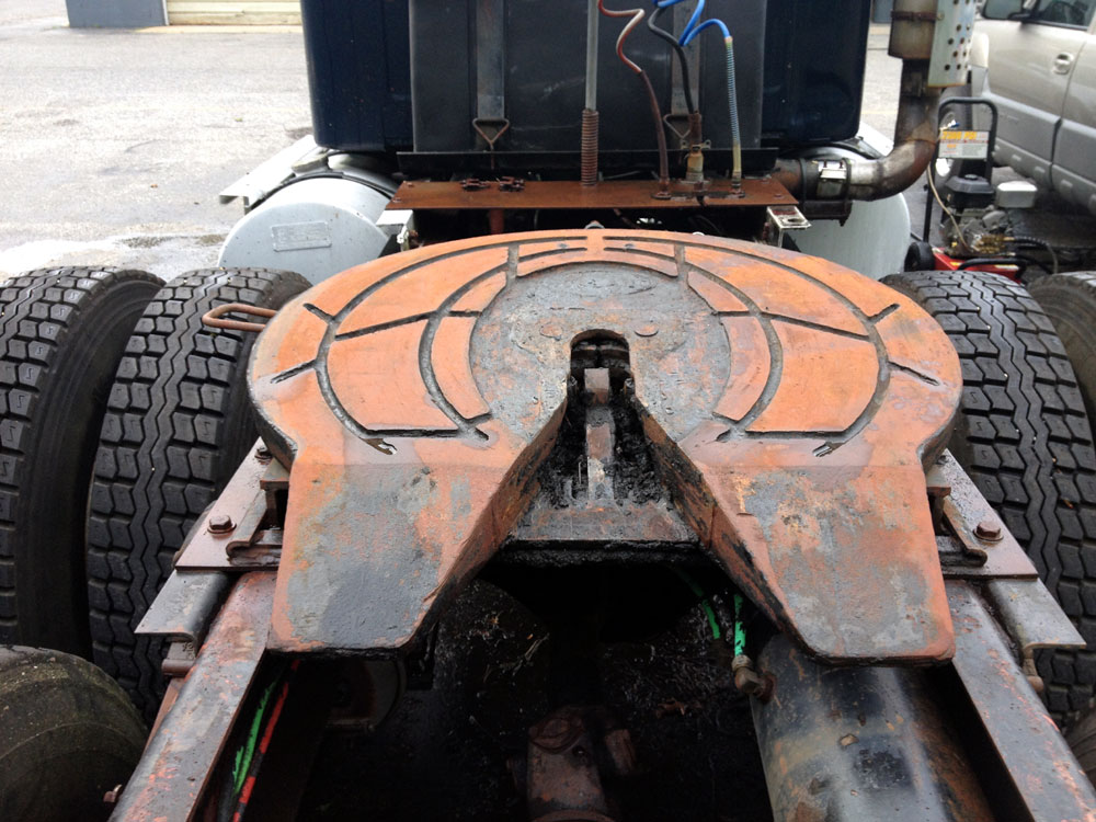

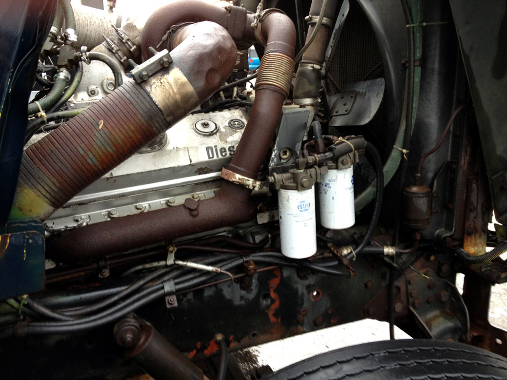

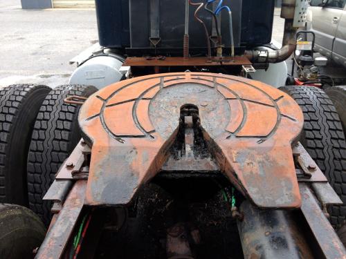

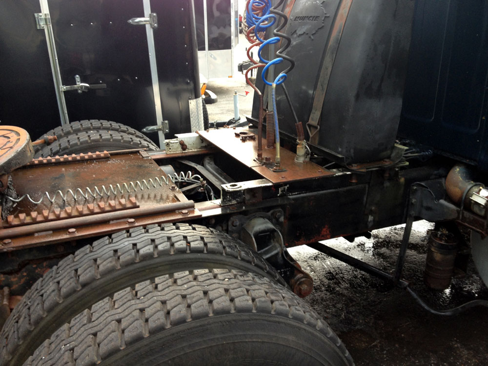

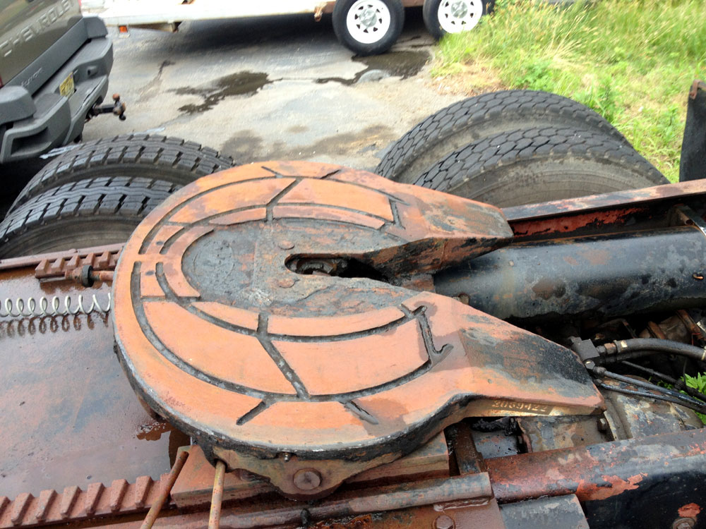

Since the truck is not running again due to this Kysor issue but I am still off the Macungie high, I busted out the powerwasher and tried to get rid of the rest of the green crap that was growing on the frame. I also chipped away at the old dried grease on the Holland 5th wheel. While I was at it, I hosed down the engine compartment for the heck of it.

It looks like 12 volt to me.Doug
It says that on the main body but what are the two terminals? Which one do I hook the power lead too and do I have to ground the other side?
~ JT Burkard ~
AKA Sweaty Mack
JT
I'd check for continuity between each of the terminals and the main body of the of the cylinder.
If there is no continuity between either one to the body of the cylinder, which I don't think there will be, then one terminal is definitely for ground.
If that be the case just put the power lead to one terminal and a good chassis ground to the other.
Doesn't make any difference which one is which as long as it's insulated.
Ron

I think I am going to make a ground wire and hook the power lead to one side and ground the other. If that doesn't work, hook them up the other way and see if that works.
