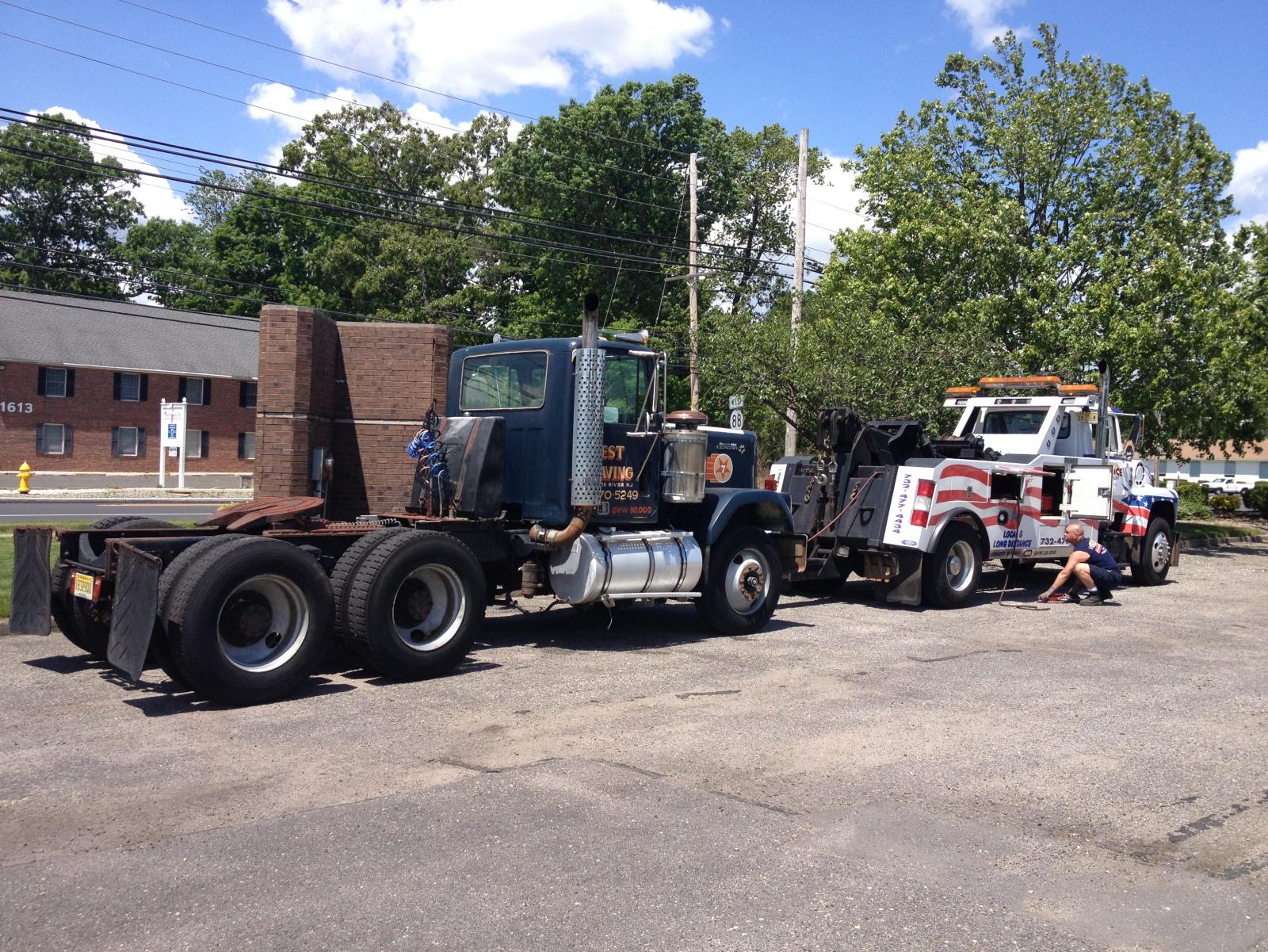

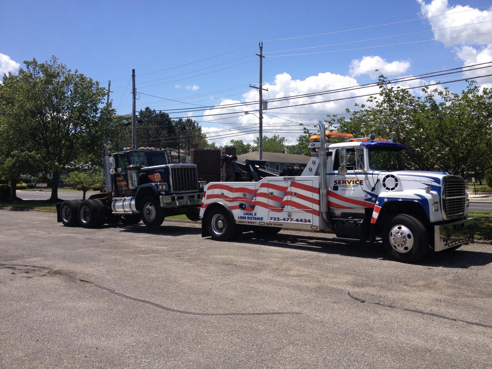

With Macungie coming in two weeks I figured I need to get more seat time. Still haven't mastered the 13 speed yet plus I want to get some miles under these tires before driving 2.5 hours. Yesterday I left my shop and was going to stop at Wawa for lunch. On the way I stopped for fuel first since the last fuel I put in was about 10 gallons a year ago. I put in $100 then pulled out of the Hess station made it 1/4 mile and the General lost power. I managed to get it off the road with my foot to the floor doing 1 mph before it completely died out. I called my shop and had the kid Don bring my pick up and my tow strap so I could get it out of the way since I was in the middle of the lot.
I bought two new fuel filters even though these have only 8 miles on them. I filled them with fuel and installed them. Cranked it over and nothing. Just spun. I suspect a bad fuel pump. I was only 2 miles from my shop.
Today I had no choice but to get it hooked and drag it back to my shop. My diesel mechanic it going to take a look at it later this week. Unfortunately, I am not going to make the show with it. My wife and I are still going, just not with the General. A bit disappointing.
