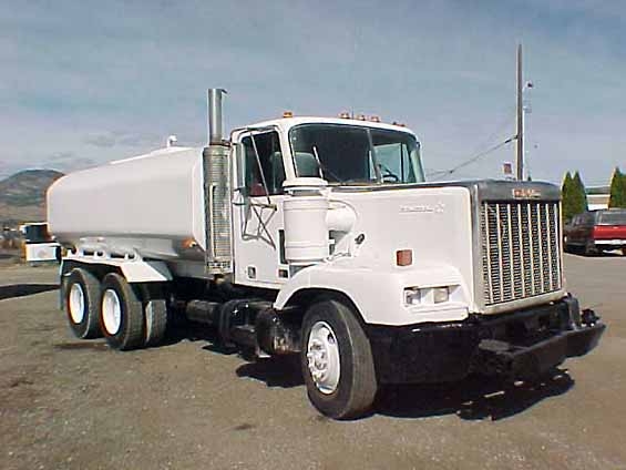

Saw this for sale on E Bay. 1987 General.SBA with Big cam Cummins. Never saw that type of nose before. Paul
It was under Ended Auctions yesterday morning.
That looks like a set back front axle too. I have seen a bunch of Generals (pictures) but never seen those headlights. I checked completed auctions and only found a General dump. Did you get an item number?
~ JT Burkard ~
AKA Sweaty Mack
I went back in to my computer history and the listing came up as canceled and a list of suggested similar items. Those lights seem to be 1987 and up.
Paul
