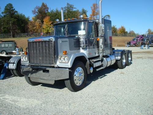

I noted your new avatar, had been surprized why you used Superliner pic while looking for a B.
It's not a Superliner in my avatar but the GMC General. They look similar. My old one was a B model wrecker I had seen in the junkyard a few years back. I still want to buy a single axle B but this is going get my feet wet. Ill probably play with it for a while then sell it for a good b61 down the road. Or add to the collection.
~ JT Burkard ~
AKA Sweaty Mack
One of the nicest Generals i've seen was at the ATHS show in Colfax,NC last year,very nice truck!...............................................Mark
There's a video of that one on YouTube
This one was at Gerharts last year. I was really diggin it too. How odd that I wind up with one.
