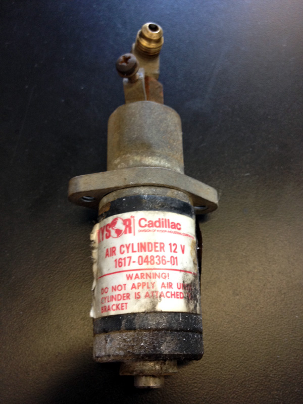

I still have to pull the Kysor shut down to find a replacement. The only way I can shut it off is by going under the hood and manually hold the shut down lever. It's becoming a real pain in the ass.

I am happy to report I was able to order a new Kysor shut down from Ross Equipment in Elizibeth NJ. The last one in stock! It will be arriving on Monday. I am one step closer to Macungie!
