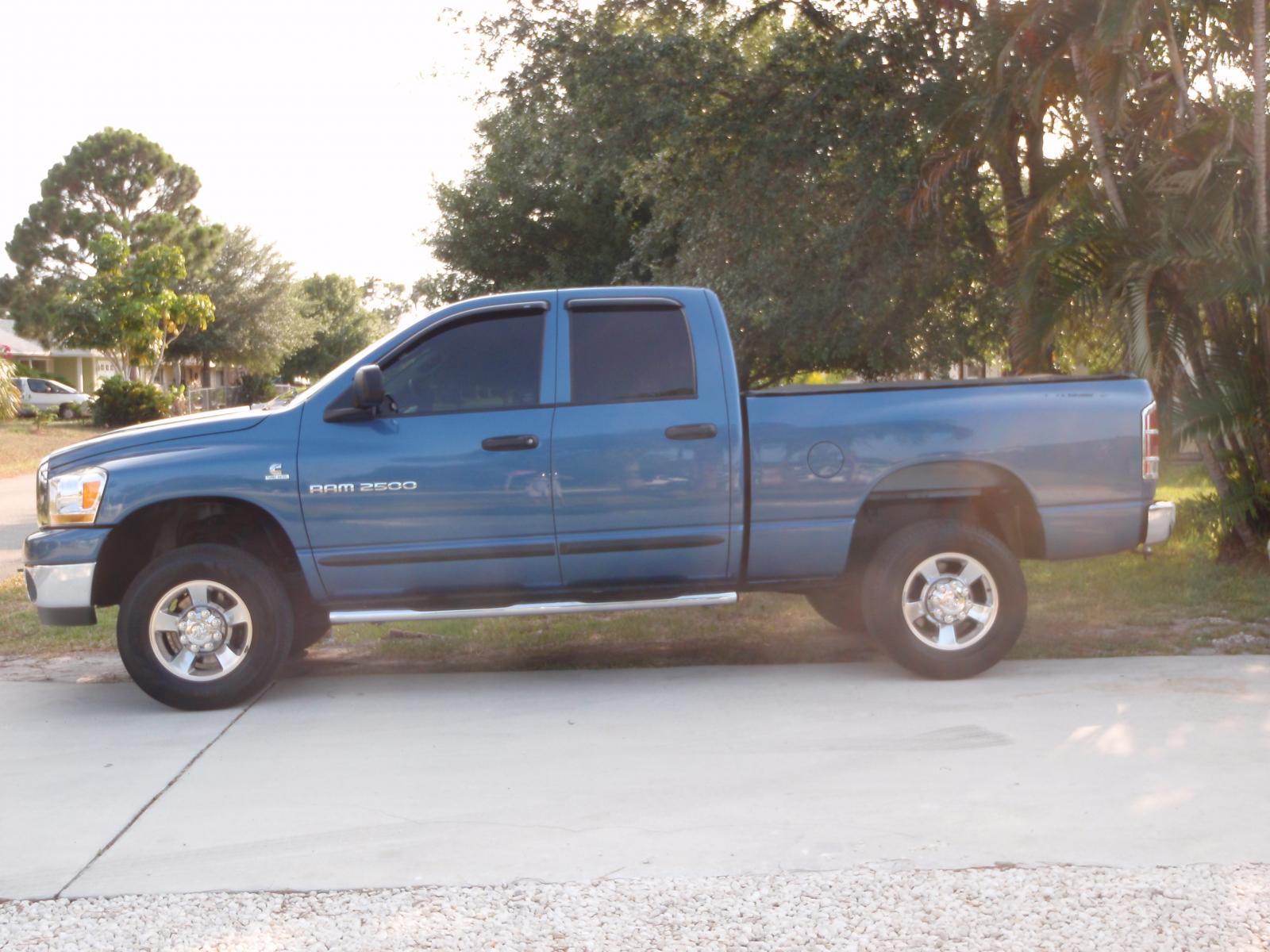

Got a 2006 Dodge P/u w/ 5.9 Cummins. Last nite it would start and then shut down. Several times it did it. Now won't even start. Turns over fine. shows a 10 code
Did change the fuel filter and looked around. Didn't see anything unusual
