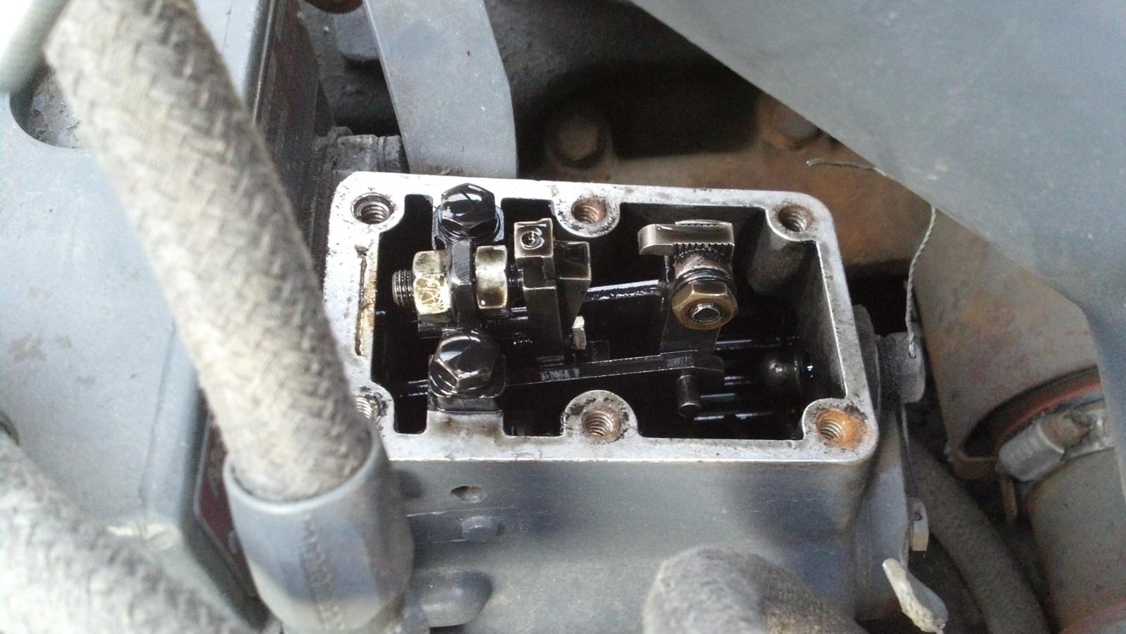

And after you get it running, cut the lock wire and remove the 6 bolts on the rectangular housing at the back of the pump and remove the cover. Inside right up top is a threaded rod with two nuts. Loosen the nut towards the front of the engine and then tighten the other nut to move the fuel rack stop forward. Then look at the lever behind the stop, half way down there is an Allen screw used as a fulcrum, loosen that screw a few rounds. There now you have just turned up your full load rack stop and your mid range fuel delivery. Get ready for the smoke! Oh and remove the puff limiter, its not really doing anything and its gonna try to stop that fuel rack from moving to our new adjustment till you have boost.

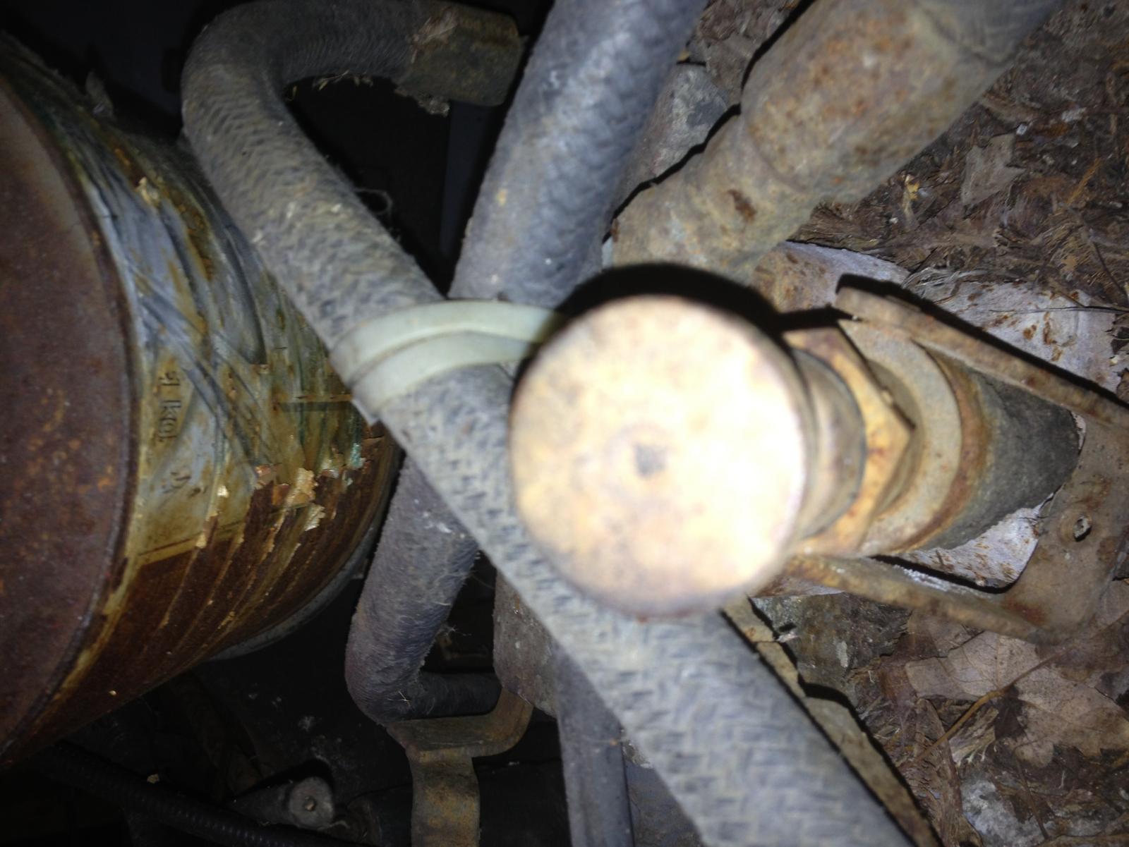

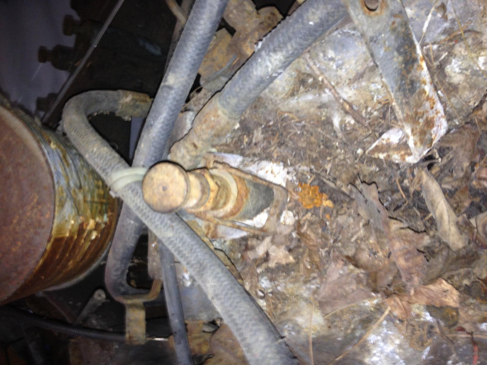

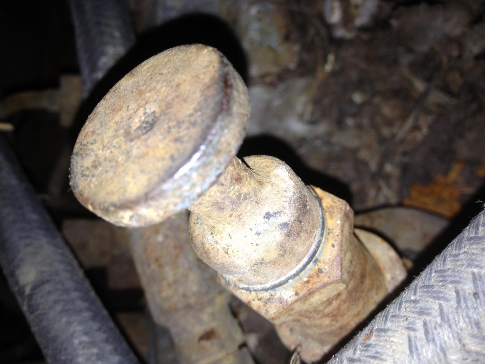

On mine it doesn't seem to lock by twisting, there is a U shape piece that swivels up over the top of the plunger, the U piece has a threaded bit that tightens onto the plunger to hold it in.
You can see the U piece in pics 1 and 3, it looks like the threaded bit is missing.
Let me know if you need a pic, but I won't see the truck in daylight for a few days...
Hopefully you get what I am meaning.
