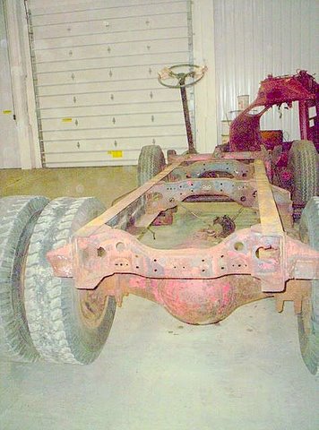

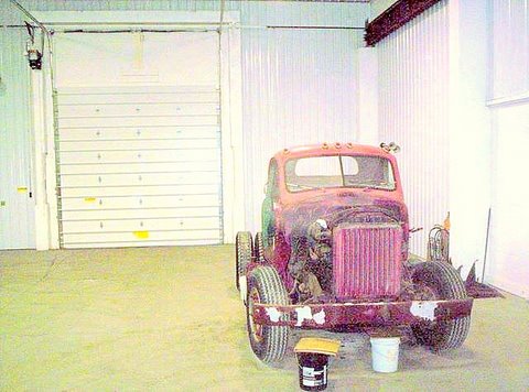

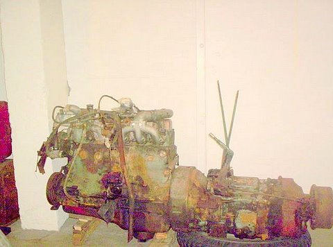

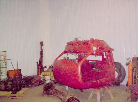

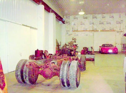

These are some early photos of my B-67 restoration. Please forgive the photo quality.
The truck, originally a city tractor in Philadelphia, was really in very solid condition. Minimal body welding required, and in running condition (yard driveable) before the disassembly.
The disassembly began in November 06. Today the frame rails are completely bare, sandblasted and epoxy primed.
The cab has the sheet metal work completed and is in red oxide primer for sanding.
I have a wiring harness coming from Top-O-Hill for a 12v negative ground system, using a single wire alternator.
After a lot of discussion and brain-storming, I decided to go with a 4.28 final drive in the original mack rear end housing on a softened spring stack for ride quality. I am planning a nine speed overdrive transmission behind the original 673P diesel. A Pac exhaust brake is probably in the mix, too. (Keeping my Jake brake for a future project)
Of course new brakes and lines are part of the picture, with maxi brakes on the rear axle.
Staying on the Daytons with new radials all around. Not using my power steering on this truck.
I expect my use of this tractor will be limited to local and light loads. It was my first Mack purchase, and is probably less than an ideal truck for much other than local use. (space limited both inside and under the hood)
But - it will be a heck of a nice local truck! I have a pretty nice 25 ton Eager Beaver lowboy to pull.
I will update with more photos soon.

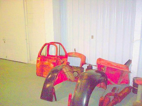

Now - I think I've got it.
Unfortunately these photos are of a poor quality.
I'll do better next time.

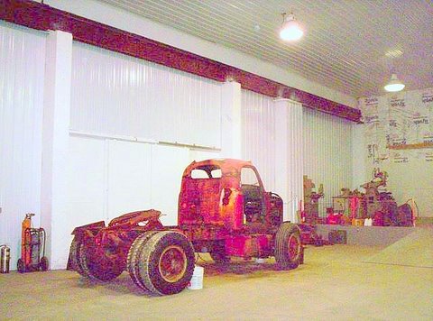

Nice shop Paul!!
Makes that B look like a toy LOL!! When I back my truck into it's parking spot, you have to step out into the yard to change your mind LOL!!

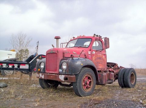

Yeah Paul,nice shop and I like that B-67! I had a hard time posting pictures too,so i'd just mail them to Barry to scan and post for me.I like to think the problem was my old PC (STUPID COMPUTERS! ) Ever since I got this new one I haven't had any trouble.
https://www.bigmacktrucks.com/topic/3083-b-67-restoration/#findComment-15216
Another photo of the same old dog
That's a nice unit there-you've got two classics in one.I didn't notice it was a Brown body until I enlarged it. H.H.Moore trucking used to have some old Brown trailers they made chip trailers out of.
