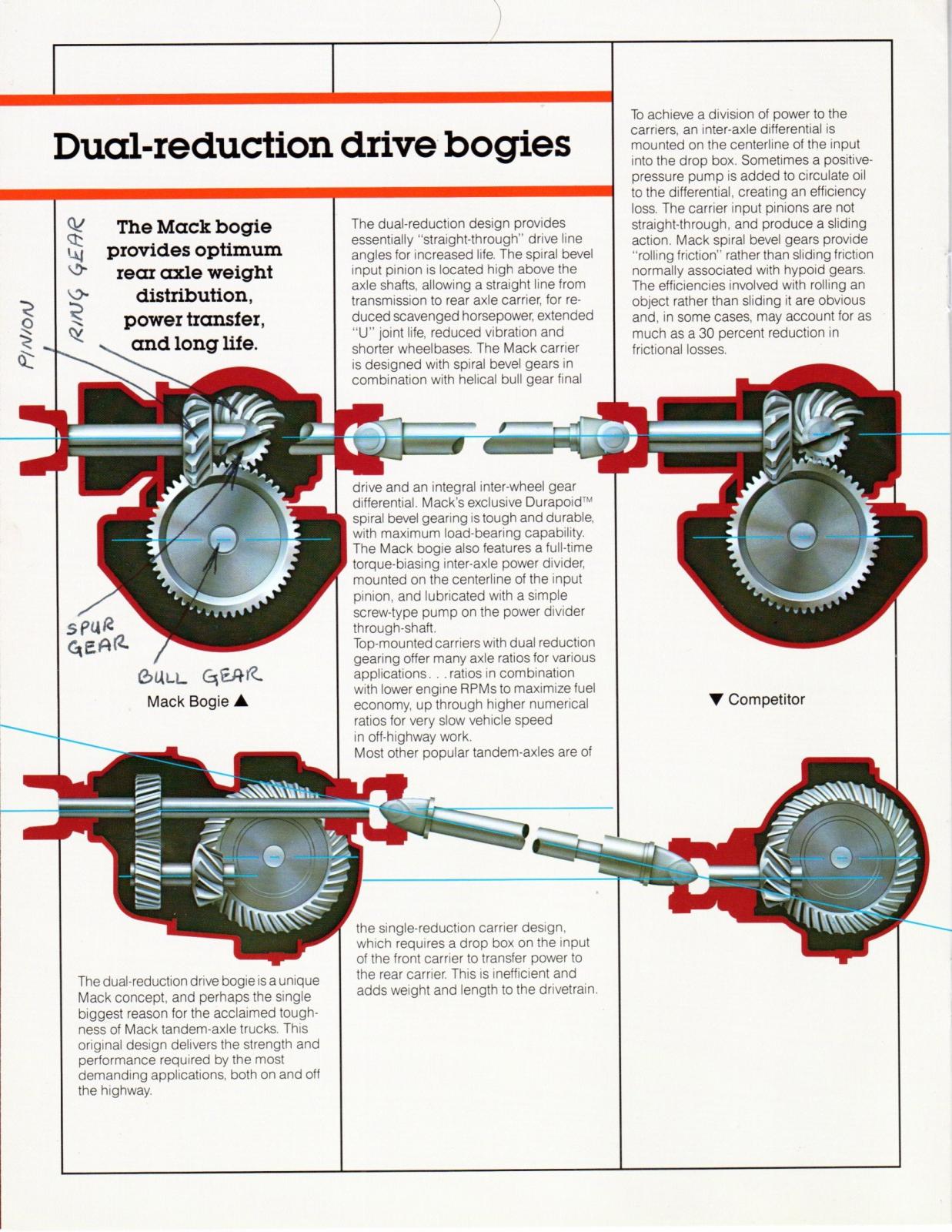

Well I was told that ALL "Mack" branded axles had carrier's that were all Meritor's ? !
Now as for toploaders vs frontloaders:
Topload's are double and triple reduction ? ! front loads are single reduction ? ! So ain't that an apples and oranges comparison ? !
More moving parts = faster wearing or so I'm told.

A comparison between "front loaders" and "top loaders". Also remember, all similarly rated axles are not created equal. All three manufactures mentioned offer different versions of the same weight rated axles. There are different housing thicknesses, different housing materials, and different gross combination weight rated carriers (gear sets). So keep that in mind when you do comparisons.

Keep in mind that 34000,38000, and 44000, all used the same carrier, at least that is what my Mack literature says from 1977.
