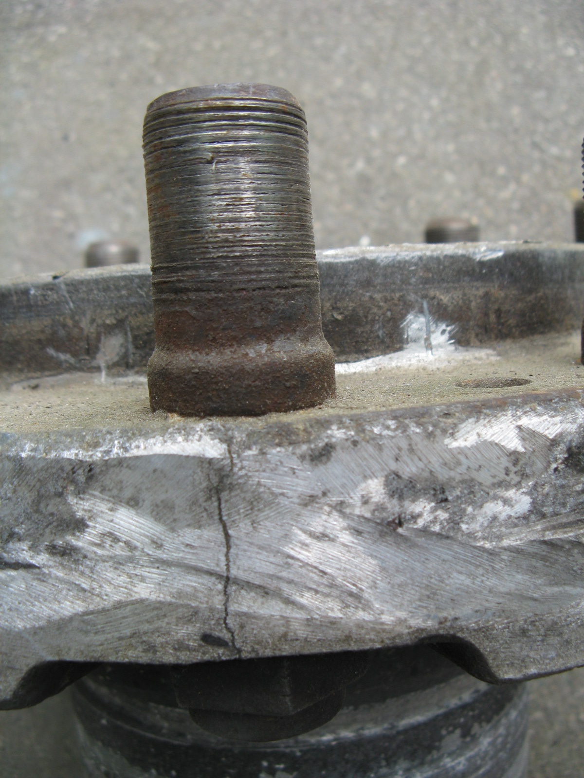

watch out for tire shops using "nut buster" guns... even if they recognise the "L" stamped on the stud and undo them without damage, watch out to ensure they don't hang on the trigger too long when fitting them back on...
reason.... these types of air gun are calibrated with 'extra' torque when spinning left hand.... it is used to assist in removing seized conventional hub piloted nuts which are right hand thread in all positions...
the "technician" can run the gun too hard to the left, distorting or even stripping the threads... he will use his torque wrench after and it will click at 450 not knowing he probably applied 800+
if you have aluminum hubs this overtorque can crack the hub... I found one on my bus as a result of a nut buster on the left front...
