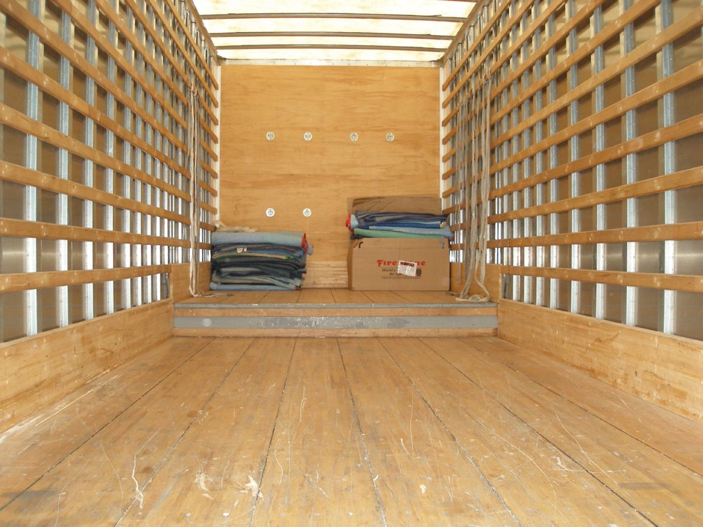

What location do you suggest to secure something as large and heavy as a farm tractor? Attaching a pic of the trailer interior.

guess she'll have to move her pole to the front. that's really where it should be anyway, with a row of booths up each side,tractor in the middle.
Something like a farm tractor would be best to the floor. I never put a tractor into a van! Adding a false bulkhead to have the front tires ride against would be added insurance in a panic stop. That could be figured out once the weight distribution of the load is set.

I was talking about wall-mounted. As Vision said, you can use E-Track bars (think load locks for E-Track) and create a second deck over floor-loaded freight, as long as its not too high and drastically changes the trailer's COG........Jevic did it wall-mounted for this very purpose. Was great for lightweight freight and theoretically if you did it right could double the usable space in the trailer. I only saw floor mounted E-Track once and it was counter-sunk in a "trench" in the floor.
Ken I have never loaded anything wheeled into a van before...But its not impossible. If it were me, I would either pull or back it in, with the heavier end tires/wheels butted up against the rise for the forward deck. Then I would put it in gear and set the brake of course, and then use the E-Track bars placed against the front of the tractor, with blankets or something for padding. Then maybe a few E-Track straps placed strategically for additional tie-down. Now I see why you would want floor-mounted. I know E-Track straps are strong but personally knowing what I know from towing I would want to chain down anything with wheels- hence a flatbed. But thats me....
Oh and I would do two or three rows of E-Track right up the length of the trailer walls, in between the wood slats, and smash-riveted to the posts (not pop riveted.) Lots of work but well worth it.

Ken,the "drop" in the trailer is a natural stop for forward motion in your trailer,i have loaded everything from farm tractors to boats on trailers in a moving van.Without ever using floor mounted E-Track,MOST cargo can be easily secured with a good set-up of vertical E-Rails,as FWD said,what we called "decking bars" in the moving business (think load locks) can be locked in place behind something such as a car or tractor and secured with straps to stop rearward motion. Or a nice set-up of welled (sunken D-rings) can also be installed in the floor without any useable space lost,and they will bear a LOAD of weight with no problems as long as they are backed up with some flat-plate steel....................................Mark
