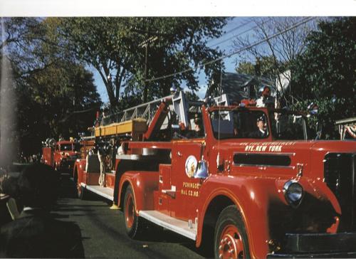

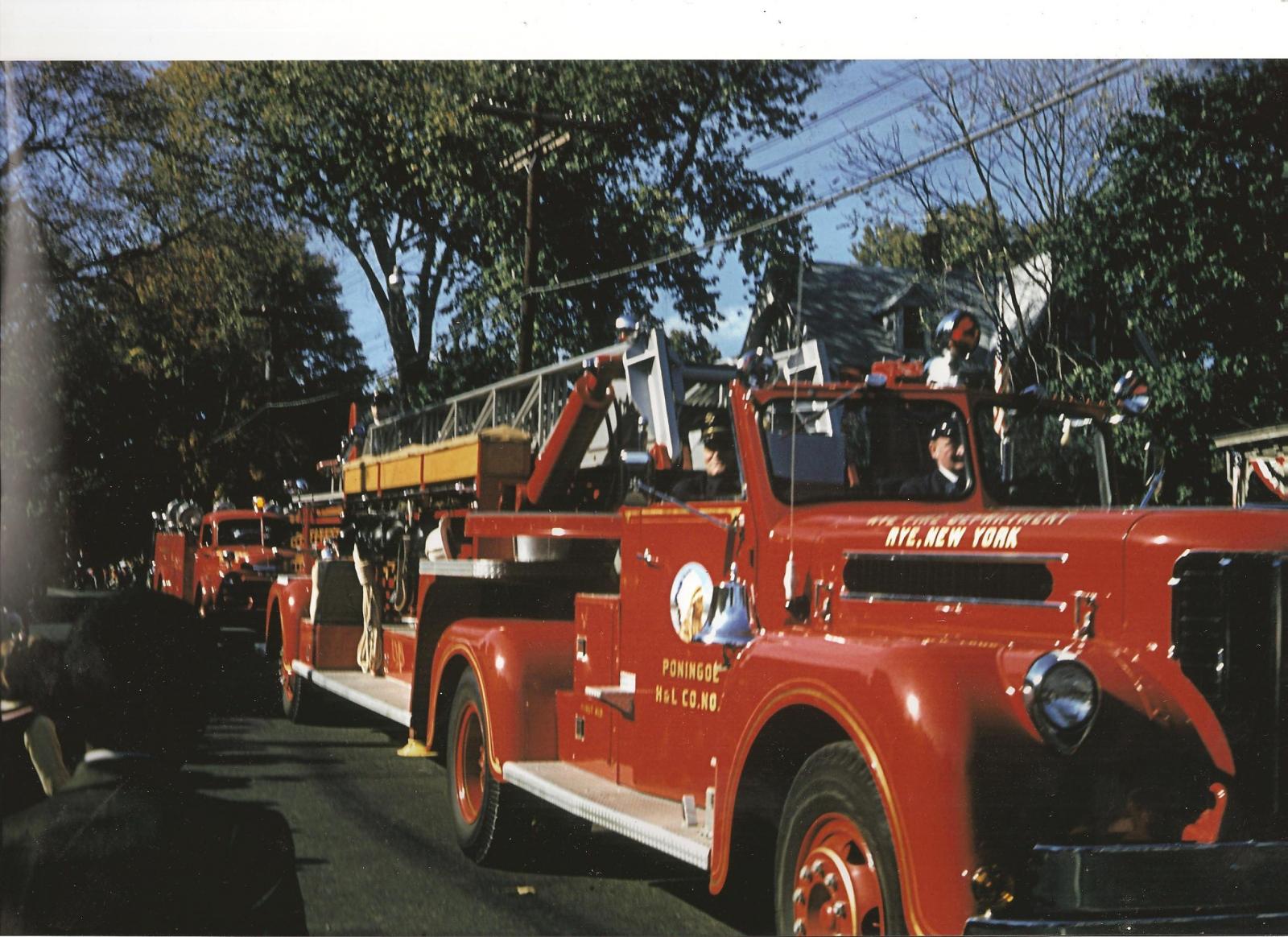

A friend is trying to separate the tractor from the trailer of his 1954 Maxim aerial. If anyone has done this we could use some advice on what to look out for. Specifically, what is the best place to jack the trailer?
