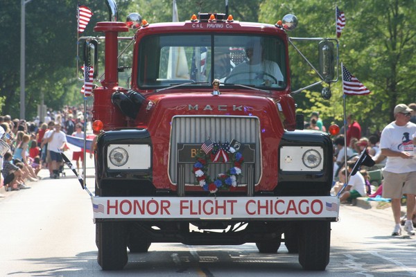

Ernie,
My cousin had 2 '69 DM's with that trans in them.A buddy of mine has a real nice '68 R685T ,also with that trans. Al post-510-0-00534300-1369796424_thumb.jpg
