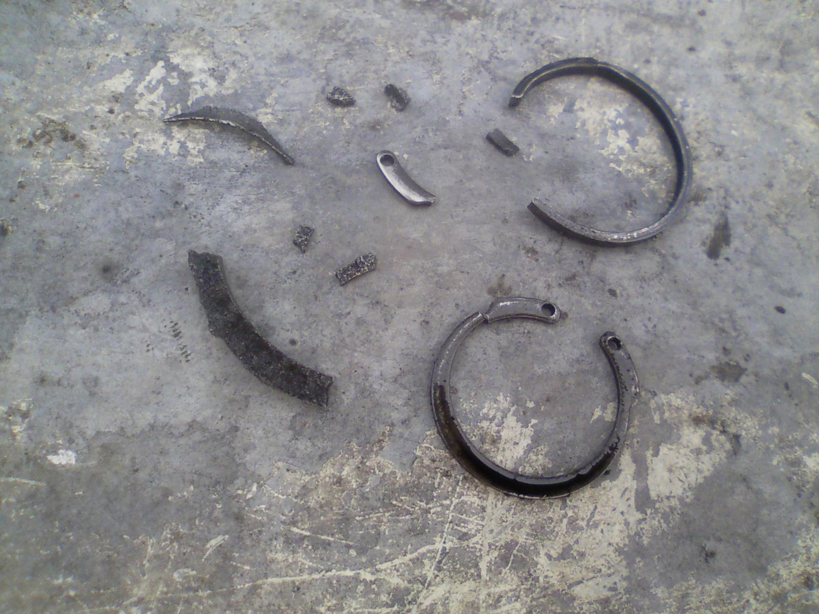

When I blew the turbo, I changed the oil. This is the first oil change since then...and I found a whole bunch of stuff that shouldn't have been in the oil pan. Now I'm HOPING those are just pieces of the turbo that have washed down into the pan...otherwise, it's gonna cost more than I've got. Anyone recognize these pieces? Am I on borrowed time? Or are they just remnants of the blown turbo?

For what it's worth, I flushed out the pan with a gallon of clean oil about a quart at a time to get the last (I hope) pieces out. Might pour that clean oil back through again just to be sure...hate to leave stuff in there if I can get it out.

I'm still hoping those are turbo bits & pieces...I changed the oil when I put the new turbo in after the last one blew up. This is the first oil change since then.
I hope I'm wrong but those snap rings look like the ones that hold the wrist pin in the piston
That is what I thought. What is the diameter of the ring? The big piece in the lower left kinda looks like part of a thrust bearing.

The snap ring is from the turbo. t holds the floating brg in the housing and also you see another ring there which is the seal ring on the exhaust side of the shaft.Well there will be a seal ring on the inbtake side as well. So stop worrying cause if it as wrist ping ring you would already heard a chunk chunk.

I had all of that apart about a week after the turbo blew when I was changing the exhaust manifold gaskets...didn't see any obstructions.
The turbo outflow empties directly into the fill tube, which is a straight shot into the pan....no narrow passages to be found on that journey to the pan.
How do pieces that large make it down to the oil pan?
Most Turbo drain lines go straight to a return passage in the block and straight to the pan and most of them are at least .5"id, you owuld be amased what will get thru.
They came out through the drain hole. Some required a little effort, though. Quite a few pieces were stuck to the magnetic drain plug. One larger piece was wedged into the hole and I had to go after it with my finger after the oil had finished draining. I got another piece or two out while flushing it with the first gallon of clean oil...second gallon did not flush out any additional pieces, so I put the drain plug back in and filled 'er up.
I saved the 2 gallons of clean oil...figure I'll strain it and use it in the lawn mower since it uses/leaks quite a bit of oil anyway. No point in throwing out that much new oil...
Slide a piece of rubber hose over a telescoping magnet and go down the fill tube to see if you can fish out anymore pieces. The rubber will keep the sides of the magnet from sticking to the tube.
I know it would be a major PIA, but I'd drop the pan if it can be done in-frame. Than you can check the pick up screen for obstruction.
