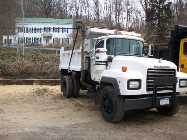

heres a picture so you can get an idea. Im going up to look at it on thursday he said its registered so I plan on taking it on the highway checking high speed for shimmy or shakes, also want to find some hills to stop/start on. Not sure what the front axle is the guy at mack was helpful but didnt really give me all the info i wanted.post-14964-0-82913900-1369188692_thumb.j
From here, that's a nice looking truck. Appears to have been operated with care (e.g. despite the age, the body's not all banged up).
With that body and wheelbase, the 12,000lb front axle would work. I'd rather it have the 14,300lb axle but its not a deal breaker.
