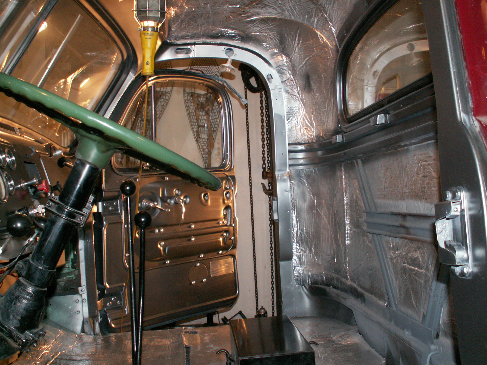

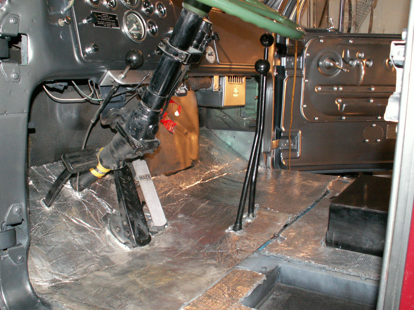

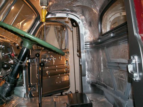

Last winter I took everything out of the cab of my 1988 RD686SX (seats, all panels, firewall insulation) took doors completely apart and then cleaned everything and then cleaned again. Then I installed Hushmat on every panel that I could get to and a new firewall insulation pad from Mack. I even bought a new National seat. What a difference in noise and insulation. I would highly recommend doing this. It took me about four days and $600.00 but was well worth it.
