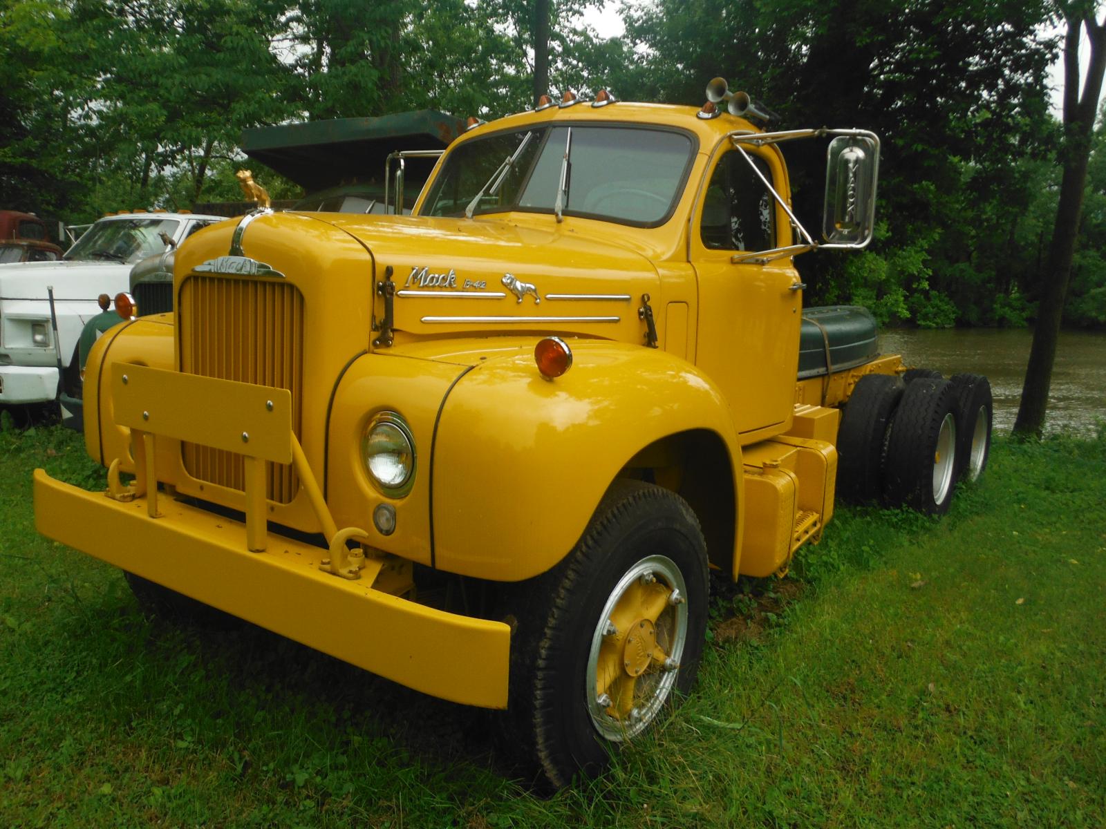

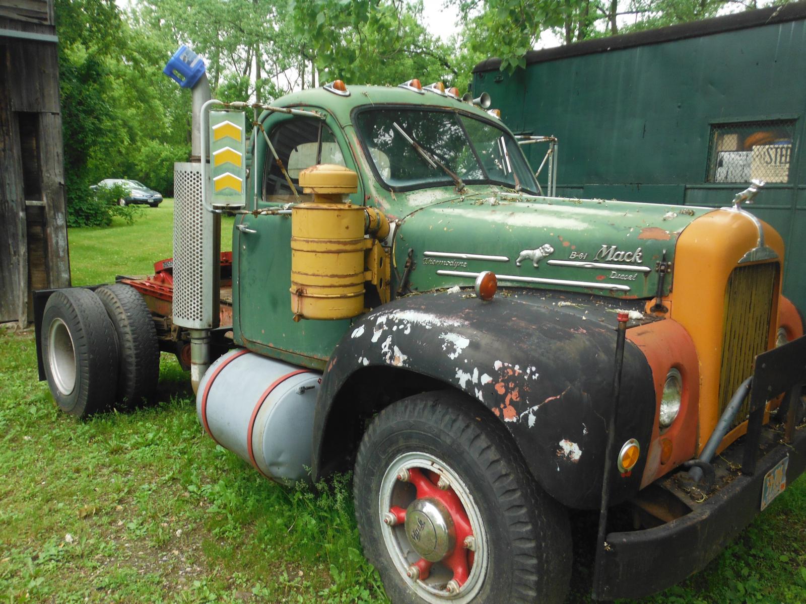

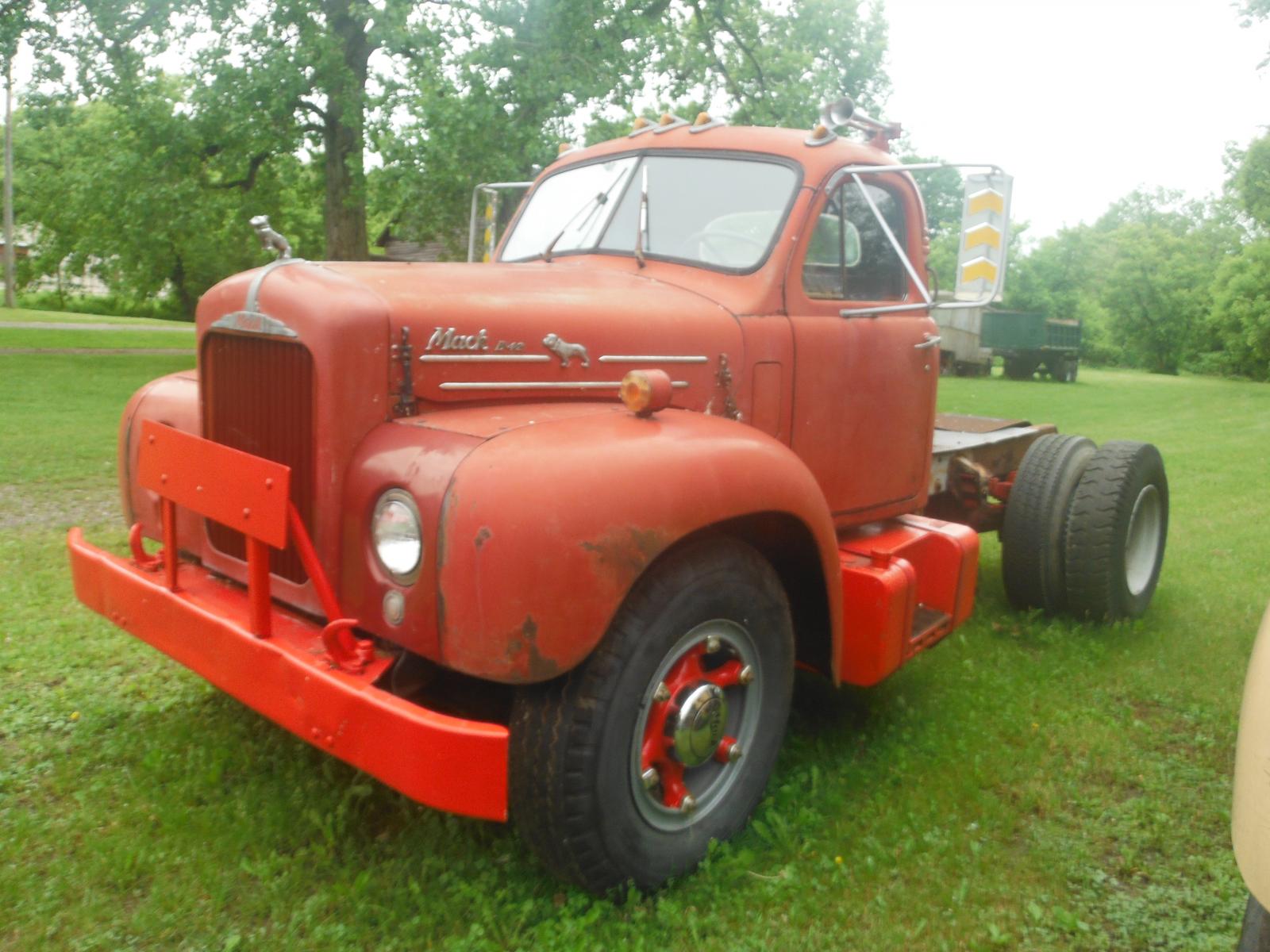

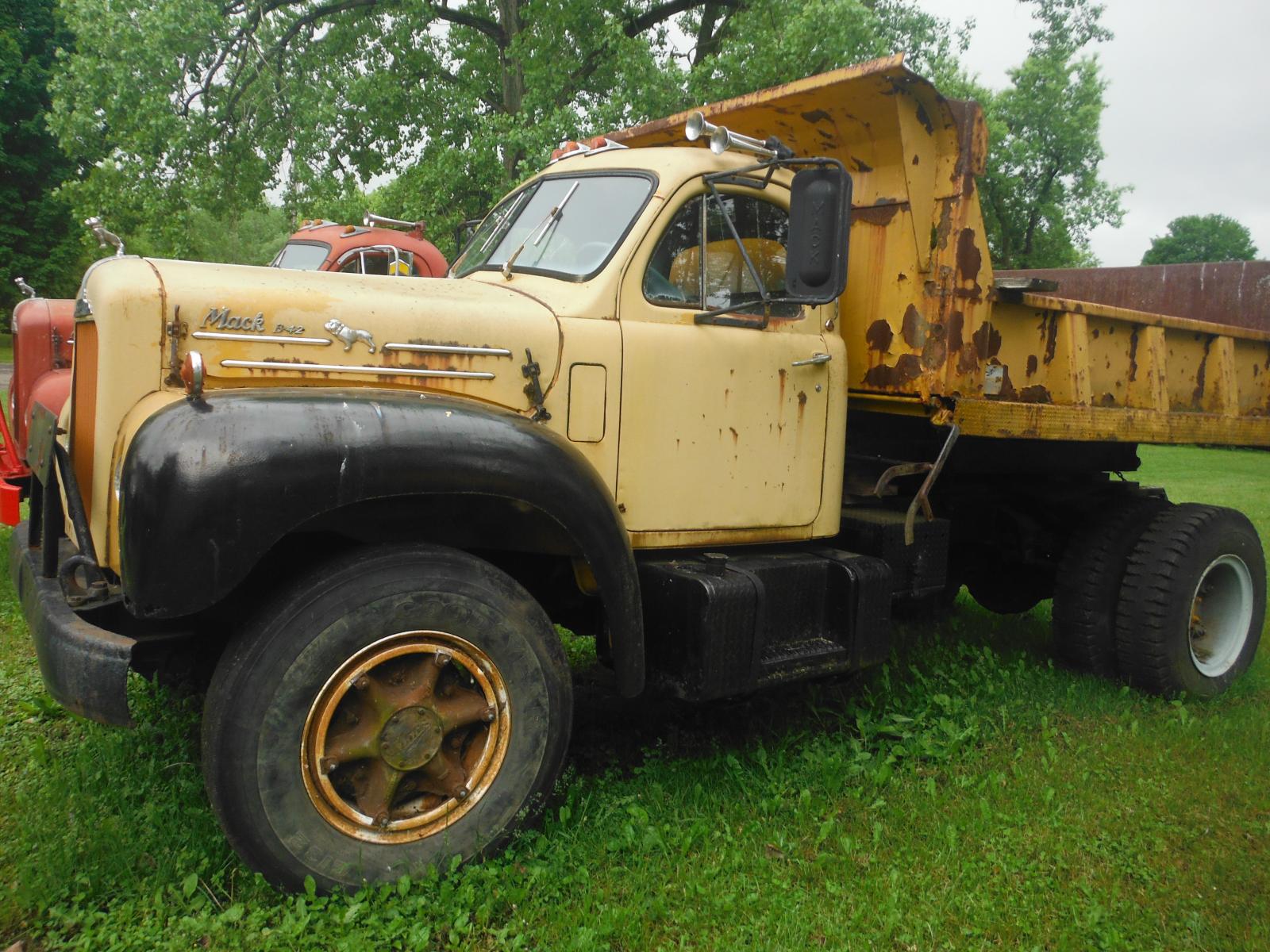

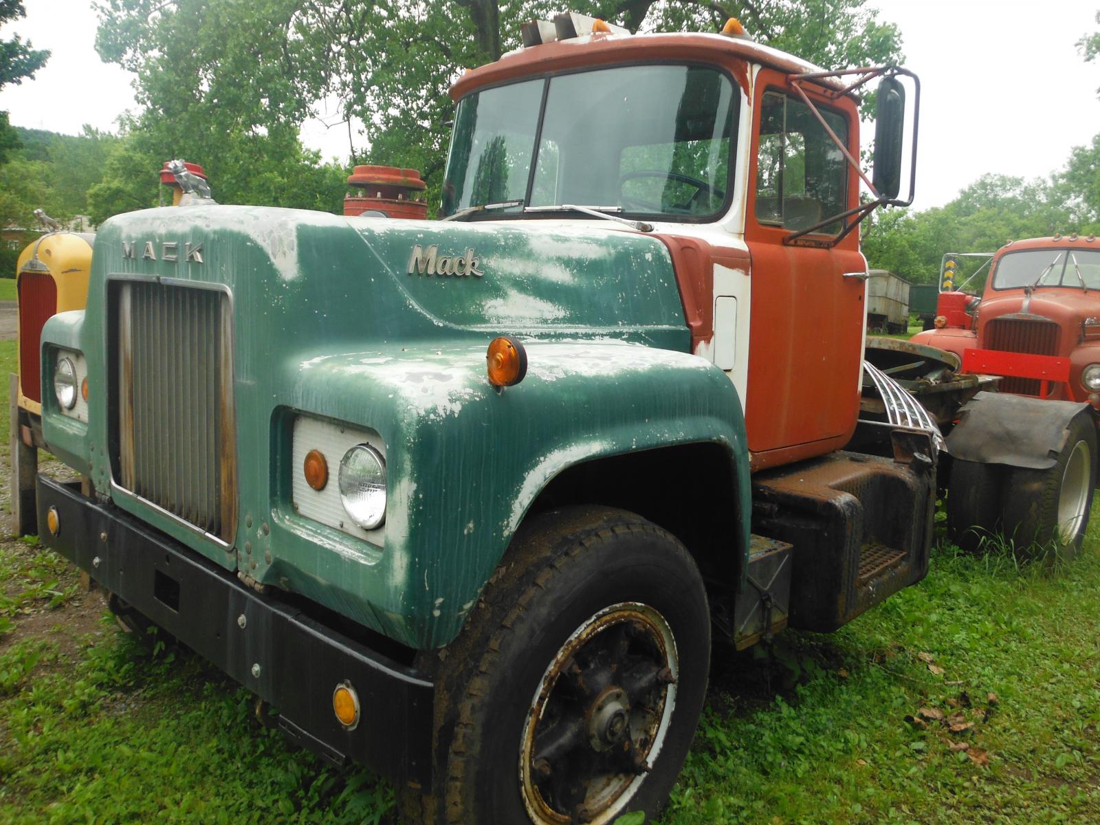

yup lots of stories and can tell ya where every part came from haha. the yellow tractor was actually a tandem dump we luckily got from out neighbor and saved from the scrapper, also got the light yellow one to but it was cut behind the cab so we put it on a single axle double frame and repowered it with a 673 and trd67 10 speed. the painted up yellow one still has a flathead gas and 14 speed baby quad. the red tractor I bought as a package deal, has a complete NOS nose on it fenders and inner fenders and hood, cab is a little rough. we repowered this with a 673 and 10 speed duplex also. no tow truck picture Vinny???? the R model is a 1966 and I repowered it with a 300+ and 10 speed roadranger. im currently lookin for a power steering box for it to fit the old style R model frame if anyone know of one. that's the hold up with that project. too many projects too little time and money but we have saved quite a few from the scrappers. going up to a yard next week to try to save a few B and R parts that these guys have about 6 trucks they are cutting up.

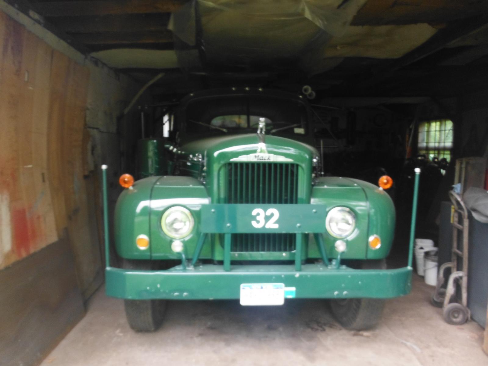

My father painted the fenders on Matt's B613T the week before Macungie. also that truck in the barn with "32" on the cow catcher was painted 29 years ago by my father. a lot of history down there. My great grandfather bought half those trucks new from Utica Mack. and every truck down there has a story behind it. Just too many projects and not enough time or $$$$$$
