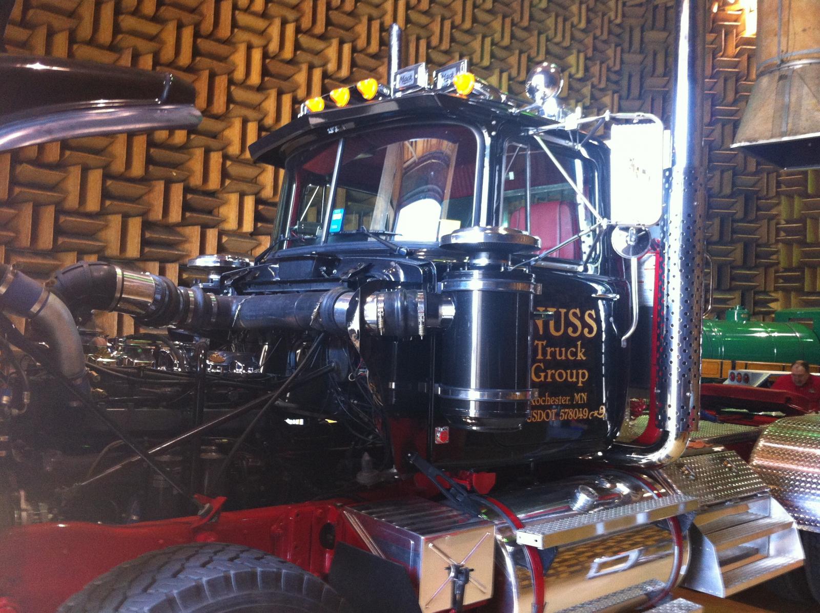

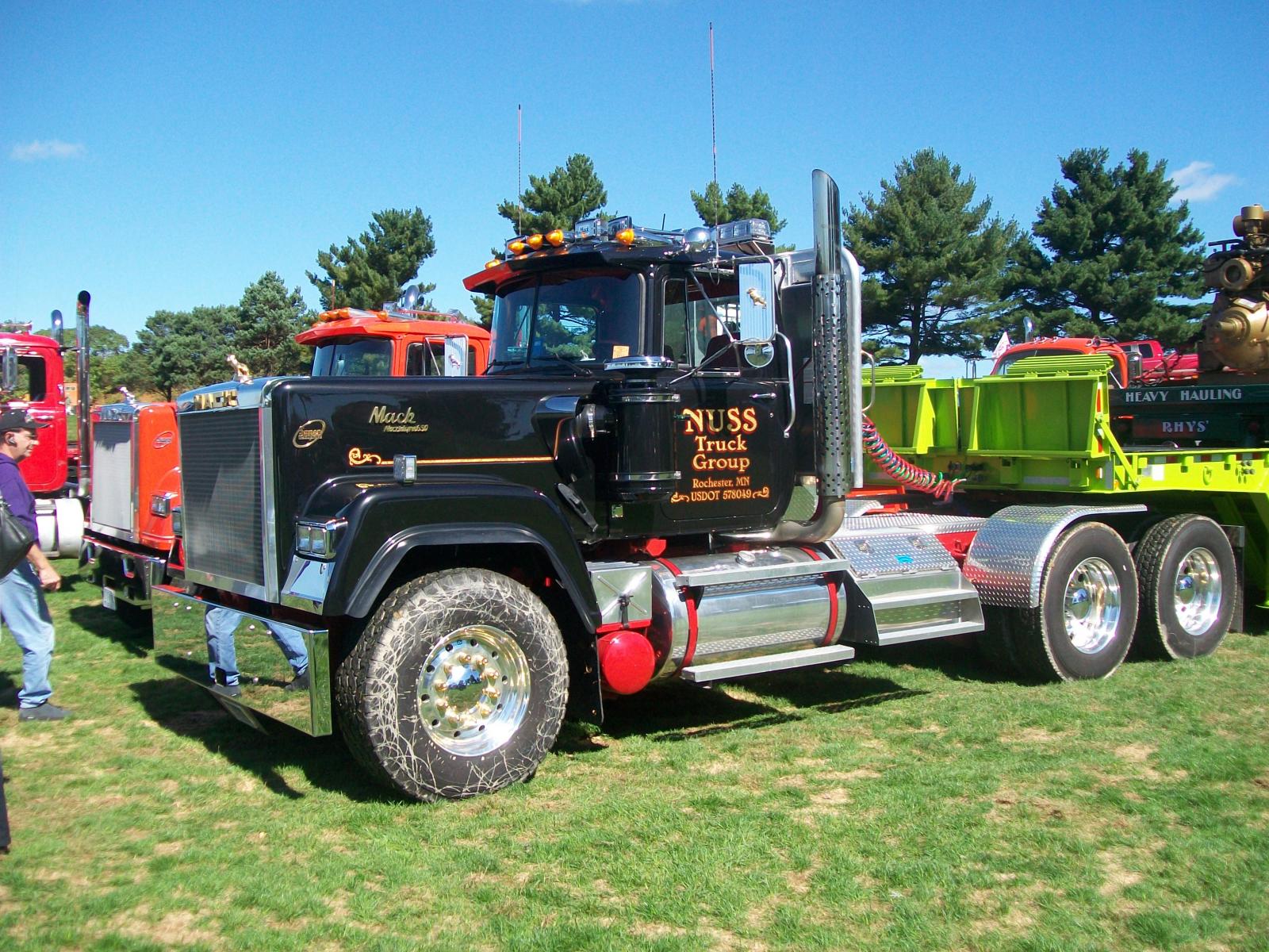

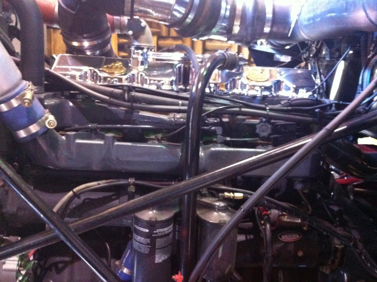

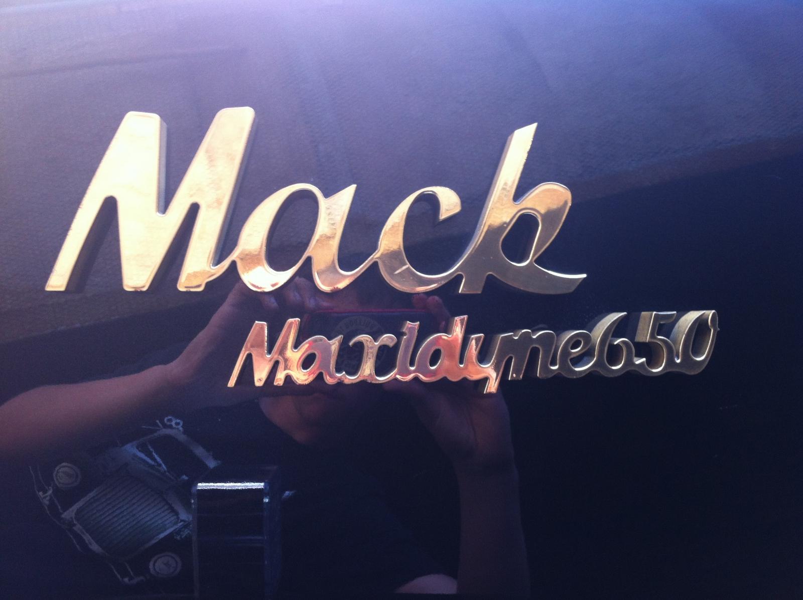

When I saw this at the museum, I was amazed. This truck is immaculate. When I looked at the motor, I see valve covers like a V8 would have, but it looks like a 6 cylinder? It confused me. Then I see on the hood Maxidyne 650. What's the scoop on this motor and truck? Specs? I have never heard of or seen a 650 Maxidyne so was it a prototype? It's obviously rare.

Well there aren't any E9 parts on that truck, that's an E7 mechanical engine. I have seen the Mack Big Six its a 14 liter six cylinder and there was only one "left" after early tests so says David McKenna Mack power train VP. That truck has a billet badge on the side of the hood made by Nuss Truck Group supposedly they built that truck and cranked it up then made the badges to go on the hood.
Hagerstown Mack built many engines for Merlin Marine that were ME7 engines rated from 600-800hp for use in marine applications. So building an E7 with a rating like that (if it is an E7?) is no real strech. The marine E9's were rated up to 900hp. All built by Mack and finished with stainless cooling systems by Merlin Marine in the 90's

The Mack Big SIx used E9 heads and pistons but not cylinder kits it was a long stroke engine not the short stroke of the 90 degree V8, Bill at Winrock Truck Parts had told me once the few testing engines were sold off to scrap and he had ended up with two but that they were not running and Makc had no parts to repair them so after a couple years one went to a Mack collector and the other to scrap and the only remaining complete Big Six is in the museum. The engine in the RW up top is an E7 look at the intake manifold and valve covers, Mack E7 engines were built for Marine and Industrial use in high horsepower variants and a big HP E7 could be made using those parts if you had the cash, same for an E9, there are E7 and E9 Marine engines over 750hp still in use today. The french army still has several E9 530/550HP rating engines in old APC's however I have been told they are no longer in use and are set to meet the scrapper so everyone needs to start makling cals and emails to get em back to the U.S. if we can. I have a Magazine somewhere with an AD for Mack Marine engines with pics and specs for both E7 and E9 engines Ill try to find it later.
