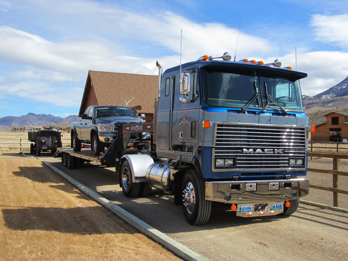

I have a 34ft. gooseneck trailer with electric brakes and I would like to pull it with my MH 612. I have mounted the controller, hooked up the ground, the hot to the battery and the blue wire to the trailer connector. Now it says to hook the red to the cold side of the stoplight switch or brake switch, not sure where that is, can anyone help, Rifleman

My guess is to see if the brake light switch is off the foot valve or perhaps by the frame rail? It may have an air line running to it. Use a test light and have someone hit the brake pedal to test if it lights up.
~ JT Burkard ~
AKA Sweaty Mack
  • Solution
If memory serves me correctly, if you remove the center console top (the ashtray panel) look down and to the right and you will
see an aluminum manifold.
I believe the stoplight switch is mounted somewhere in that manifold.
Ron
