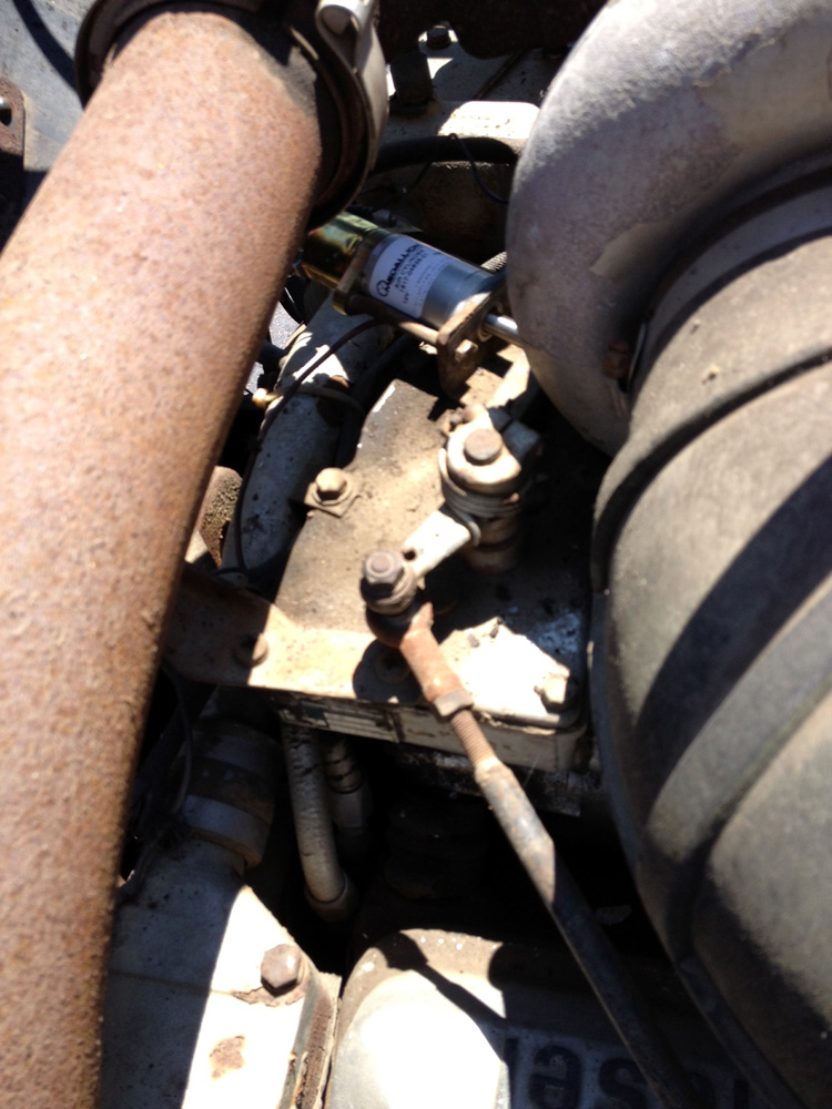

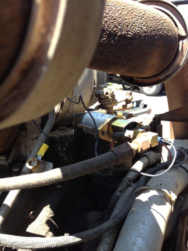

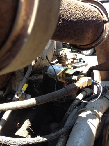

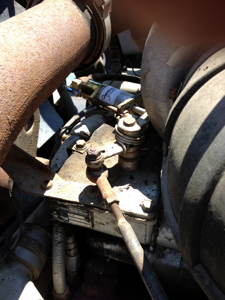

I figured I would post this here instead of my General thread. I replaced the Kysor shut off and now its not even firing up. The moment I crank the engine over, the piston extends and shuts the lever down. My old one had let the truck run for about a minute or so then it would shut down. Or if I raised the idle, it would shut down.
I installed the new, connected the power lead to the one side. tried it and it shut down. I grounded the other side, and the piston is still extended. I switched the leads to see if that makes a difference, no change. I am baffled! Here are pictures of the set up:
post-11944-0-92671300-1371658209_thumb.j
post-11944-0-20436600-1371658211_thumb.j
post-11944-0-15696500-1371658212_thumb.j
Any ideas you guys have, I would greatly apprecate it.

That looks like it is the fuel shutoff, not an air supply shutoff. My suggestion would be to install a cable to manually shutoff the fuel. Put a return spring to hold it in the run position. Give my friend a call. Maybe you can find a service manual.

JT - been doing some searching on the interweb. The cylinder/solenoid is definitely connected to the fuel shutoff lever. Are you sure the line is to be connected to the air/boost and not an oil pressure line? Glenn may be onto something. If the cylinder does not see oil pressure, there is no current flow and the solenoid will not energize or move the lever. Back the the interweb......
Ken
Is the hot wire connected to a solenoid or relay somewhere? Have you checked all the fuses?
Did you try charging the air line with compressed air to see if the solenoid actuates?

Air line is connected to air pump behind the engine. It will do this with no power wire connected. It seems as soon as it starts to charge the air, it actuates the lever closed.

for now just remove the air line and cap it, or remove the valve with line on... figure a way to manually move the lever to 'off' while you go about testing. If engine starts ok but the piston moves out as if to move the shutoff lever on the govenor housing then you have got a fail condition or an electrical short. I would not run for long without an oil pressure gauge to read, fuel pressure can be read by tapping into the spare 1/4pipe fitting on the secondary filter.

I have a wiring diagram already. It was in the truck when I got it. When I bypass the valve to fire it up, it shows good oil pressure, and good alternator charge on then dash gauges. I did check with a test light with the key on and no current was showing through the power wire.
