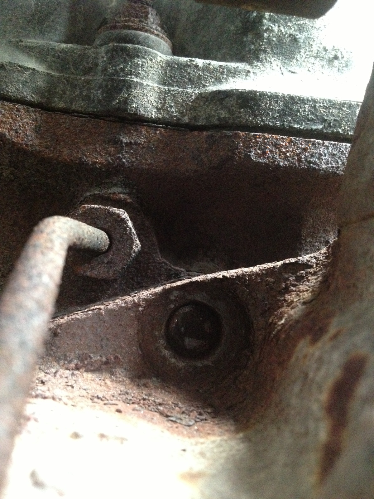

found one stud broken today on the exhaust manifold doesn't look like it's leaking but would this cause the smoking problem??? It would be a job to take all this apart for sure torch like every bolt and I'm sure nothing will come out of the headpost-15171-0-44085500-1374076646_thumb.j
There is a bulletin for the exhaust manifold bolts I can send you the link if you need it you change them to stainless studs and for the oil in intake pipe check your hose going to the air compressor there is a service bulletin on that to there should be a elbow facing towards the air filter if its not there or turned downstream towards tge turbo intake it will suck the oil out of the air compressor and send it through the turbo. Good luck
