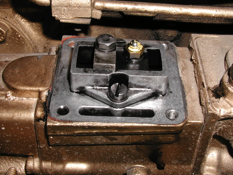

I read the other topic on how to increase the fuel but my pump looks different. I think it is a Bosch.
Its a ETAY673A 315 HP 1979, Max rpm under a heavy load is only 1900 and cruzing is 2100 I can only due 57 mph at
2100 rpm I need just a little more! The puff elemator works great and I have a bypass s/w on the dash for steep hills
The engine doesn't blow smoke at all.
Ok i opened the top of the pump and ????? New photo too!!
Thanks

I believe 1900 RPM was the normal full power governor cutoff with that engine, with no load cutoff of about 2100 RPM. You can probably adjust the governed speed up a bit, but the 673 is only good for about 350 reliable horses so I wouldn't up the fuel rate too much. BTW, is that an aluminum frame I see?
Hay scooter-I have the same motor in my 83 rd dump with a 12 speed mack tran, I'm not interested in turning up the fuel, that might give it more power but it's not gonna do much for the rpm, even with the puffer shut off there is no difference in rpm, I have the throttle screw turned all the way in so I can reach 21 or 22 hundred rpm with a load but the problem is it takes to long the hit 21 hundred, it fells like the govener starts shuting it down at around 17 hundred and then it's a slow climb to 21 hundred, it makes the truck run flat with no push off between gears if you know what I mean. I think we need to adjust the govener but I don't know how, does any one here know how to do it. I was even thinking of putting a different pump on it but not sure witch one would do the trick.Can any one here help us out.

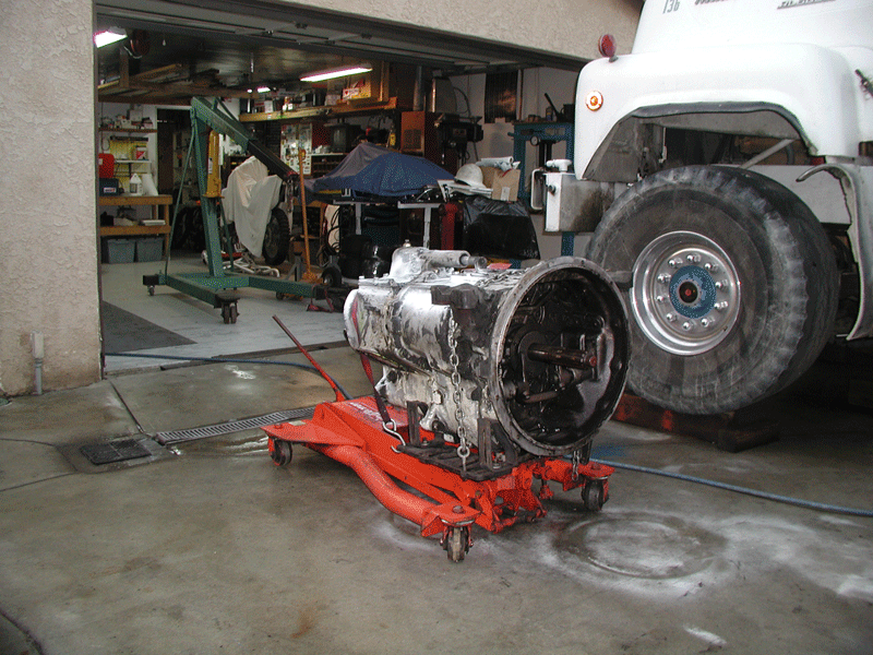

Here is a photo from 6 years ago when I put a new clutch in it. Dam that thing was Heavy :angry:

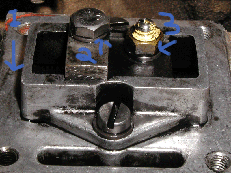

Thanks
The picture you had yesterday shows you have a robert bosch pump, there is a plug on the back side of the pump, take the plug out have someone turn the engine over by hand with the fuel stop out, there are 2 flat screwdriver ajustments on the goveneor half way around from each other. you have to turn them same turns on both sides, you have to use a long flat screwdriver through the exaust manifold, push down while you turn. i would go 3 turns to start with each one. i turned the rpm up on a 88 300 went from 1750 to 2200. hope this helps let me know. Ron
