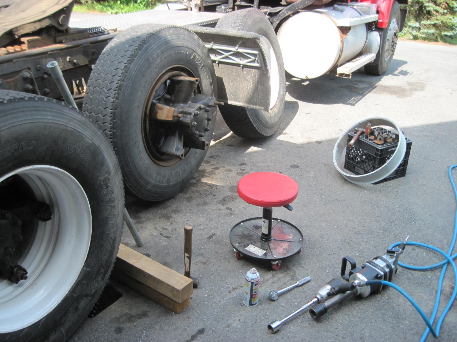

Hate'n on the dayton!

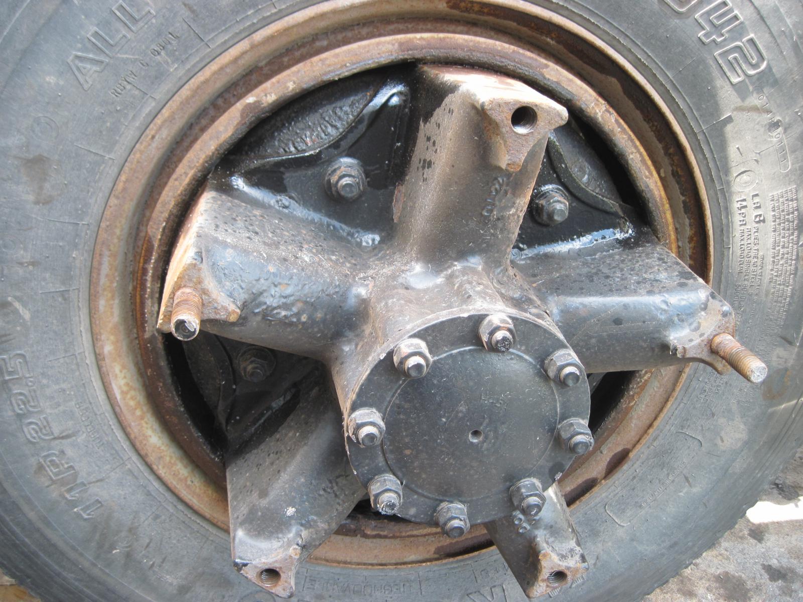

Picked the set with the most wobble to "true" myself...worked an our or so and couldnt get them true...realized the inner wheel was stuck! A can of PB Blaster, my biggest hammer, crow bars, even dropped the jack fast to the ground several times, didnt budge...will get a big sledgehammer from work and give it another go...I know the daytons on the rear are the classic East Coast look, but I HATE EM!

i would run a portapower from the rim to somewhere on frame or a bottle jack,of coarse spray WD or liguid wrench around the rim real heavy,,good luck....i really like the spokes myself,,,but yes they can drive you crazy,,,i used to work in a tire shop in the 70,s we could run them up true with an air wrench,,,but like these fella,s said...the average joe,,is better off doing them by hand...bob

take a grinder with a flapper disk on it and clean those spokes, put a few wedges back on and let it down, drive it back and forth a little, it will pop loose. and Mike is right, I only use an octagon bar with an old school tire iron wrench and can true them right up, of course I always put a PBR can on the ground next to the outside tire also. nothing wrong with spokes as long as everything is clean. its the last guy who put them together, didn't clean the threads or the spoke flat spots with a wire brush to remove the rust that's the problem. its the tubeless rims with the ridge in them I have trouble getting off a spoke rim when its on the inside. they have to come off perfectly straight cause the rims around smooth like a tube type. took me over an house before Macungie to get the inner tire off my B model to paint the rim.

Tried again tonite...brought home a big sledge, could only beat on the tire...with the airride, I cannot get close to hitting it on the back side! Drove it back and forth a little, even spun the tire with no wedges, spacer, etc! Plenty of PB...No luck...will borrow a porta power from work, give it a shot...The PB blaster seems to be soaking in all around each spoke, don't know what is holding it on!
