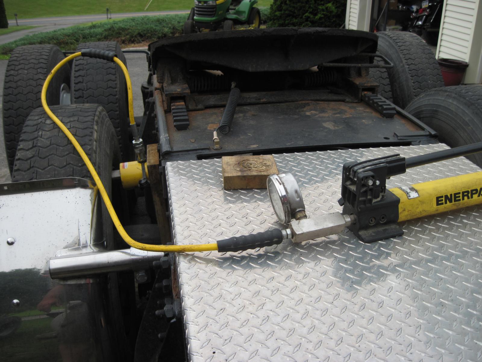

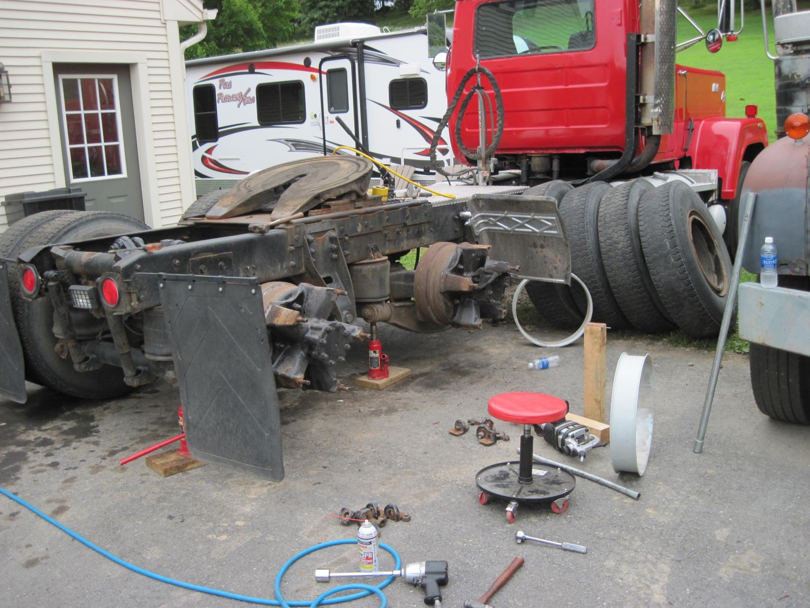

Im sure if they put those rims on with a big impact that's why they were stuck. They forced them too far back with the gun...
They were rusted solid! On the pass side only...I have seen a picture of that truck in a machine shed...maybe that side was close to the weather?!?
