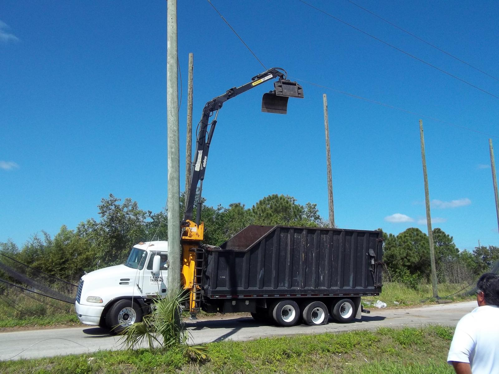

Freighttrain-I hit a power line. remember dontcha?

Are those lines behind the truck too?
In the first pic? no. That is a catch fence at the landfill.
Please appreciate the flat tires. All 10 on the ground were shot
Cut the neutral, got caught by the 7000 line
Y'all gonna start dragging my history back up?
No problem-I effed up big. I admit it. Change in procedures and double check/triple check before I move
First,everyone screws up, big or small, noticed or not, shit happens, part of the game
Second, not trying to hijack your post, just started typing....
Hooking hydro lines is one of my fears. I once pulled a cable tv line down, not hazardous, but frightening when all I saw in the mirror was cable whipping around behind me. That was the last time I took someone else's advice on directions. I make a point to have a good look around on sites for overhead anything, may look kinda dumb, me stopping and standing on the steps of the truck staring at what appears to be nothing, but that's a chance I don't wanna take. We had a guy (a "hotshot" to be polite) last summer driving the old bitch when we went to a house the owner of the company I work for rents to university students. We went over to clean it out on a rain day, and the driveway was tight for a 30yd can, but it would fit. Well, captain rammy neglected to heed my advice about the hydro lines coming from a neighbouring house and hooked the insulated part of the wire and started to pull them out before he saw THREE of us waving and yelling that he was caught....Had he dropped in 2' further back,like I suggested, he could have set it down and not come near them. But hotshot oil patch heavy hauler "knew what he was doing". Point is, he didn't learn, and that's my definition of stupid.
