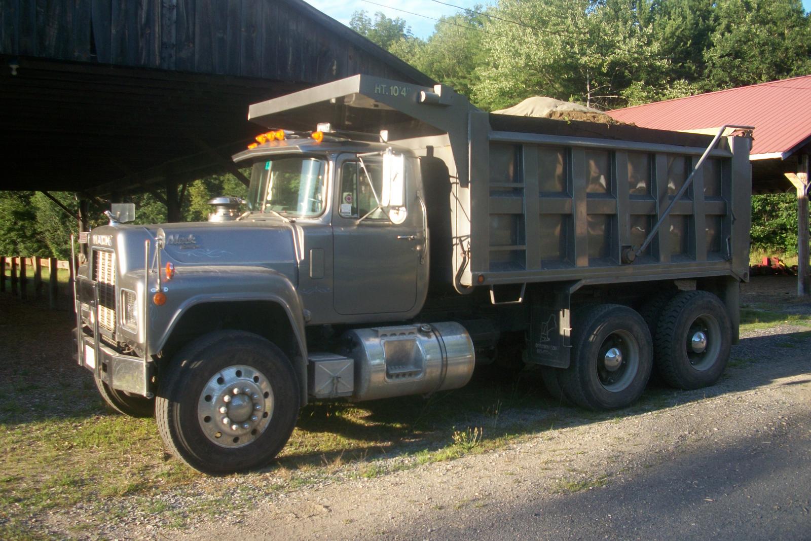

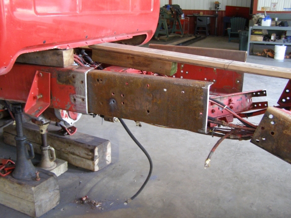

I hav e a friend who has a super clean 89 RD-688 dump. 18 front 55 rears. Problem is frame rails have some big time cracks. ahe has a quote of 20 grand to replace both rails. Alternative is to cut the outer rail at back of cab (at 45 degree angle) and have Adams from Vt. punch new rear sections and weld in.
Any opinions. They did rails for a friends single axle B-81 and their laser drill job was right on- no reaming of any holes.

P.G. Adams does very nice work from what I've seen.There was a post on here some months back,of a guy that did just that(outside rail replacement) to a red RD dump chassis.Looked like he did a nice job on it.post-510-0-05796700-1374632314_thumb.jpgWe've got a local welder around here that does the 45 degree thing on all his stretches & repairs.I have never seen any of his frame mods,come back for warranty work.

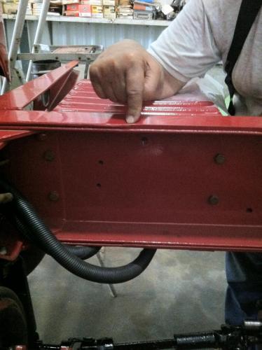

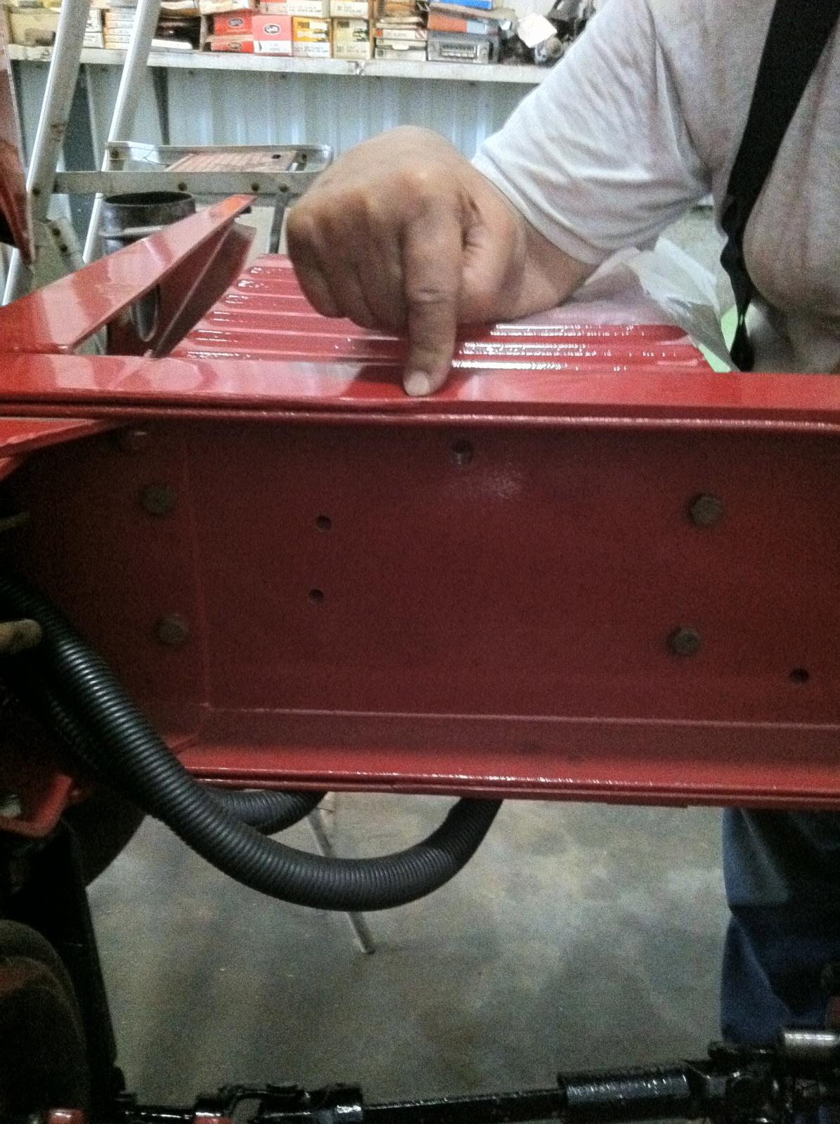

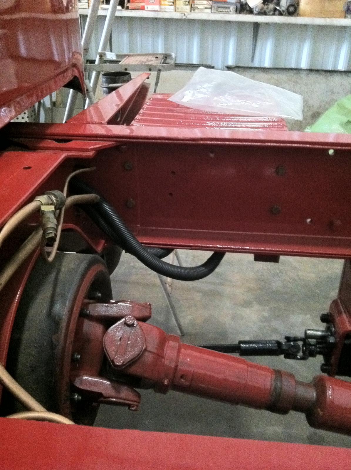

Guys- thx for your responses. Couple of comments- fish plates to me are band aids- rail replacement is a permanent fix without adding dead weight to original vehicle. Glad to hear comments on the 45 degree cut. I think my friend paid around 3000 for the single axle-would imagine a tandem would be close to twice that??
Attached are a couple of shots of the B-81 in progress. The "finger " is pointing to spot on outer rail where cut started.
post-1625-0-50721900-1374634760_thumb.jp
post-1625-0-40516300-1374634782_thumb.jp
post-1625-0-29604300-1374634823_thumb.jp
https://www.bigmacktrucks.com/topic/32035-frame-repair/#findComment-195599

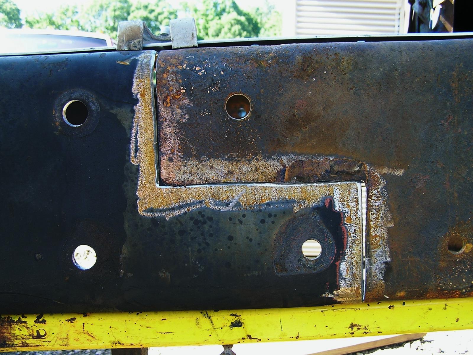

Pg Adams are good people to deal with. The frame rails I've replaced have been "z" cut and stagged from one side and another. This was for dm tri axle mixers that had 58k rears and were loaded heavy on a regular basis. A fish plate in my opinion is temporary fix for a problem that needs dire attention. 20k for a fix might sound high but think of all the labor that goes into that not to mention the the cost to replace such a truck with a new or used one....

Agree on the 20 grand and the labor- but that is the 64 dollar question. Replacing complete rail you have all that labor associated with the cab, motor mounts etc. Putting a section in cuts out in my viewe a ton of labor-granted you are cutting the frsame rail with a cut-off wheel and have the weld time but it has to be less.-I would think.
https://www.bigmacktrucks.com/topic/32035-frame-repair/#findComment-195608
Consider a step cut. More weld equals more strength. You can also straddle the splice with a cross member.
Always heard good things about Adams. You can use the old rails as a template to drill the new ones. Clamp the opposite rail outside to outside and drill only the symmetrical holes. New rails from Mack are going to run 6 to 10K. That's why the estimate is 20K.

We ordered rails from the guy in Vermont for an L9000 log loader, exactly what we needed, nice work from them. Pix of the truck and how much of the frame need to be replaced would help. I have done replacements from the cab back before and it is not a bad job.
