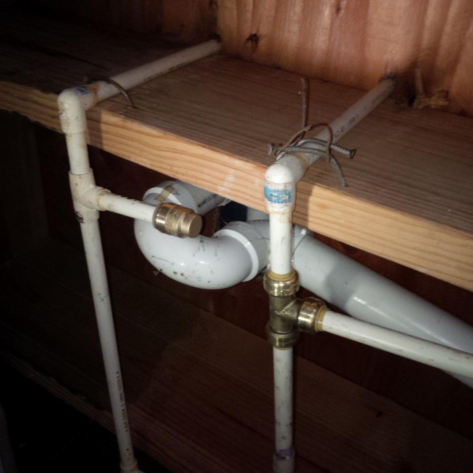

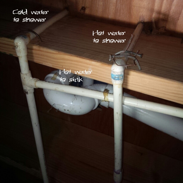

...and a month of listening to my beautiful bride-to-be complaining about the lack of hot water at the sink in her bathroom, I FINALLY crawled my ass through the tiny little crawl space across the gravel "floor" only to find this. I REALLY wish I would've fixed this 9 years & 30 pounds ago. Guess I get to run to town tomorrow...I have a "T" to splice the hot water line to the sink into the hot water line to the shower...but don't have any way to plug the opening that will be in the cold water line after I move the hot line to where it should have been to begin with.

Gator Bite all the way, since I moved into my new to me house I have become familiar with plumbing, I keep a stick of copper and several gator bite push lock fittings in the house now.
gator bites are what the guy at Lowes gave me when I was working on a leak in the pipe going to the hot water tank. I thought no way this thing's going to work, but it never leaked a drop.
I had a shark bite T at the house...but either needed a straight through fitting so I could cut out the old T or a plug to seal off the line after I cut it off from the cold water supply...hitting Menards in a few after I drop her off @ work.

Yup...hot & cold are backwards in her bathroom...next time I have the water shut off, I'll flip the flex lines under the sink around to correct that. I just went for the easiest fix under the house...didn't want to make the job any more complicated than absolutely necessary. She seems happy enough with it for now...and that's all that really matters.
