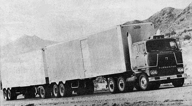

A prototype gas-turbine power unit for commercial truck use has been unveiled by the International Harvester Co. of America. The unit is installed in an International CO-4000 6x4 tractor designated the “Turbostar”, and shown as part of a "triple-bottom" combination—an artic hauling two further semi-trailers converted to drawbar units with dollies.

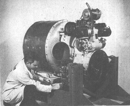

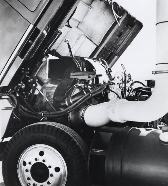

At 1,585 pounds, the gas turbine in the Turbostar weighs about half as much as a comparable diesel. The basic engine is 50in. long, 41in. high and 36in. wide—compact enough to fit under short-dimension tilt cabs. Turbine speed is 34,000 rpm, this being geared down to 4,000 rpm at the output shaft.
Among the important features claimed for the two-shaft, free-power-turbine engine is its stationary heat exchanger. This is of the recuperator type which takes waste heat from the exhaust to improve fuel economy especially at part-load operation. IH selected the stationary recuperator—rather than a rotary regenerator—"because it is inherently rugged, has low maintenance and is highly durable". Work on fabricating stainless steel parts (such as honeycomb structures) solved the problem of high efficiency in a compact stationary heat exchanger and it is said to be the first practical design for a stationary heat exchanger integral with the turbine.
Other features of the power unit include variable-geometry nozzles which are reported to have brought fuel economy of the turbine much closer to that of a diesel.
