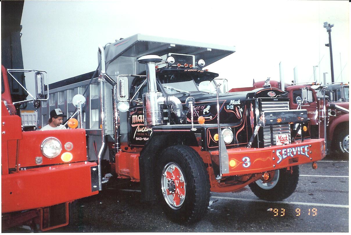

I know a 237 is a common and fairly simple swap in a B to gain a lil more ass over a 673, but I seen one truck (tandem white and grey B61) last year at the ATHS meet in Springfield and should have gotten more pics and looked things over a bit better but I didn't. too much to take in haha. so who here has put a 300+ in a B model? what did you do for trans mounts (definitely need a double disk clutch over single)? hood scoop is easy. what'd you put behind it for a trans? reason I ask is because I've got a line locally on a strong running 300+ with a twin stick six speed for a steal out of a DM. any and all input is extremely appreciated. I know a 237 is a much easier swap but a 300+ in a single axle B would be pretty bad ass. plus for the price it's hard to pass up

I have seen B's with twin air cleaners.Left and Right mounted.One for the engine (turbo), and 1 for the tip-turbine.Also have seen just 1 air cleaner and a K&N style on the tip-turbine. b61mack (Ron) has a very nicely done B-61 with a 300+ and 13 speed Road Ranger in it!
yea but the hood scoop just looks cool haha.
The scoop would look cool. Also some guys run a intake under for the tip turbine too. I guess there's a bunch of ways to engineer it to make it work in that tight space on a B. Matt Pfahl has the 2 valve 350 with the dual air cleaners and a 2 stick 12 speed and Jake!

Before you get this engine,you better check the numbers on it,because I'd bet a 18 pack of Coors Light it's just a regular old ENDT676. The 300+ was not built to be used with a 5 or 6 speed.
well mike if it was an 18 pack of pbr you really would of had my attention. I looked at this dm two or so years ago and was told it was a 300+. no hood scoop but it does have a dual tube air cleaner. when I looked at it and opened the hood the bees (no pun intended) were flying around so fierce that I slammed the hood and walked away. I couldn't get the hood open all the way because it had a hillbilly cow catcher that was bent every which way but sunday. I tried looking behind the pump to check the numbers but had a hard time in the circumstance. I was told it was a 300 +. my biggest concern is trans mounts for a double disk clutch. I don't want to have to build a truck from scratch like my brother did with his 66 R600
