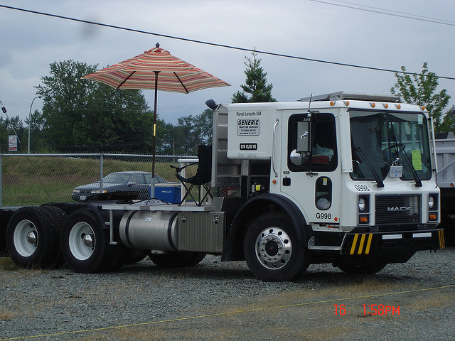

There is a truck already like that from out west or Canada with a sleeper on it. I saw it on Hanks Truck pictures I think or Flickr. It was white. Drove a MR once as a chassis. Was delivering it from H And H Mack to Leach in Paramus NJ. Had 58 rears 300, Jake and a 6 speed just high low reverse. Was good vision I liked it except for the fact I banged my head on the ceiling a few times going down Rt 80. LOL

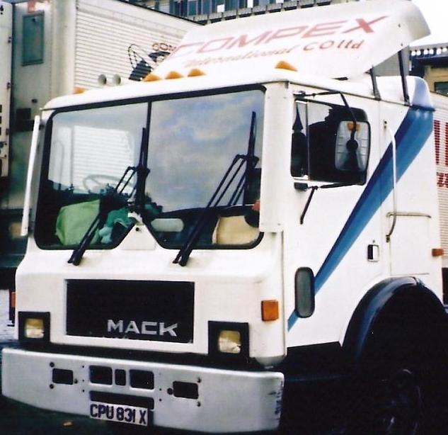

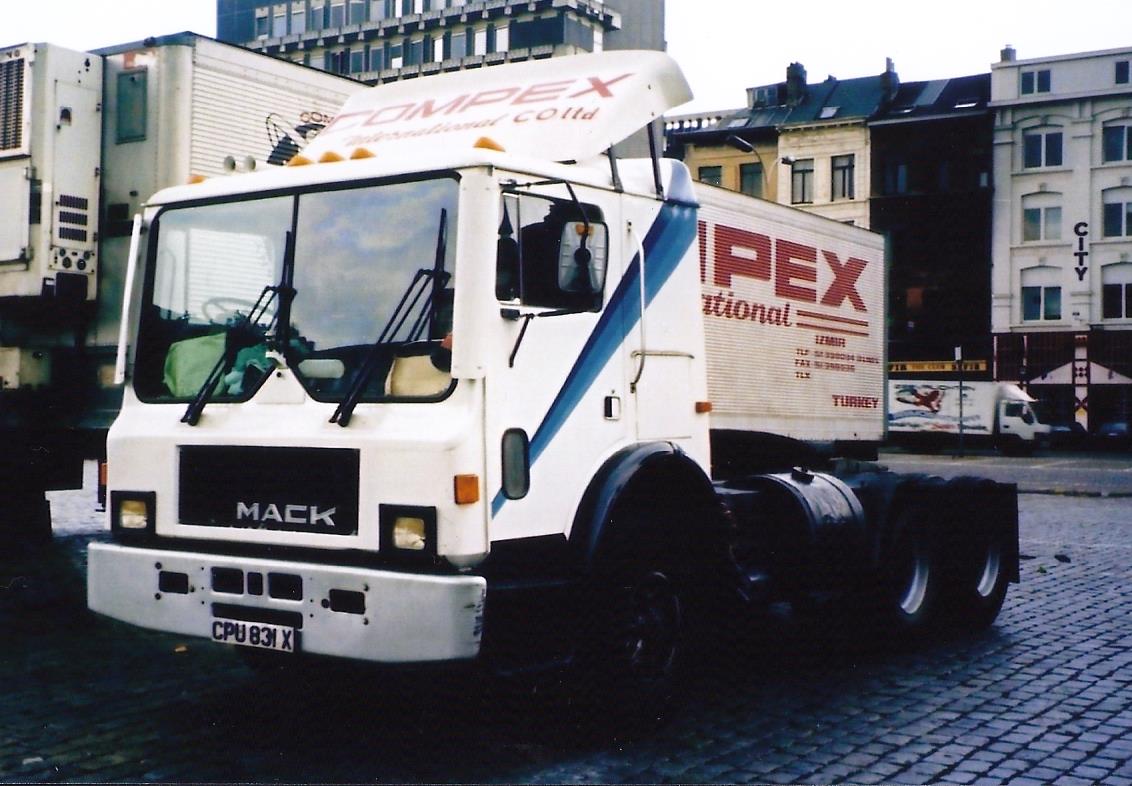

Rob,is this the one you mentioned? I saw this up in Calgary a few years back,and never figured out whether that actually was a sleeper or not?.........................................Mark
That's it Mark thanks I knew I saw one somewhere.
thats a cool rig,,,but i think its too small,for a bunk...bob

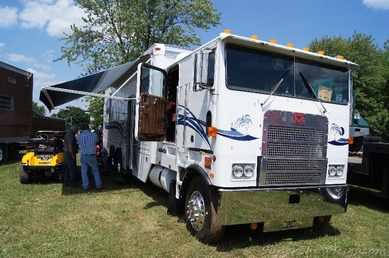

The guy with the Marmon motorhome (Ray Keens),has a boot between the cab and the camper unit.He has to be able to tilt the cab for service (of course). Someone on BMT must know him as he is usually at Macungie.He is a decent guy and could steer you in the right direction.post-510-0-11935100-1375760664_thumb.jpg

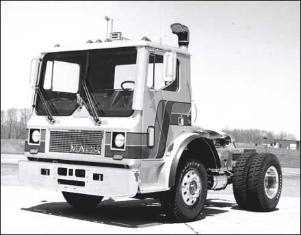

Thanks for the info. The foreign MC is funny lookin especially with the "R" model bumper.
All MCs, including the U.S. domestic market, came from the factory with what we at Mack call "corporate type" bumpers. Remember, the MC had a much lighter frame alike to the R-model (same 9 x 3.25 x .25" cross section), whereas the MR was altogether heavier like a DM.
The Mack "corporate" (R-model) bumper was standard on the MC, both domestic and export, because unlike the larger MR, it was based on the R-model.
It was intended as a replacement for the MB 4x2 city tractors with customers like Overnite and APA, but then they began using the night time route tractors for daytime city delivery to reduce costs.
