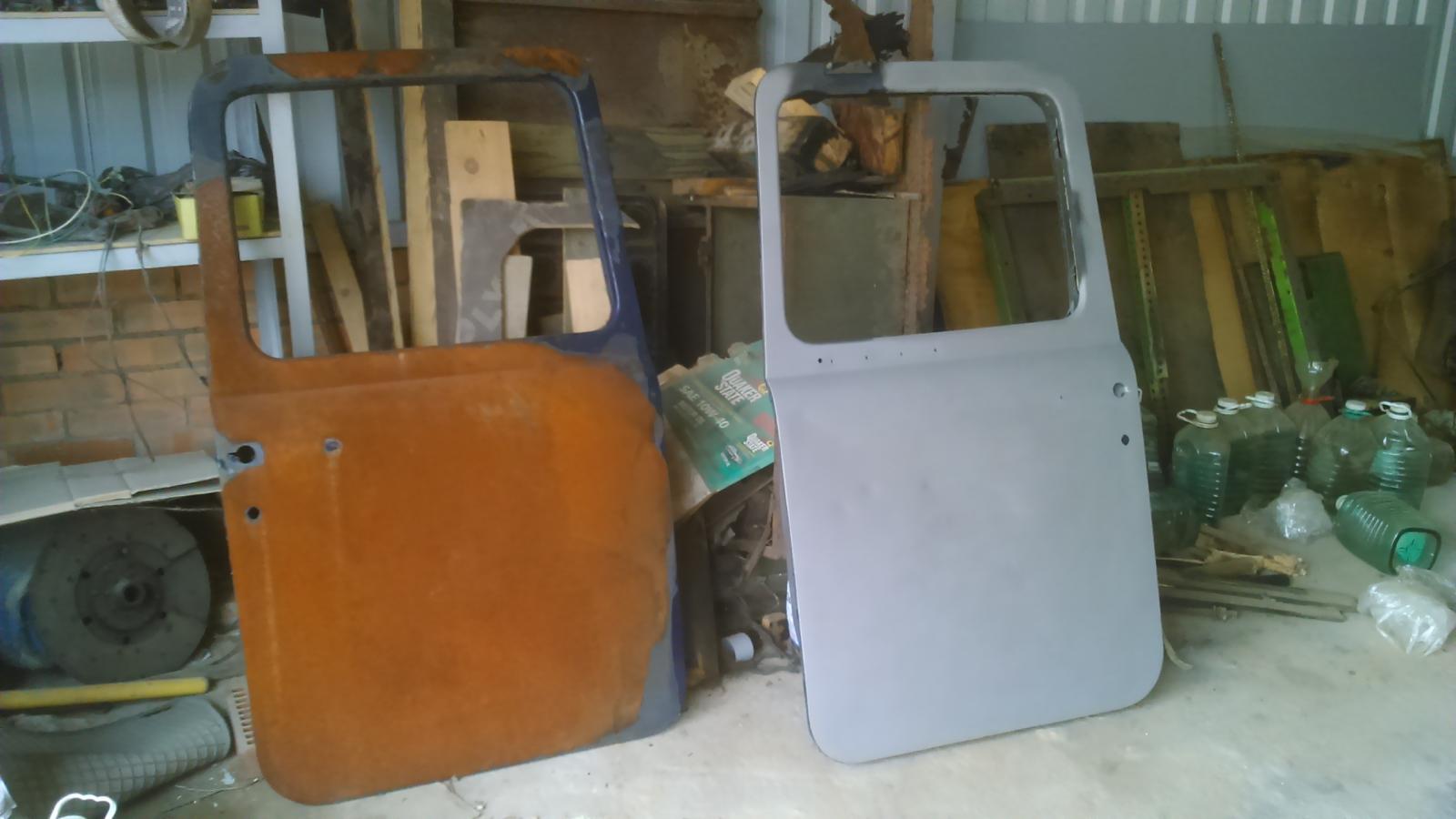

I work together with my "blast guy". He wears a full dress with helmet and can't see rust perfect through his glass.
So he makes blast and than I comes close to check out. Make marks with a piece of chalk and he repeats there. Up to 4 times to get it clean completely. I was told you can easily deform a car's roof or hood (bonnet). With Mack R-model parts I had no issues so far.
post-3971-0-65719800-1452461175_thumb.jp
