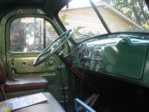

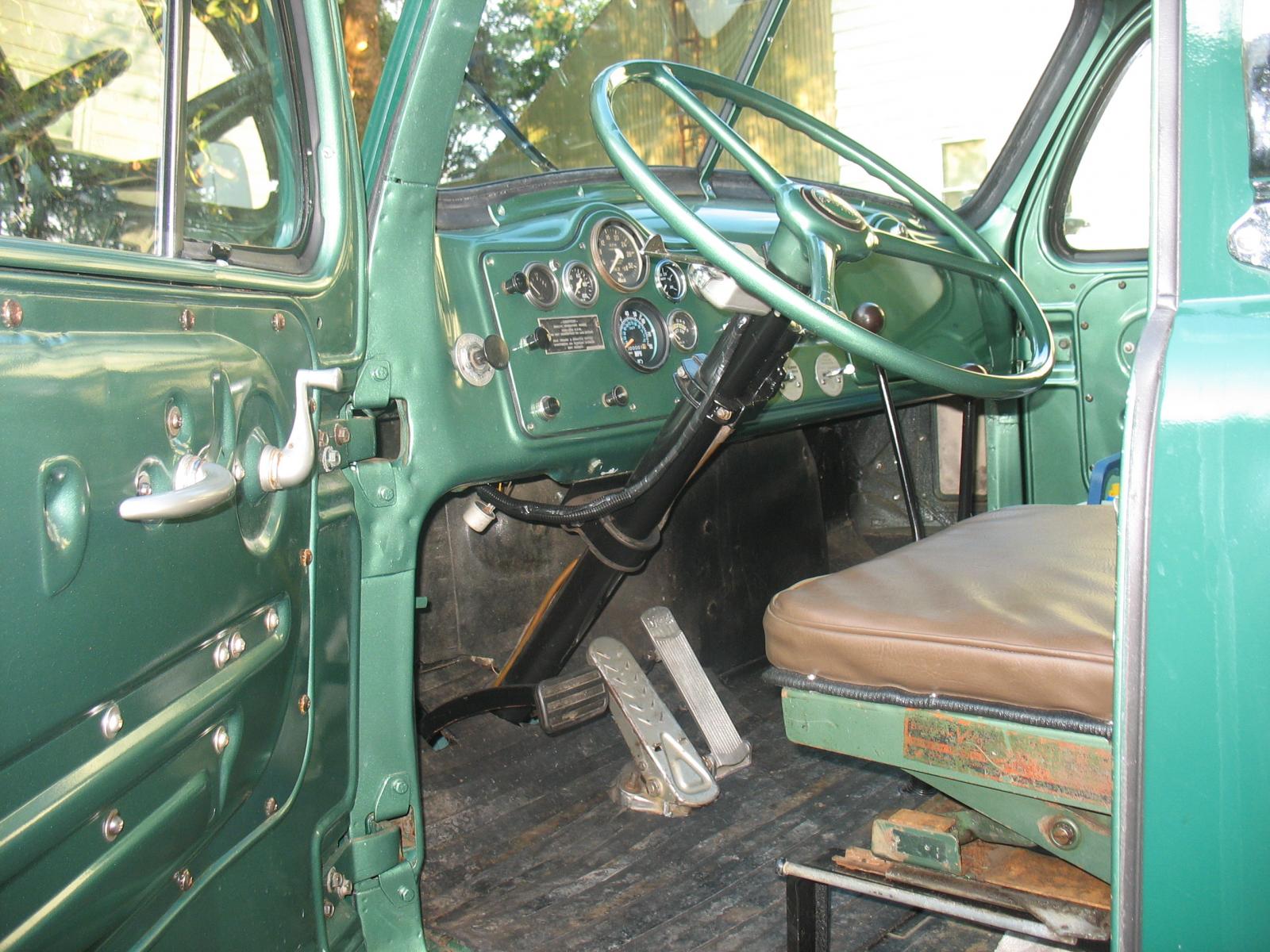

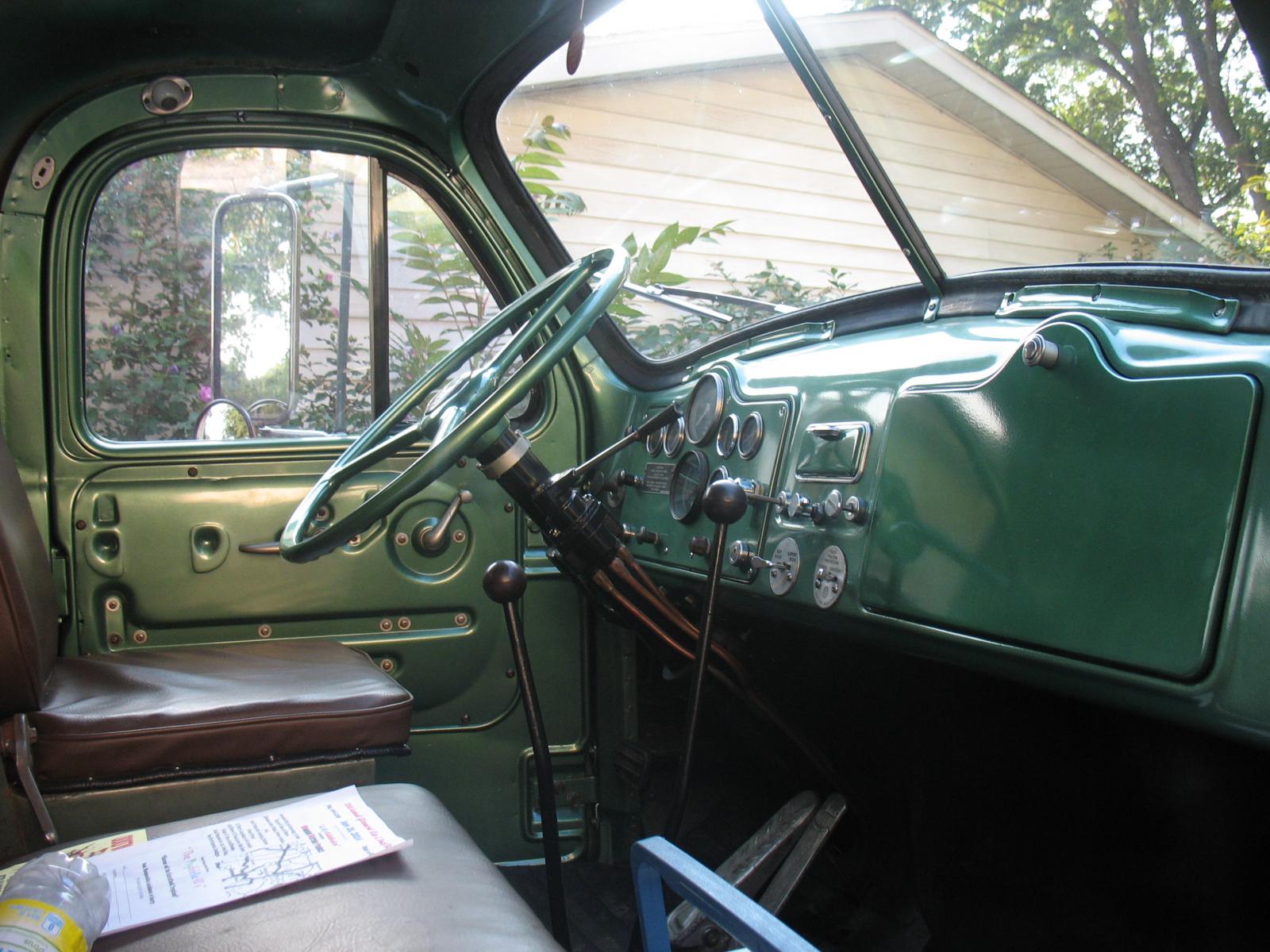

yes its a cut off switch and the seat is a Bostrom viking that came new with the truck according to the Mack build sheet..looking back I should have put the switch under the seat but It seemed like a good idea at the time....thanks Jim

I got a seat that looks the same from a parted out B Model several years ago. It needs to be cleaned up, painted and recovered. It should be a definate improvement over the standard bench seat. I'm not sure of the brand, I'll need to check. It's nice to have the battery cut off convientent. I put mine at the battery box and sometimes forget to turn it off along with the key switch. Next time in the garage the low air buzzer has been going for who knows how long.

Wow...the interior turned out great too! Nice work.
I have TWO bostrom seats in my truck. I really like them, rides fine for me and the g/f. Mine had recovered in a black tweet like cloth(pretty tough material), hers is still original black vinyl. I got about 5 or 6 seats from a friend that retired from Timkens. They go through them constantly in the straddle trucks(that haul the steel to the storage yards). I still have a few laying the back, not sure how complete they are. Broken brackets and such from wear/tear. Timken would just pitch them instead of repairing them.

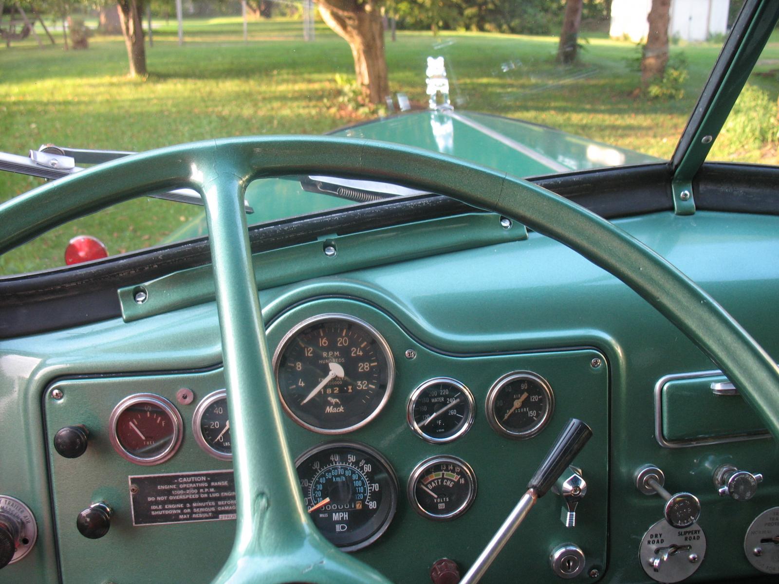

On the steering wheel I ground out the cracks and used PC-7 two part epoxy,sanded it down,used spray adhesive promoter ,primer then Mack interior green...Its not perfect and not sure how it will hold up but looks way better than before...Jim
