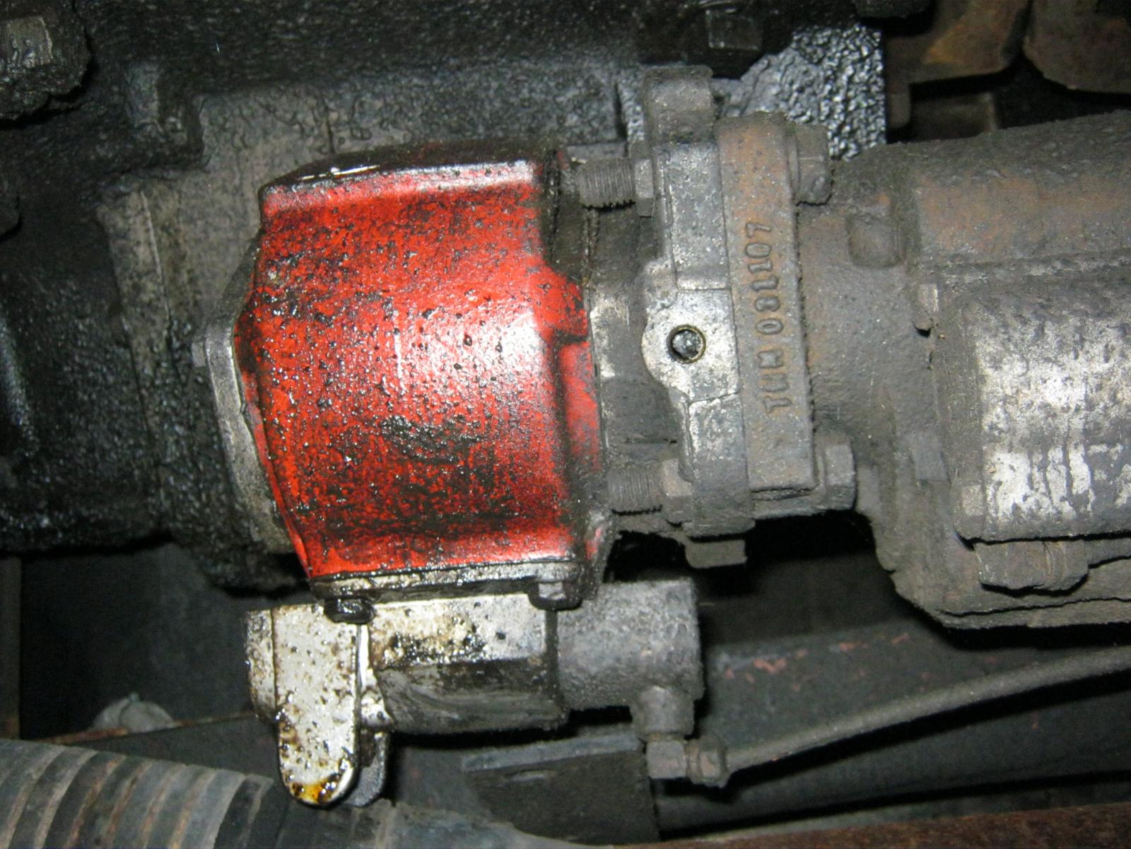

I have the cab side. I need the air shifter that goes on the pto itself. it is an actual Mack pto. the volvo guys st mack just stare at me when I tell them it's a mack pto.
Go ask em for parts for an E9 or a trtxl1070, they look at you like your a Martian. I like asking them then letting em freak out a minute then I give em a p/n and they can't believe it exists.

David, that is what I am trying to find.
https://www.bigmacktrucks.com/topic/32412-air-shift-pto/#findComment-201061
yes that's what I am looking for, yours hooks to the back of the transmission? I was talking with a guy the other day and he said he had one that bolted to the trans but was unsure of the gear if it would match.

The side mounts are ok for a wet line. The rear mount Mack PTO was designed for dump trucks where spreading was necessary. With the side mounts you must have the main stick in gear to run the pto and you can never get the speed of the truck to match the lift speed of the body for spreading. The rear mounts run without the stick in gear so you can choose any gear for spreading. They came in three ratios. Somewhere around 77, 99, and 124% of engine speed and were (are) expensive. About $2500 new and $1000 to $1500 used.
https://www.bigmacktrucks.com/topic/32412-air-shift-pto/#findComment-201484

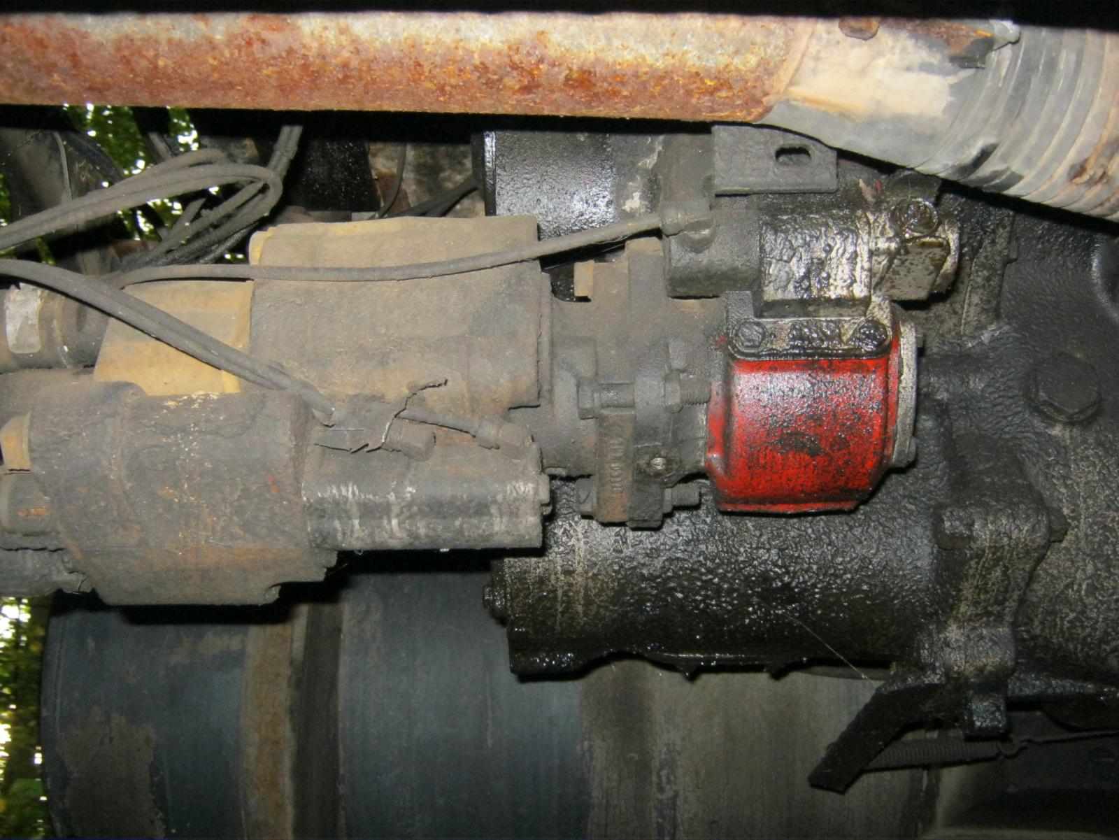

I have the mack rear mount pto for my 6 speed...The Mack pto part numbers were in some of the service books that mack made for the service dept. it had info for everything from orings to internal parts ....
IMHO the rear mount is the only way to go on the 6 speed or 12 speed... The rd I drive now has a side mount and it sucks...too much bs to operate for what it should be...

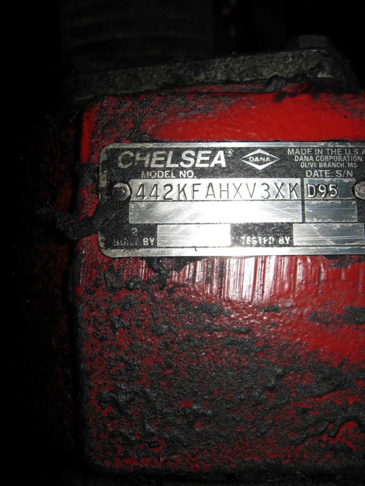

THERE WERE 2 DIFFERENT AIR SHIFT SETUPS DEPENDING IF YOU HAD THE SMALL 51% PTO OR THE LARGER 75 OR 90 % PTOS. I BELEIVE MOST OF THE PARTS ARE STLL AVAILABLE, JUST NEED TO KNOW WHAT PTO YOU HAVE. THERE SHOULD BE A CASTING NUMBER ON THE MAIN PTO HOUSING
