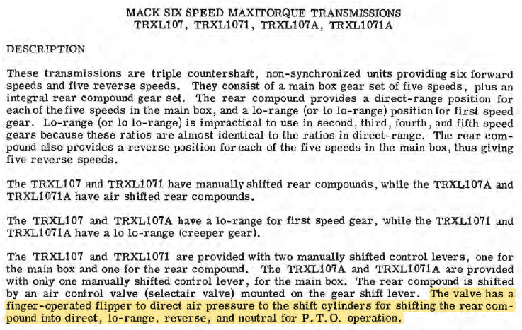

Not sure which trans the OP has, but here is some verbiage from a service manual that talks about air-shifted aux versions...
This particular group works like the one I remember using...neutral on the rear box for PTO.  But, again, this may not be the right group for the OP.
