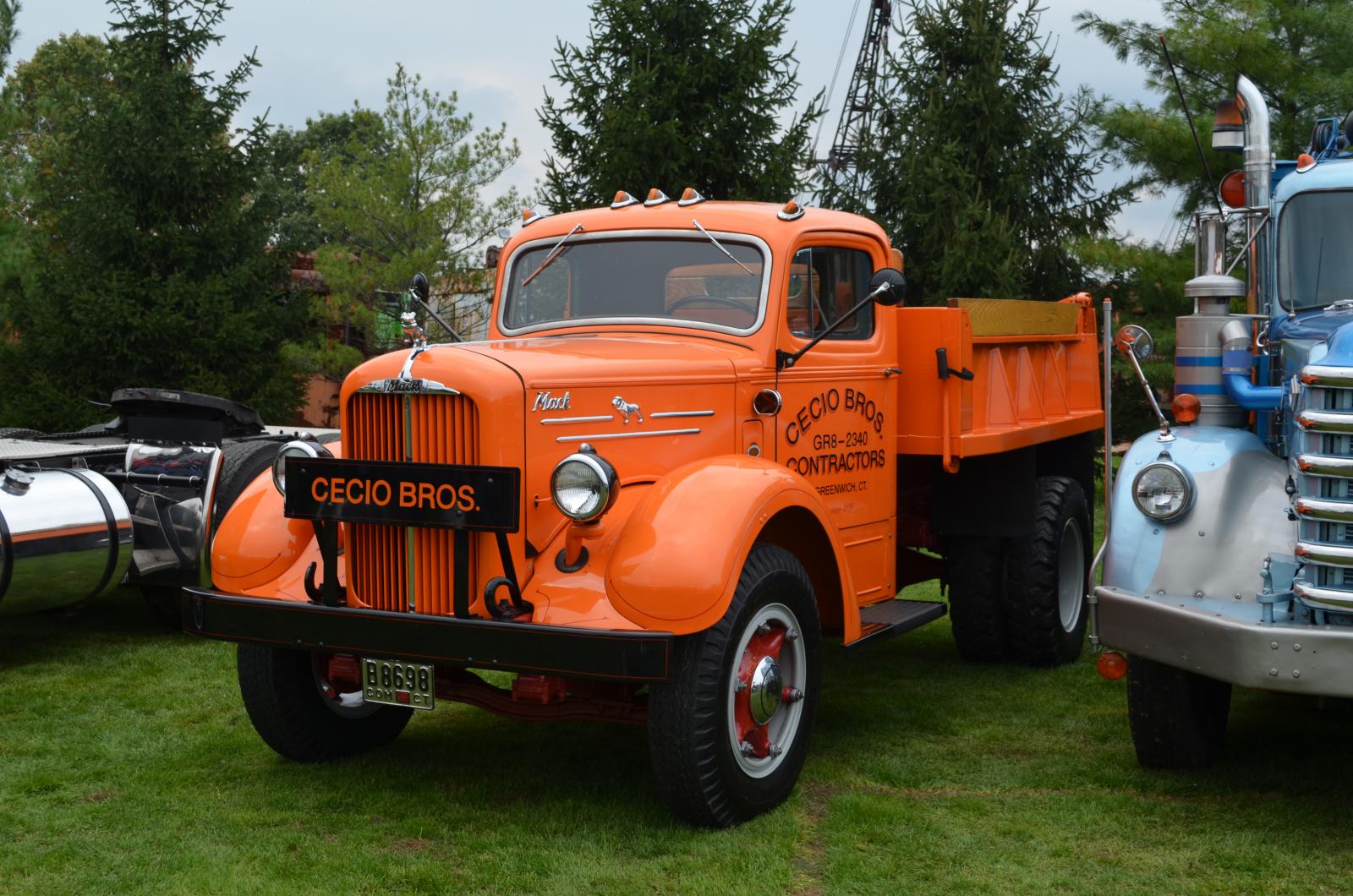

"A" model on the left with long cowl.
"DE" which is an "E" model on the right with short cowl.

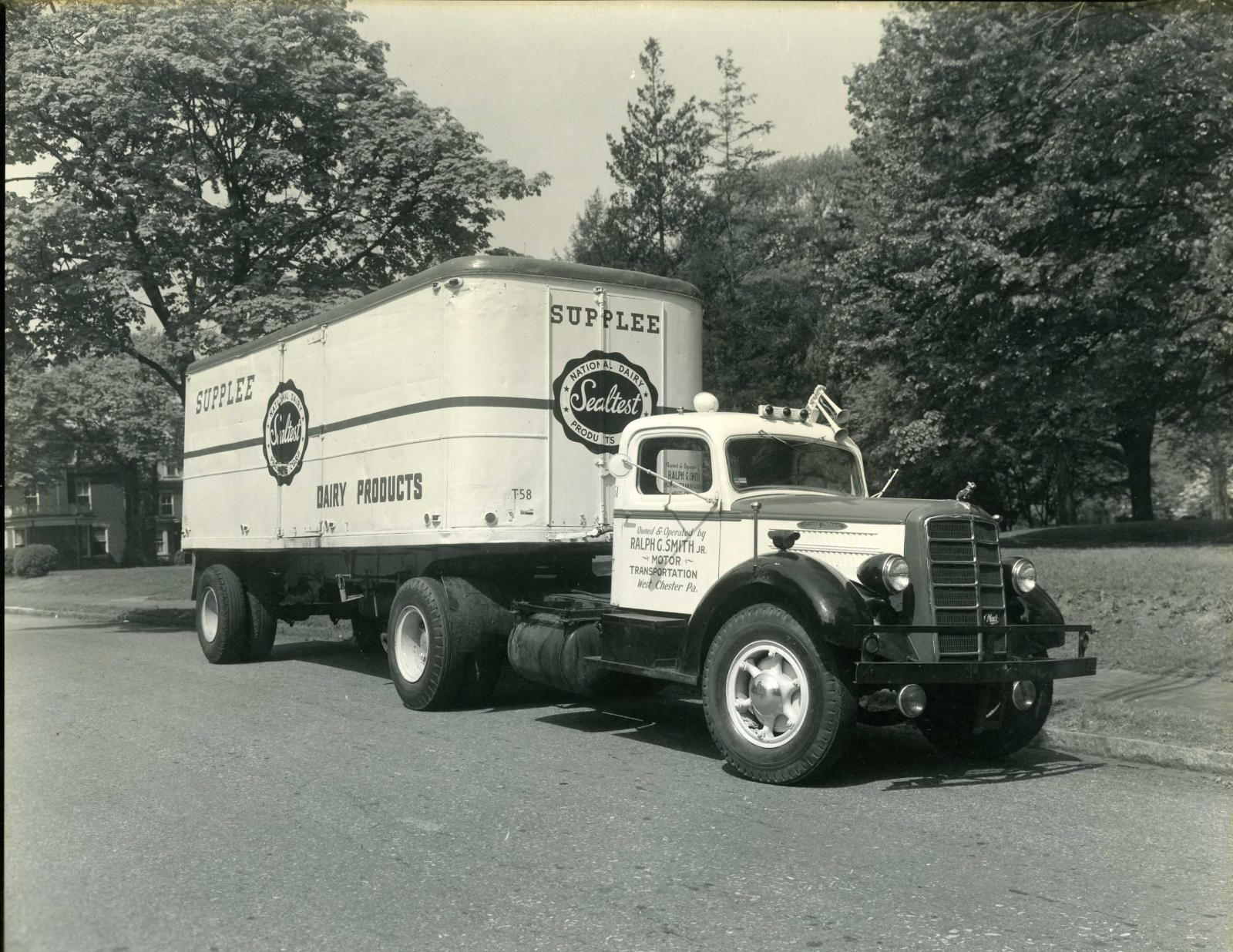

This is a picture of a larger "E" model.
Pretty sure it's an "EH"
This has the longer cowl on it, notice that the upper and lower belt rail ribs end in the cowl and don't extend into the hood.
Notice how wide the cowl is.
