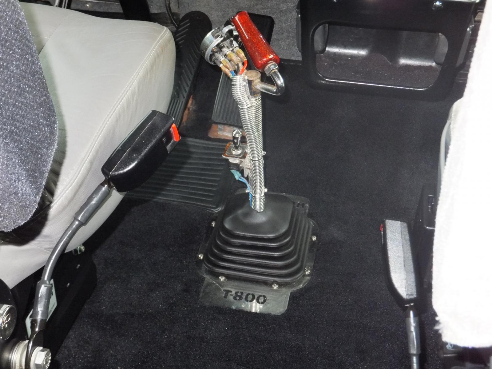

Looks good! I like the high low range valves on the stick not in the knob well all mine have been 10spds but none the less to me its easier to do your pre selects just slide your hand down and pull or roll your hand to hit the knob into low side. Well and i like mine on the side at about the 2 oclock position. plus they look better than the all in one knobs

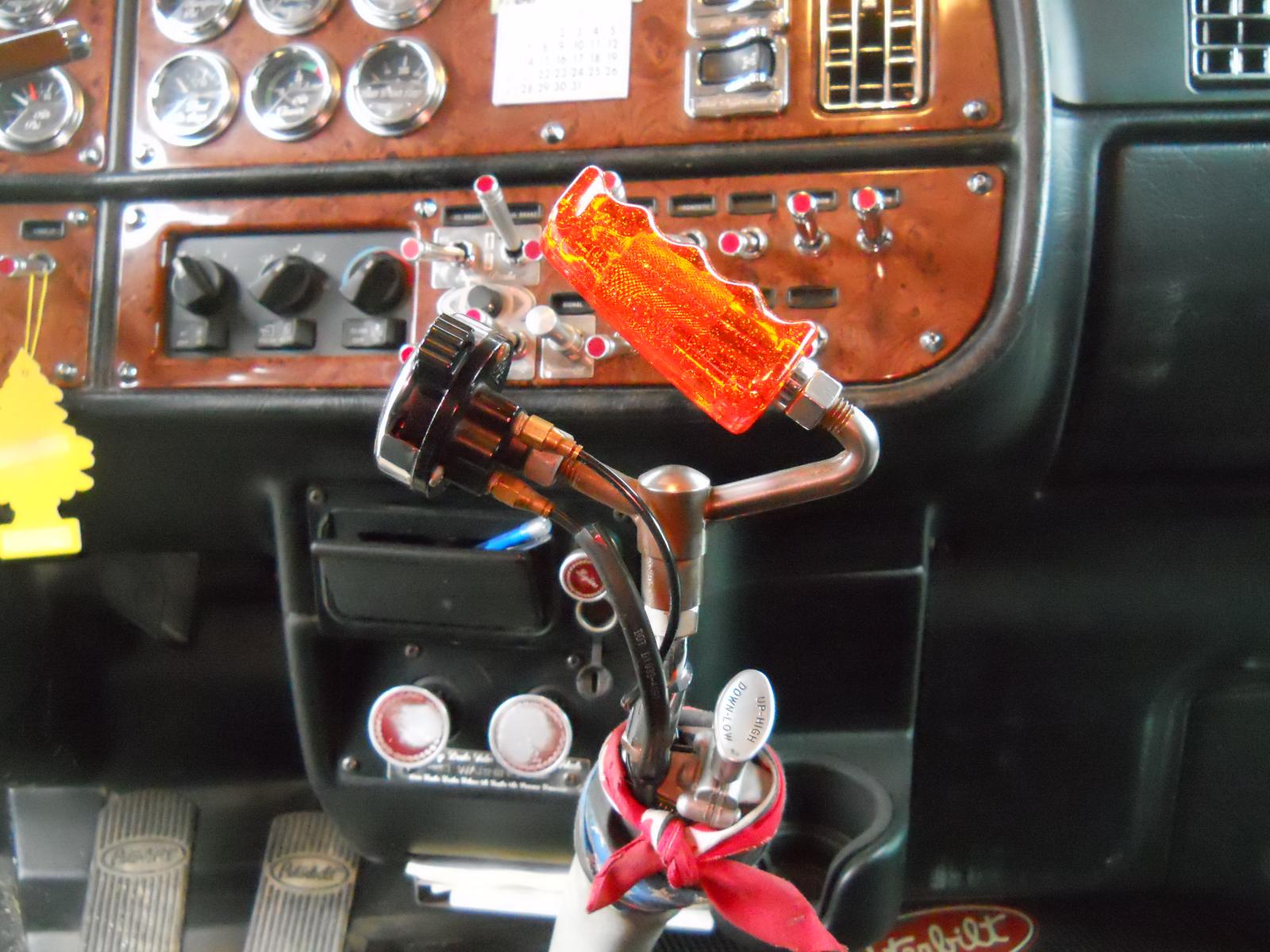

On 8/24/2013 at 11:24 AM, 55deere70 said:
Old school shifter in my 05 Pete
post-15567-0-78226500-1377357812_thumb.j
