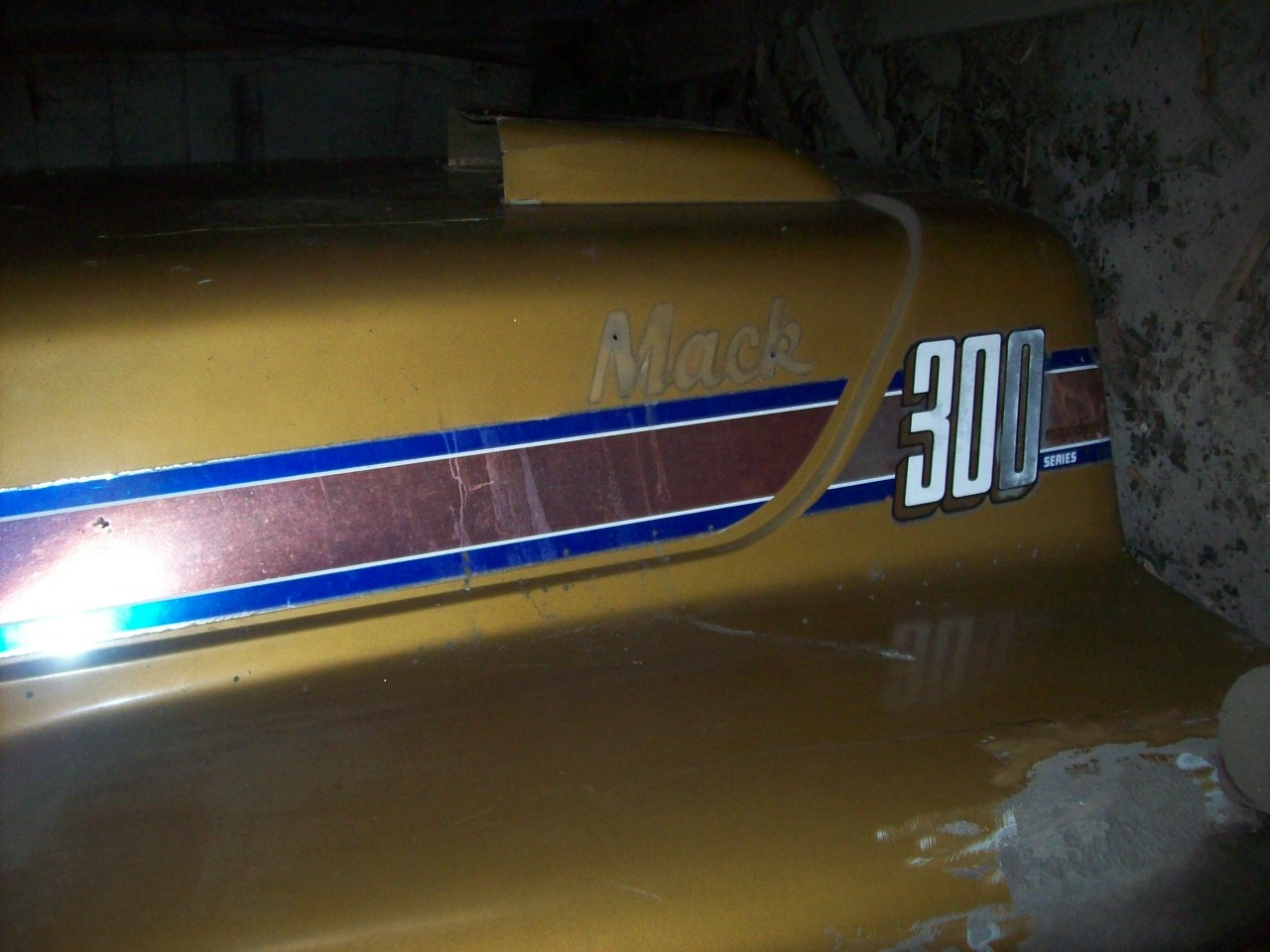

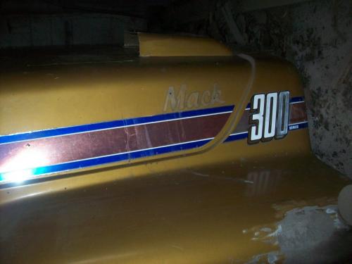

Every Mack distributor received one "R" and one "F" cool power 300 tractor with the limited edition gold paint scheme imagined by Mack President Zenon C.R. Hansen.
Note the white-painted roofs to reduce interior cab temperature during warm weather.

Any production numbers on these promotional units? I've seen 1 F model and maybe 3-4 R models. There was an O/O on Long Island that had an R-600 leased to Island Transportation pulling a fuel tanker. The first R model I saw was pulling for Quinn Truck Lines (not the northeast freight hauler) out of Ontario, Canada and I am almost certain it was an R-700.
Jim
yea the RL600S we bought from the junkyard had a 300+ and R1110 tranny in it. some hacked off the rears and put a pete single axle in it made It a dumptruck. we got there just in time cause it is a rebuilt pedigreed engine and was on its way to china. got it for a grand, engine and tranny and made new mounts to put in in my 66 R model. gonna add the hood scoop someday as soon as I figure out how to mount the tubin under the hood to the old style radiator. for now it has the ugly newer style air cleaner with dual inlets. that's as far as we got as id like a set of air ride tandem rears for it with 22'' spokes. think id get away with 4.17's on 22'' spokes with the direct 10 speed Mike or think I should look for a faster set of rears?
